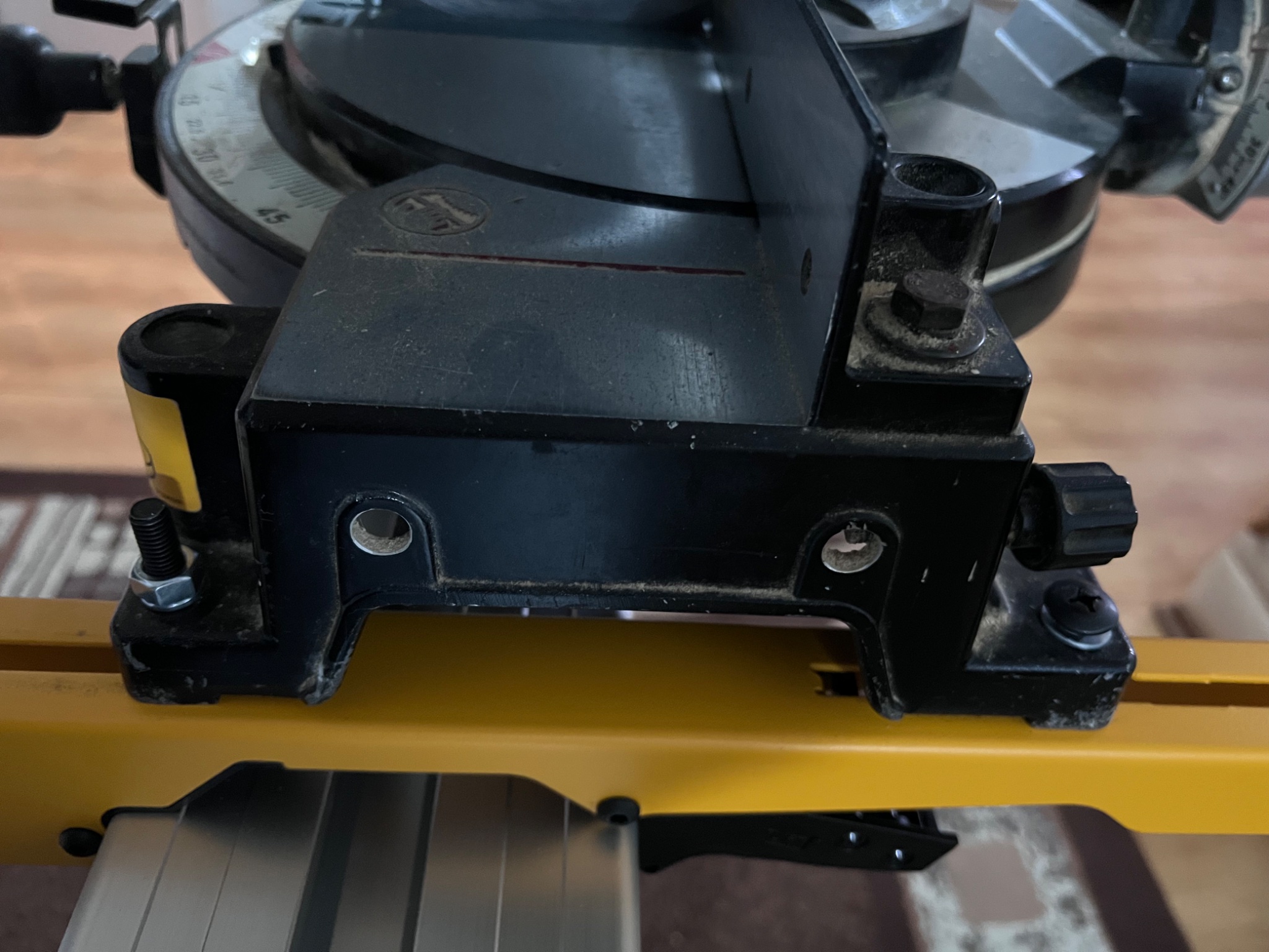

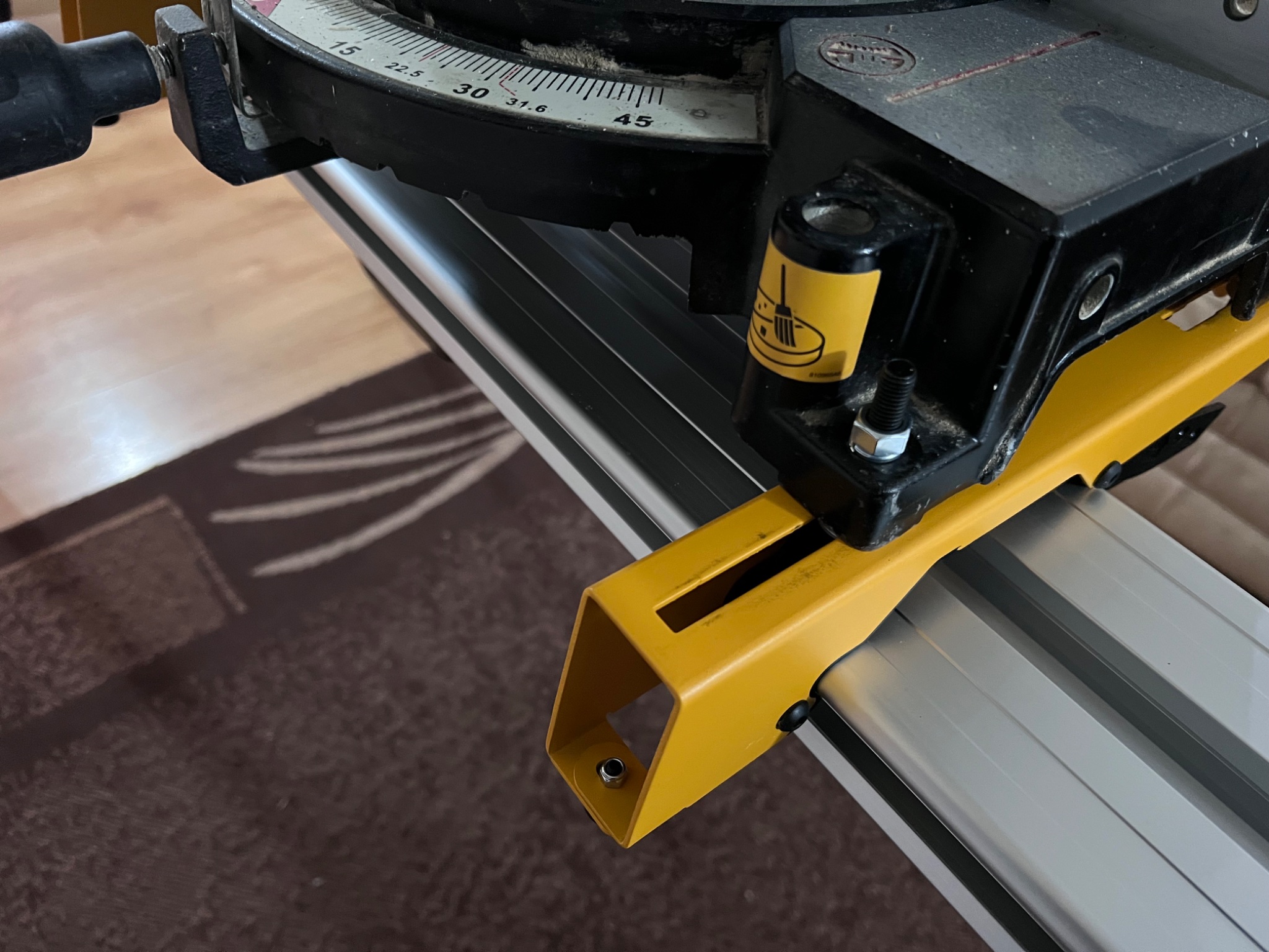

I’ve just brought a dewalt stand and the instructions on how to connect the feet to the saw are not very clear.
I’ve had to put the front bolts like this:
Else they interfere with the lifting off action.
The back ones have gone in normally, but I’ve had to slide the saw slightly back. Else he back bolts interfere with the lift off mechanism.
I am using a flat washer on the bolt side and then a locking washer and nut on the other end.
Can you please advise.

you really want the saw table bed to be more central as in forward perhaps 50mm/2" to 100mm/4"so when you push a bit off timber onto the fence its more stable
my fence on my dw712 lines up with the beam back egde
i fitted my dewalt saw to the clamps perhaps 15 to 18 years ago i vaigly remember something about short and long bolts being mentioned the bolts on mines all go up with nuts on top as designed as the slot holds the square on the head then they fully miss the clamp handles
remember you can loosly screw the nuts on then slide along the slot into position before tightening if they are top fitted nuts

If I do push it all the way to the front and even when I use the bolts the other way around (nut on top), it interferes with the clamp mechanism. That's why I have pushed it back until the back bolts no longer interfere with the clamps.
Just looked mines is fully forward on the front slot
I would look at cutting the bolt down and no more than a thin washer or no washer at all iff space is tight
I have just looked at the picture and unless I am having brain fog the saw positioning on the slot will make zero difference as its the hole in the base dictating the bolt position to the saw control knob

The length of the bolt is not an issue as that will be poking upwards. It's the head that catches on the lever. I am using a washer in that end. Wil remove that and try again.
