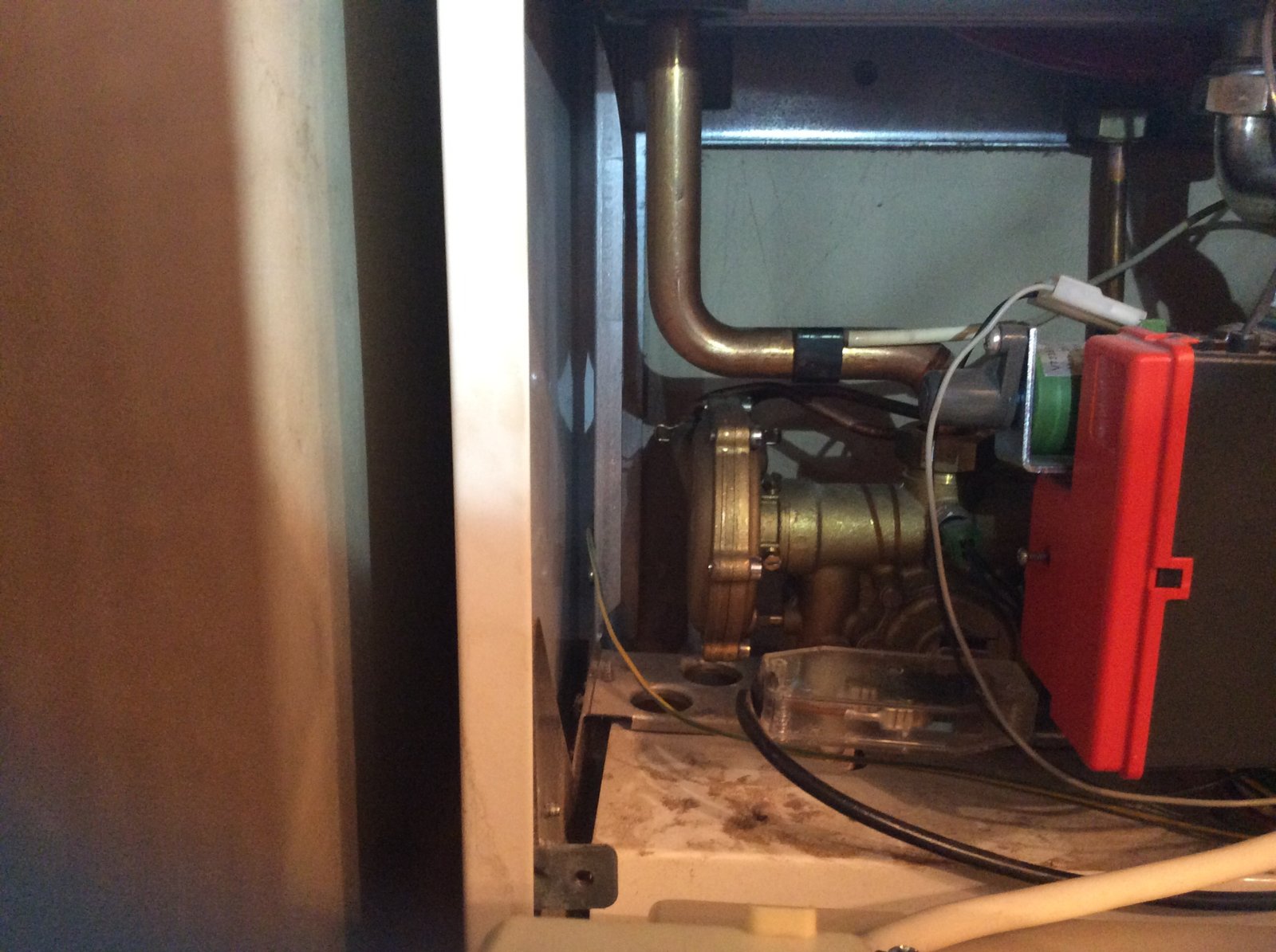

Diaphragm replacement on biasi 24s
Yes that's the one pull that clip off which will leave the switch hanging connected , turn your boiler on with tap running and stick a screwdriver in the hole in the plastic box and tell me what the boiler does

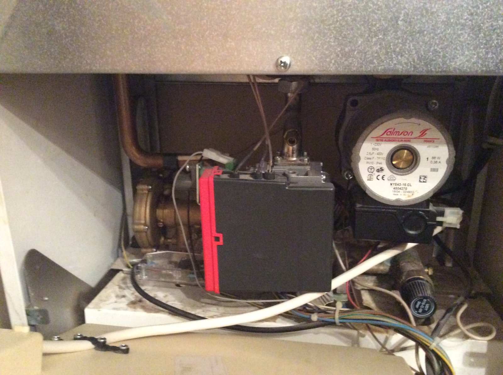

They say a picture says a thousand words so that is what my boiler looks like
Can we continue this tomorrow night as I feel I’m getting somewhere now ?
Just took micro switch off turned on hot tap , pushed screwdriver into switch and nothing ? So could this be the fault ?
Yes that’s the one , I’ve downloaded the same one when I first noticed the problem
