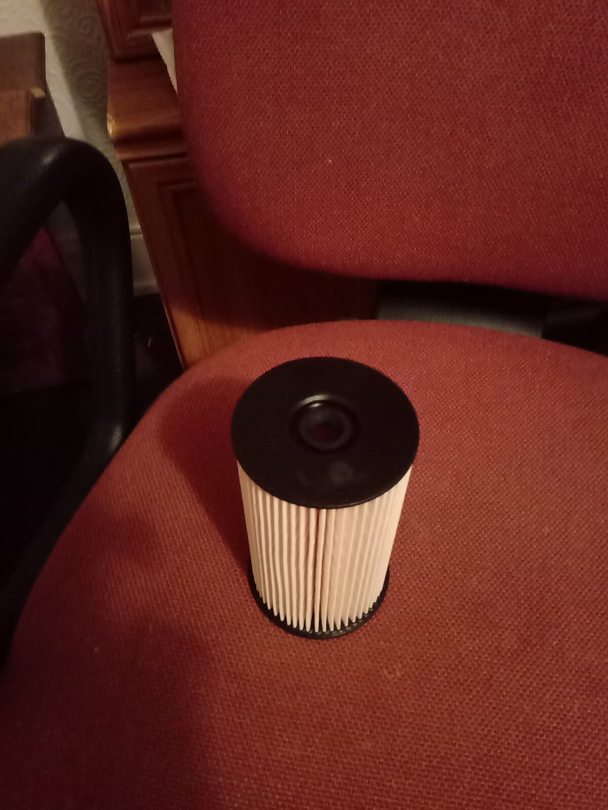

Picture attached i think.
I noticed the auto doc video didn't add any fuel.

If it’s like our Golf, I’m pretty sure the top comes off and a paper element goes in. I just then fill the bowl with diesel, pop the top back on, reconnect the pipes and that’s it.
Like this.
I think yours may have the bigger rubber flange on the top of the filter, Mottie?
Either way, filling the container with fuel is the way to go, although the engine will do it for you if there’s enough juice in the battery ......on the 1.6 CR engine it takes 12 sec :(
John :)
I’m pretty sure when I do mine, I remove the hoses and mount the filter onto the head unit before filling the canister with fuel and refitting.
On mine, its pipes off, torx screws out and cap off, filter out, pump out fuel residue, new filter in, fill slowly from the top, cap on and screws, pipes on and away we go.
John :)
Edit - it's not always necessary to remove the pipes from the top.....if it can be swung out of the way it reduces any chance of leakage from those horrible sprung clips.
