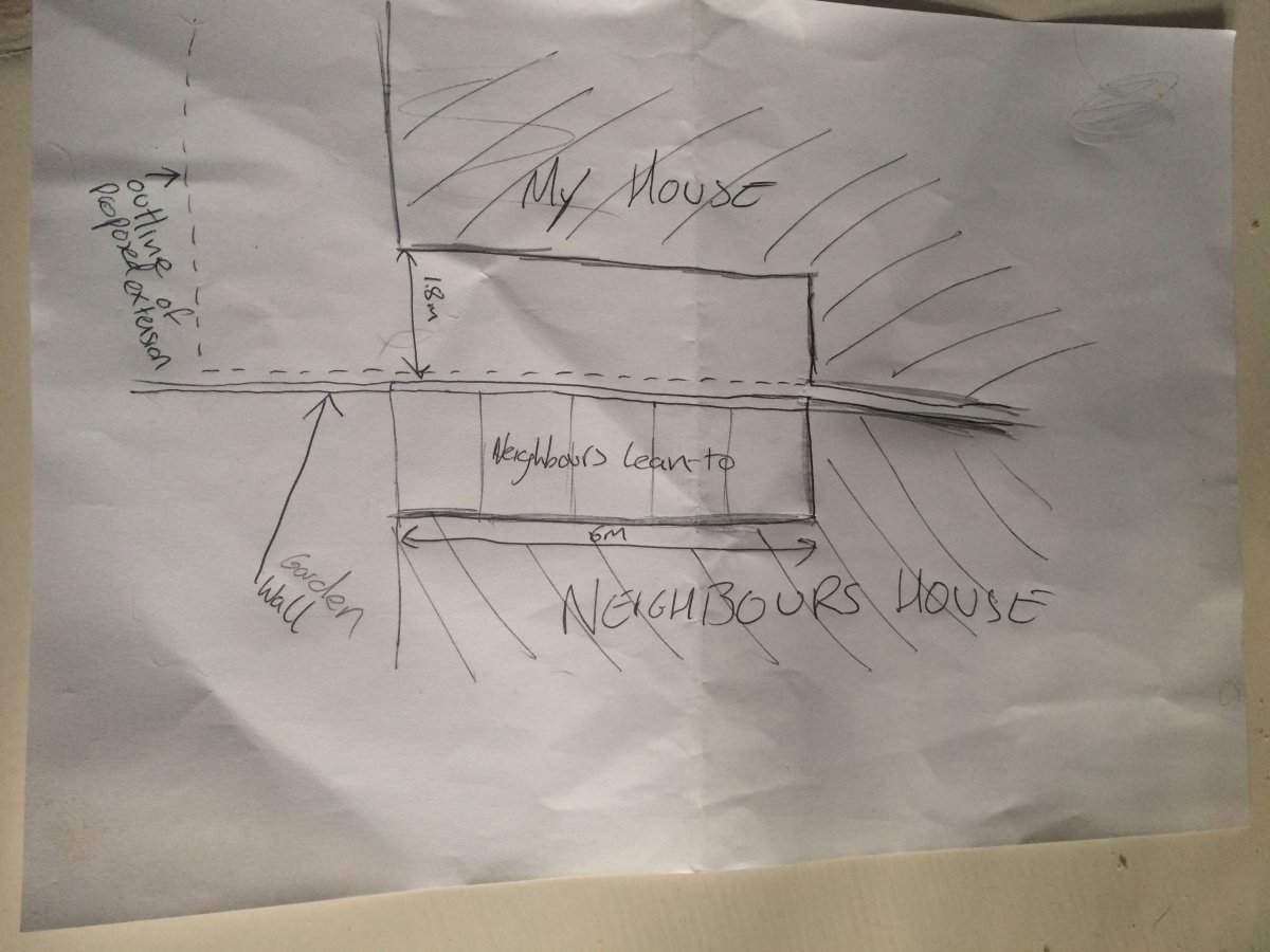

I plan to put a single storey extension in, down the side of my house, with the wall being as close as it can be to the boundary to maximise the internal size.
The boundary is effectively a 3ft high garden wall, I haven't dug a trial pit but i'd be amazed if there was more than a foot of footings. Now this is not too bad, except sometime in the past someone clearly thought it would be OK to build a lean-to (my neighbours) on top of this garden wall. It's all lightweight. Rotten timber and a polycarbonate roof.
I spoke to my neighbour on the other side, who has put an extension in recently and he said his footings kept collapsing as the soil was loose.
So I guess my fear is digging along this wall, and it sliding into my footings.
I have not really come across this before, I vaguely remember once using a digger to drive plates into the soil between a nearby house and footing, but in my case here, I wouldn't have the room and if I did, they would have to be pretty deep as i'd be excavating next to them.
The wall in question is about 6m long.
Has anyone any advice please? I haven't gone through building control yet and aware of the PWA notice that needs serving, but I am currently planning this and this is really bugging me.
The solutions I thought of, were shuttering the sides as I dig it (by hand I guess) with OSB and bracing across the footing to the other side. Then pulling the braces out whilst pouring. I.e. dig 600mm worth of the footing (I guess it will be 600 wide and then 1m deep) brace it, then dig the next 600mm etc. Its fairly lightweight, single skin wall etc, so wouldn't require too much.

How long is the proposed section of wall on this elevation?

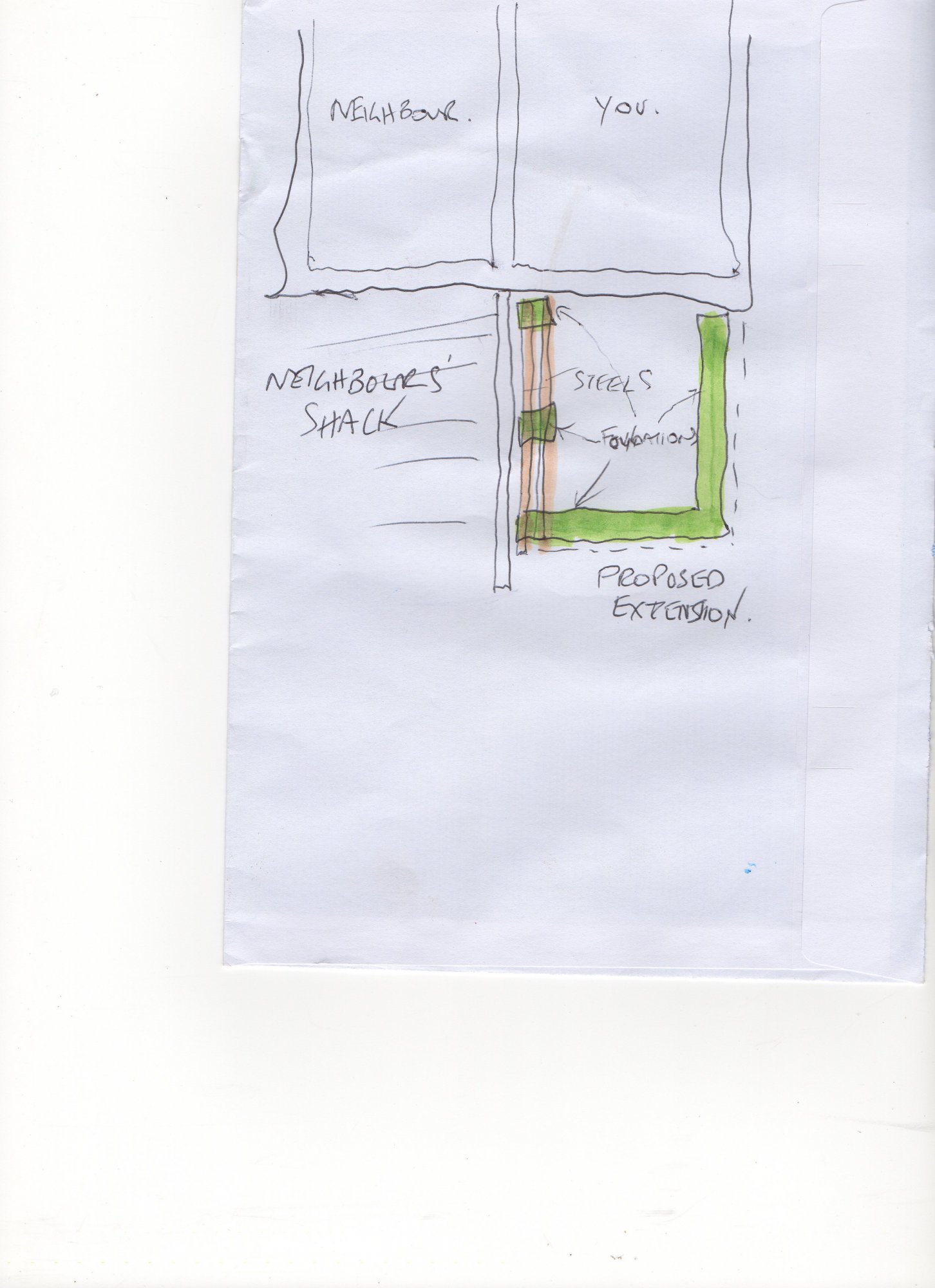

I was kinda thinking that you could have three points of support (foundation pads) for a pair of steel beams (to support your wall), i.e. one abutting the house, one on the return foundation and one in the middle. Sounds convoluted but it may work. Have you spoke to the neighbour?
As I see it, you mark out your 600 X 600 section then go down 1m, with shoring to hold his foundations and soil back. Then you pour your 300mm slab section somehow pulling the shoring out as you go, but you still have to support 700mm of his foundations and soil?. Or you fill the hole to the soil level, which is a lot of concrete! Another point is that the garden wall might have a spread foundation, so three courses under the soil step out to 18", which will make your digging awkward. Yet another point if you manage to shore up the soil and support the wall foundations and build of your own foundations, you will have to fill the gap between your wall and the soil, else it will fall out into the gap and the garden wall will lean over towards you.
I am wondering rather then all mucking about, if you just bracket his woodwork of your house wall and remove that section of the garden wall, it depends what he has done on his side of it, and finally bracket his woodwork back to your new side wall and paint the bottom of it white or screw back his paneling if required.

Cheers woody, somehow I didn't see that haha. The corrugated steel was what I was on about. But I would have to go quite deep with that. You can see from my pic that I'm limited with room so very keen to go as close as I can. Really just for a toilet and small utility room.
Yes theprinceofdarkness, sort of what I mean. I was thinking of doing the whole 6m trench, pouring it and using the hydraulic pressure of the concrete to hold in in place. Although very much doubt I'd get the osb out from his side of the footing.

Agh noseall. Apologies I thought you were talking crap! I'm really sorry. I get it now! That's a good idea!!!
How do you finish under the steel? I was aiming for a suspended floor.
