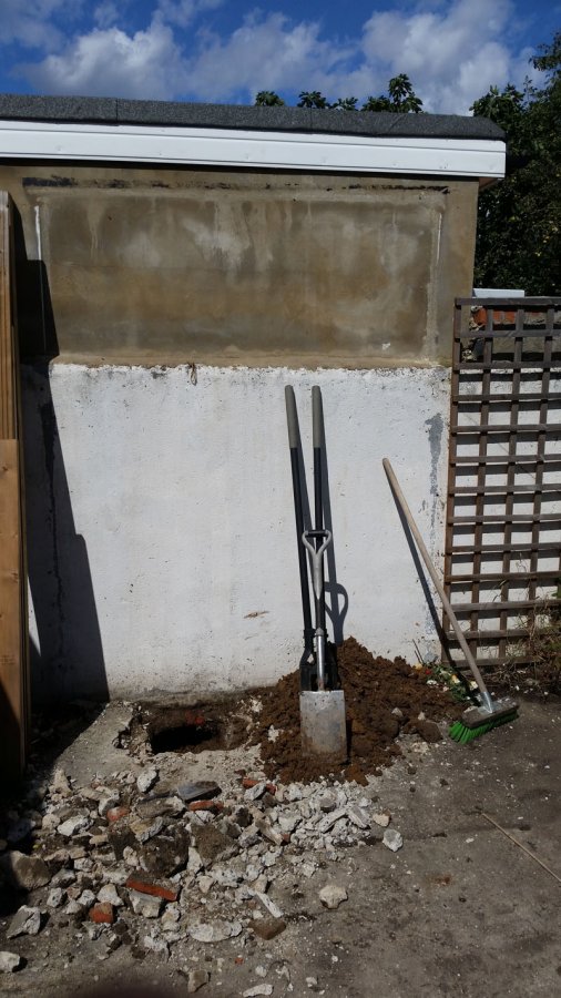

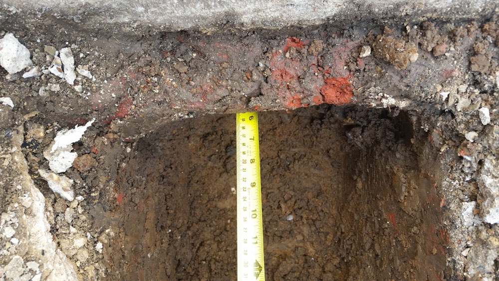

The neighbours four year old extension starts on top of our shared (probably Victorian) garden wall. I've been digging a hole to see how far down it goes down / whether they underpinned it at all and... there's nothing there. It stops one course below ground level.
I'm supposed to be building an extension up against theirs so this is a problem isn't it? Anyone got any suggestions as to what to do about it/how big a problem? Pictures attached...

You already know this but there's a chance that digging your new foundation next to that will cause some movement, although how much and if any is impossible to predict. If it were me I would point out to your neighbour that their botch job has put you at a disadvantage (maybe choose some different wording) and the only safe option is to underpin. Really they should bear the cost but you might get an easier ride if you ask them to contribute rather than cough up the lot. See what they say. They might not even know about it and might be so grateful that you go straight to the top of the Christmas list and offer you a bottle of shampoo as compensation. You never know.
On the other hand they might say; so what, not causing us a problem, we're happy with it as it is, goodbye. That being the case, if the soil is reasonably cohesive I'd dig and fill as quick as possible (same day) and make sure the fill is at least above the bottom of that lowest brick. That shouldn't cause any more movement than they might get anyway and will probably improve their chance of movement in the future anyway.
PS. Somebody might say party wall act. I wouldn't bother myself - they didn't. Have a holiday instead.
Their choice or standard of construction methods is bluntly, none of your concern, and it does not affect the fact that you have a strict duty to provide support for their structure from your land.
They certainly are not obligated to underpin, or pay anything towards you underpinning it to suit your own extension build.
Use some sacrificial corregated steel sheets pushed in either before digging the trench, or as part of a bay excavation.

You can "underpin" the wall for the cost of the concrete. Dig out a section 9" wide and 2' deep, tunnel under the wall. Fill hole with concrete, do another remote section the next day. repeat until wall is sitting on concrete blocks.

it looks to me like the neighbour is resting a shed or conservatory roof on top of the garden wall.
With no foundations, I presume no building regs or planning permission. He's lucky it hasn't fallen down already. Perhaps he poured a slab.
If it was me, I would dig a trench for my own foundation, but dig and pour it in bays, and if it happens to support the neighbour, good luck to him. Certainly replace any disturbed soil with concrete.

I might consider putting sacrificial shuttering between your own foundation, and the backfill under his. Then, when his extension falls down, they can build a new one without disturbing yours. You could still pour the bays, both sides of the shuttering, at the same time.
What do you reckon the BCO's likely to suggest?
Also: I stuck a crowbar in till it hit something solid. 30cm from the rendered face of the wall. I guess they cut a trench and filled that side then?
John's idea of bays is a good solution. You can happily take out 700 or 800mm bays without causing any significant movement. Don't use anything sacrificial between your concrete and the soil though. All that will do is create space for the soil to move and settle.
BCO had a nose and said 'dig it in bays and fill with concrete' so top marks there John!
Raises a question about detailing though - the concrete fill will have to come basically up to ground level to properly support the wall won't it? But there's supposed to be a layer of hardcore, sand, DPM and slab over the trenchfill - can the slab basically be built right on top of or even alongside this concrete support? Not sure if that explains it all that well - maybe I need a diagram?
poured concrete will settle somewhat, so to support and underpin the wall you can leave a gap, and fill it later with bricks and rammed mortar. Otherwise the concrete will shrink away out of contact with the bottom of the wall. You might need a jetwasher or something to get the soil off the bottom of the wall.
I do like the idea of the neighbour's wall standing on its own foundation so that your house will not be affected if/when they demolish and rebuild. A few courses of brickwork on the strip might achieve that.
If its a standard lean to extension then there is not going to be much loading on the garden wall but you still need to take care while digging, Noseall's idea seems the easy'est solution to me.
