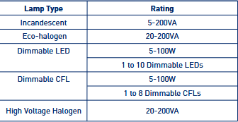

I have a dimmer switch in the bedroom and up until recently, all was well.
The light bulb stopped working and as I had a candle bulb spare, I fitted this and all was well, although the maximum brightness is far too low.
Today I bought two dimmable bulbs but they didn't work .. no light at all
I put back the candle light, and as before this works fine, just it's too dim.
What's going on ?

I find many of the dimming switches confusing, as many say something like 30–400 watt, but when one reads the advert is says 5 watt lower limit for LED, so reading the details on the switch does not help.
Also, LED bulbs often have a large wattage written on the package, but reading the small print, one realises the real wattage is a lot lower. And it seems the manufacturers don't know what they are talking about
