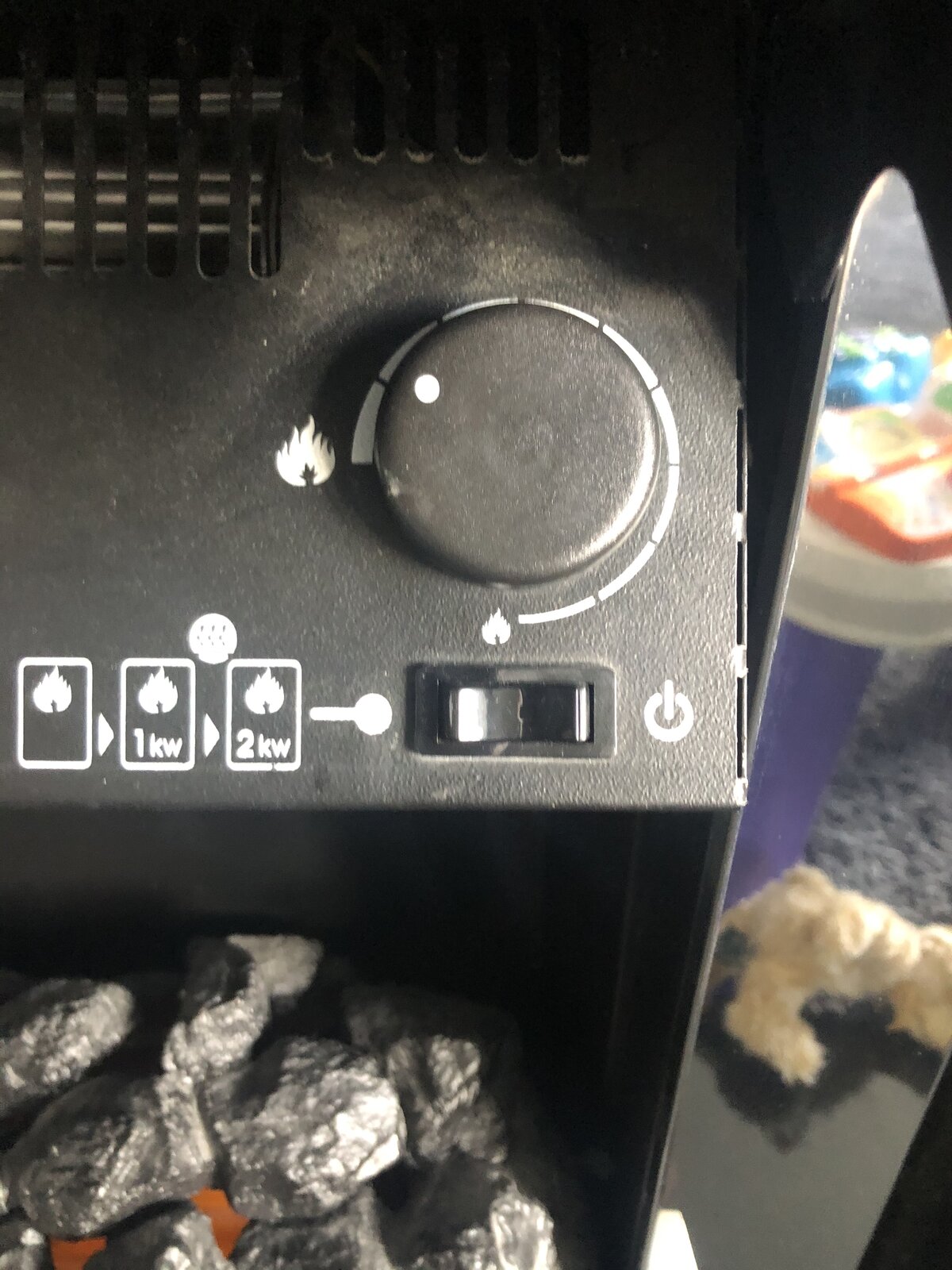

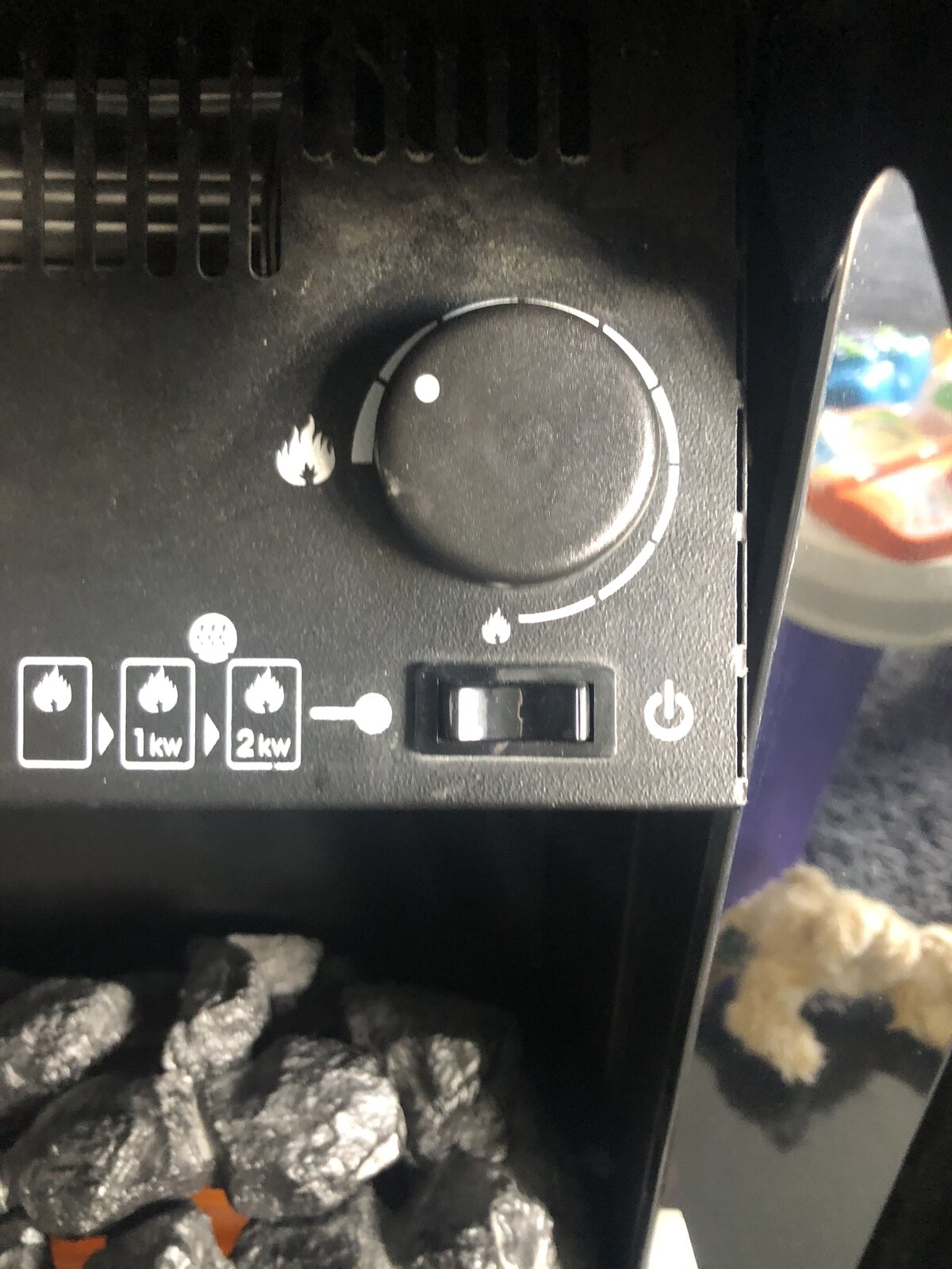

It would appear my young lad has turned this dial to the point where it no longer works. He’s overturned it and would appear he’s snapped the switch inside which triggers it on. Anyone know if it can be fixed or would be looking at a full unit

Its a potentiometer behind the black dial, shouldn't be an expensive part to replace, but it involves removing parts of the fire, so you'd need to be competent with electronics really and be careful, always remove the mains power before starting.
