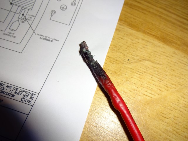

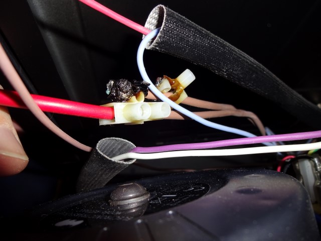

I have a CGN20 stove type Opti-myst which has now stopped working. About 2 weeks ago it started to emit a strange smell, something like damp clothes or a swimming pool not what I would say was a burnt component type smell. Any way I cleaned the sump and this seemed to reduce the smell and the fire worked fine. Then the halogen lamps became intermittent sometimes they would all start when the fire was turned on but on other occasions nothing came on. Now the fault with the lamps is permanent and nothing happens when the fire is powered.
Tried cleaning the ultrasonic transducer but the failure mode is the same. Tested the water level sensor and that works fine with the fire beeping when the water level is low.
Have ordered a replacement transducer but unclear is this is the issue as unsure if there is any feedback to the main control board that the sump unit is working or not.
Yet to look at the lamp connections but cant believe all the holders have failed together but will investigate further.
Interested to know if others can point me in a more likely direction as to the cause of the fault.
Well after several false starts thinking it was a lower sump fault had a poke around the main control board although nothing stood out as the fault. Then decided to isolate the output side of the transformer to check that it was not a short on the output and to my surprise the entire wire came free when I removed it from the connector block.
Having removed the entire back of the fire you will find a standard plastic connector block one side of which was completely destroyed. Replacing the wire and the connector restored the lamp supply but after approx 2 mins the fire again shut down. Suspected this was the sump not starting the ultrasonic disc, so did some more impedance checking on the ceramic disc. Found I had incorrectly assembled it after I had removed it from the rubber seal which resulted in a short on the device.
To correctly assemble the item it is necessary to de-solder the screen can, remove the outer metal connector ring and then mate it with disc so that it makes contact with the two parts held together by the internal recess of the rubber O ring. Not an easy item to assemble!
Fire now fully works resulting in a massive saving as was minutes away from ordering a new one.
PS Dont bother phoning Dimplex at the moment as they are not offering repairs on fires which are out of warranty.

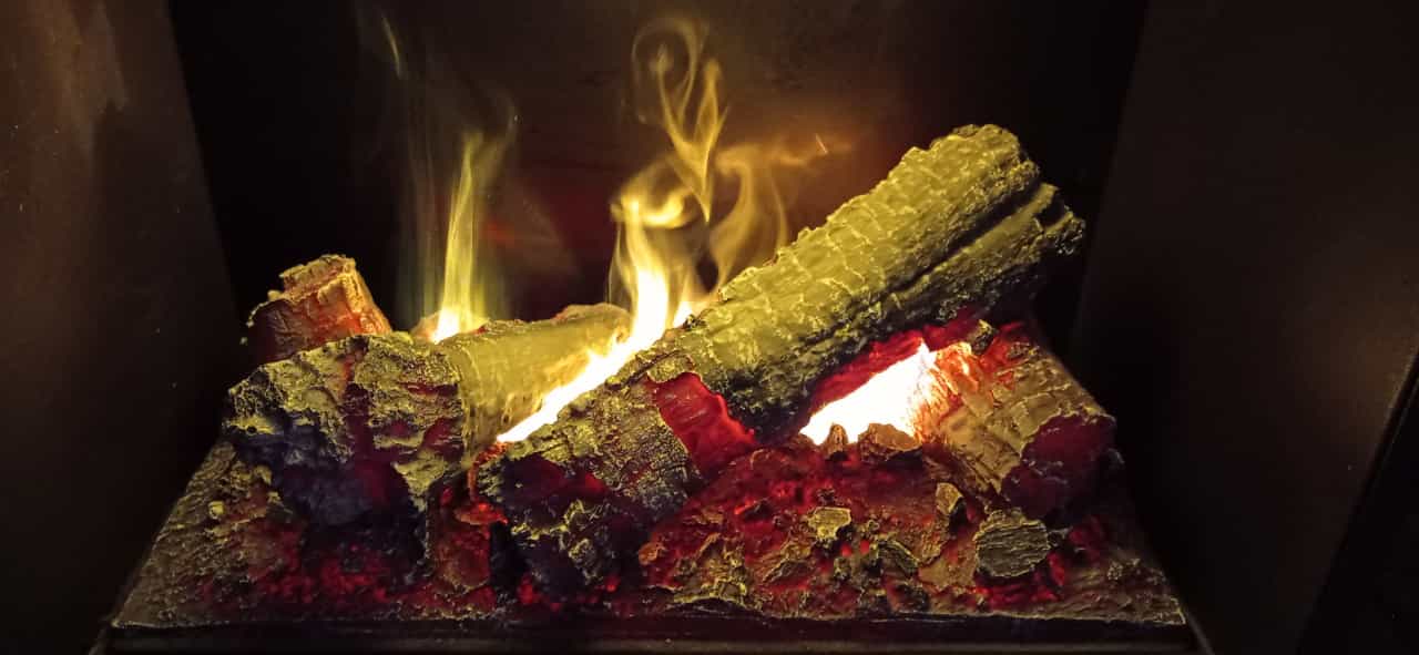

Photo is my Gosford fire with the 4 lamps having been replaced. Saving some electric too 4x 16watt = 64 watts versus 4x 50watt (original lamps) = 200watts !
