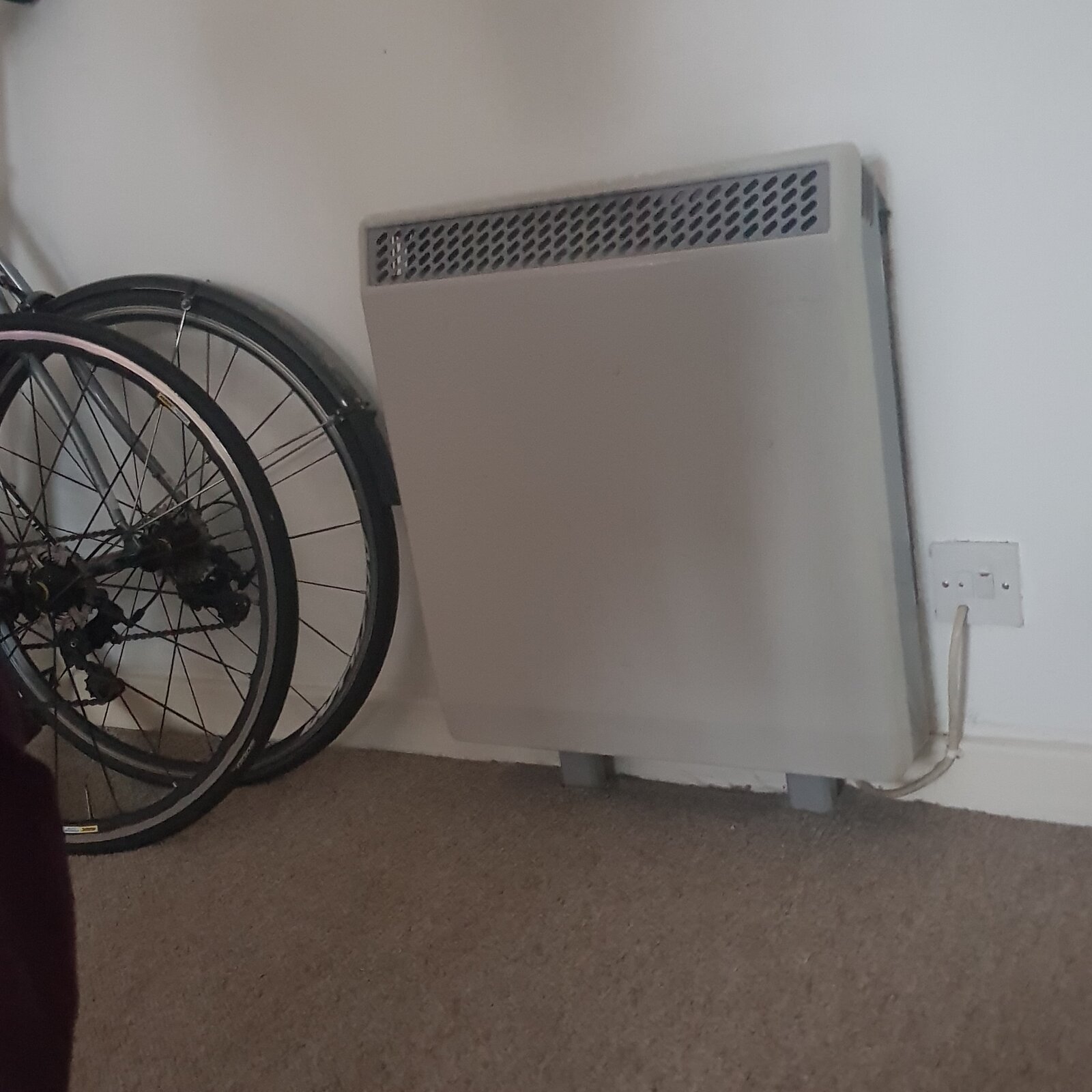

DIMPLEX XLS Wattage ?
Sorry, XLS12N is now discontinued - XLE070 would be the current model.
It will however need a permanent supply, as well as the off-peak one. New rules, heaters must have timer control now.
They are however much better, they retain the heat way longer so less gets wasted from leaking out.

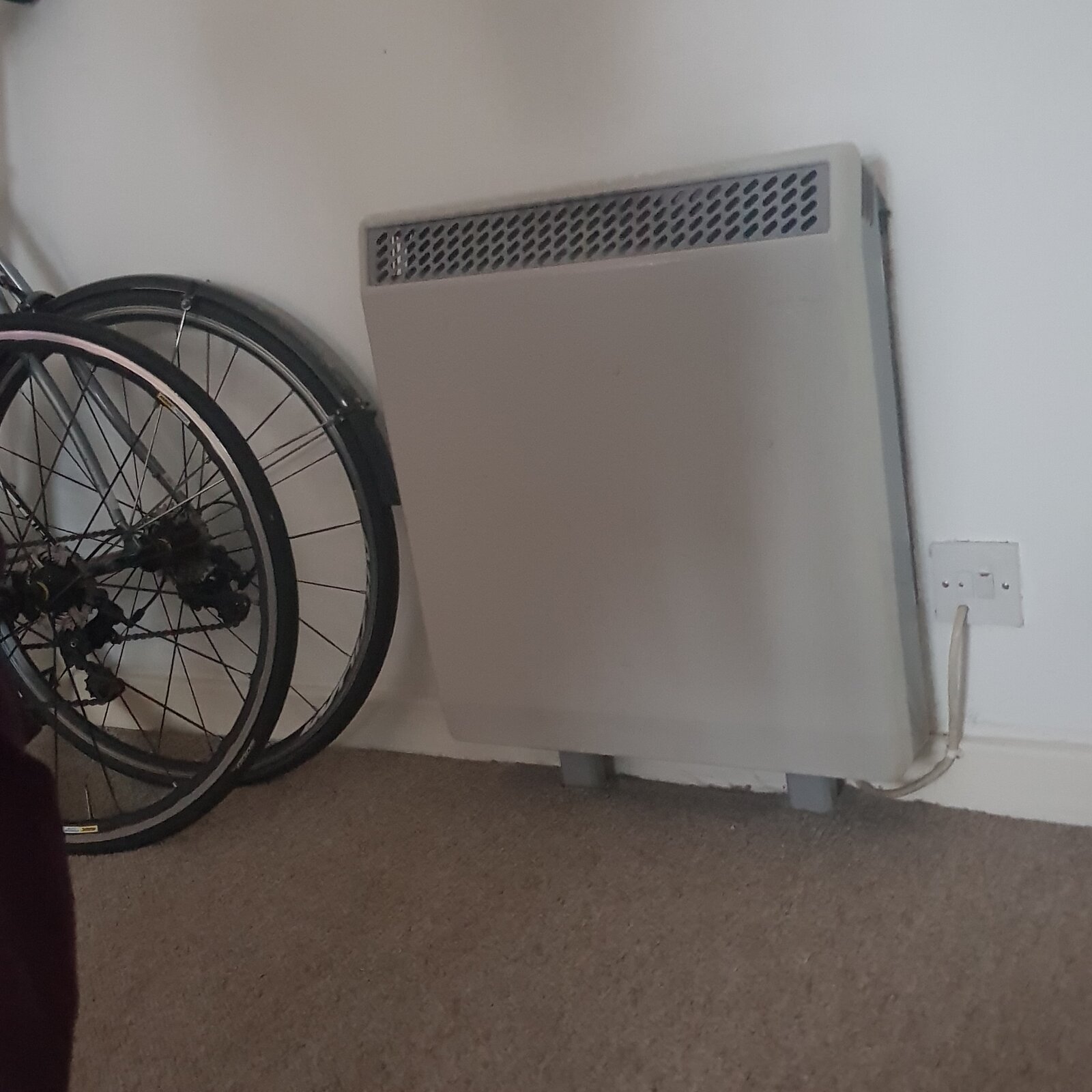

The height of the radiator includes the feet.
The 70cm height matches the 26" bike wheel quite well!
Your sons radiator is the original XLS12, the XLS12N would be a direct replacement.
The input power rating is 1.7kW

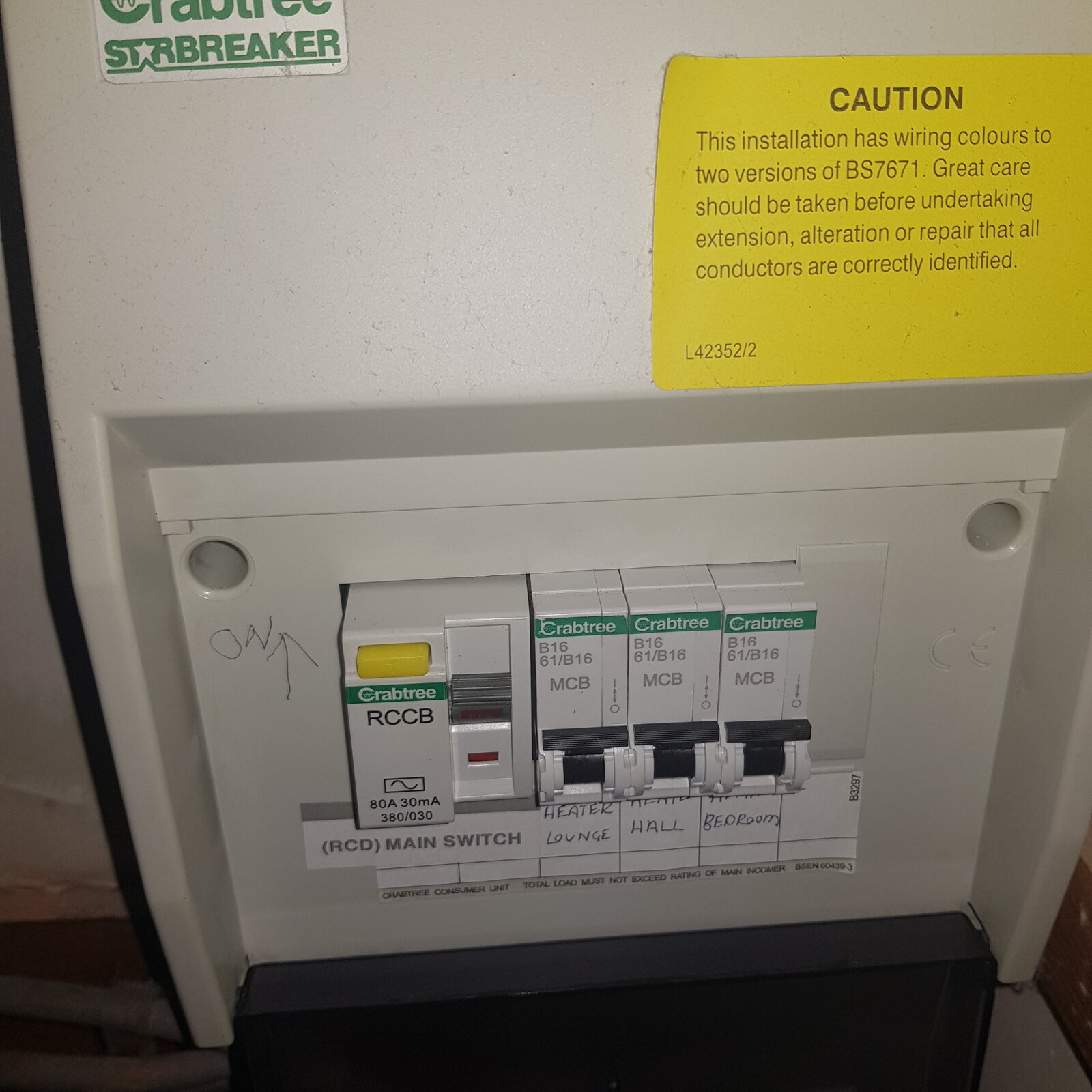

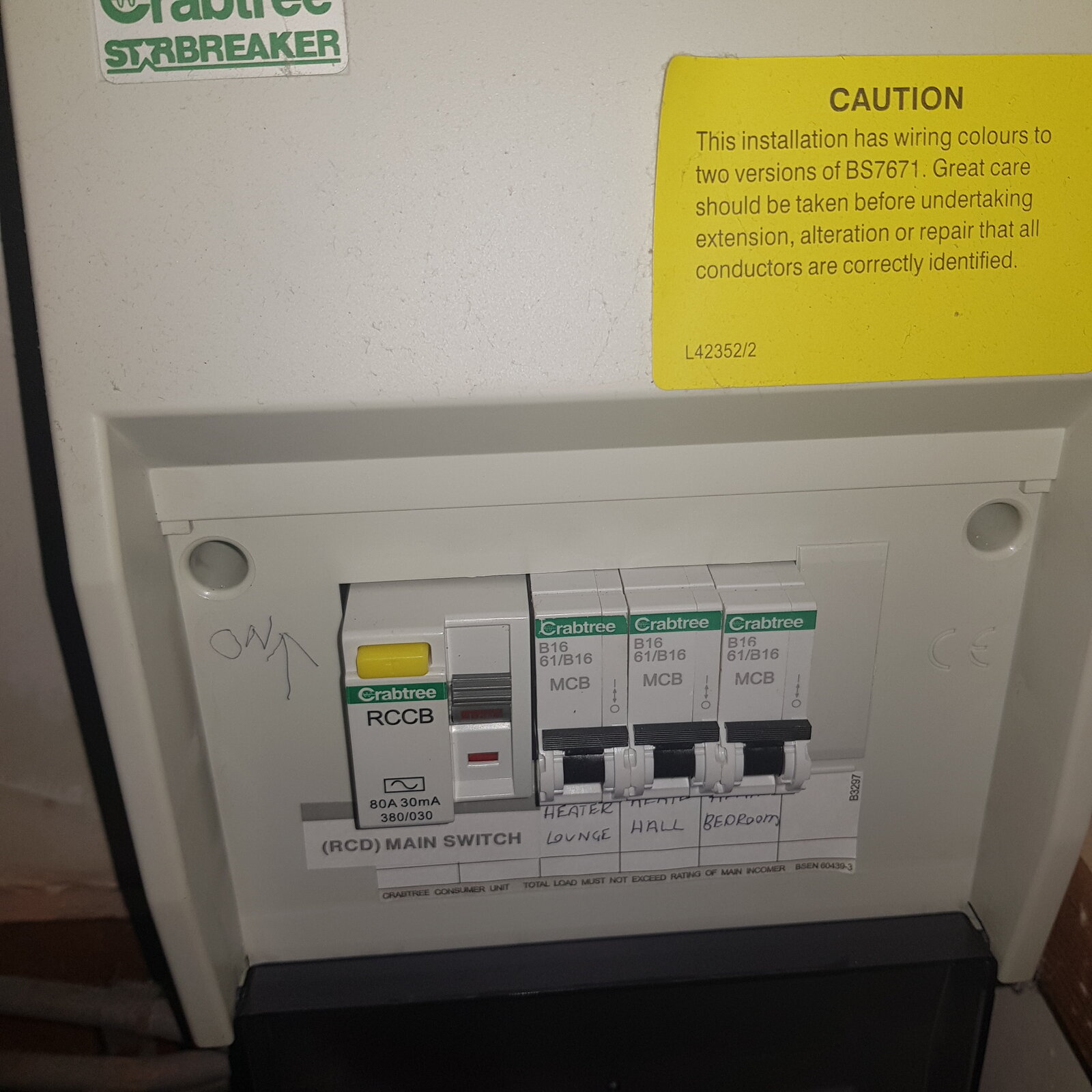

What would the maximum wattage of all three new heaters this fuse board can safely take, pic attached

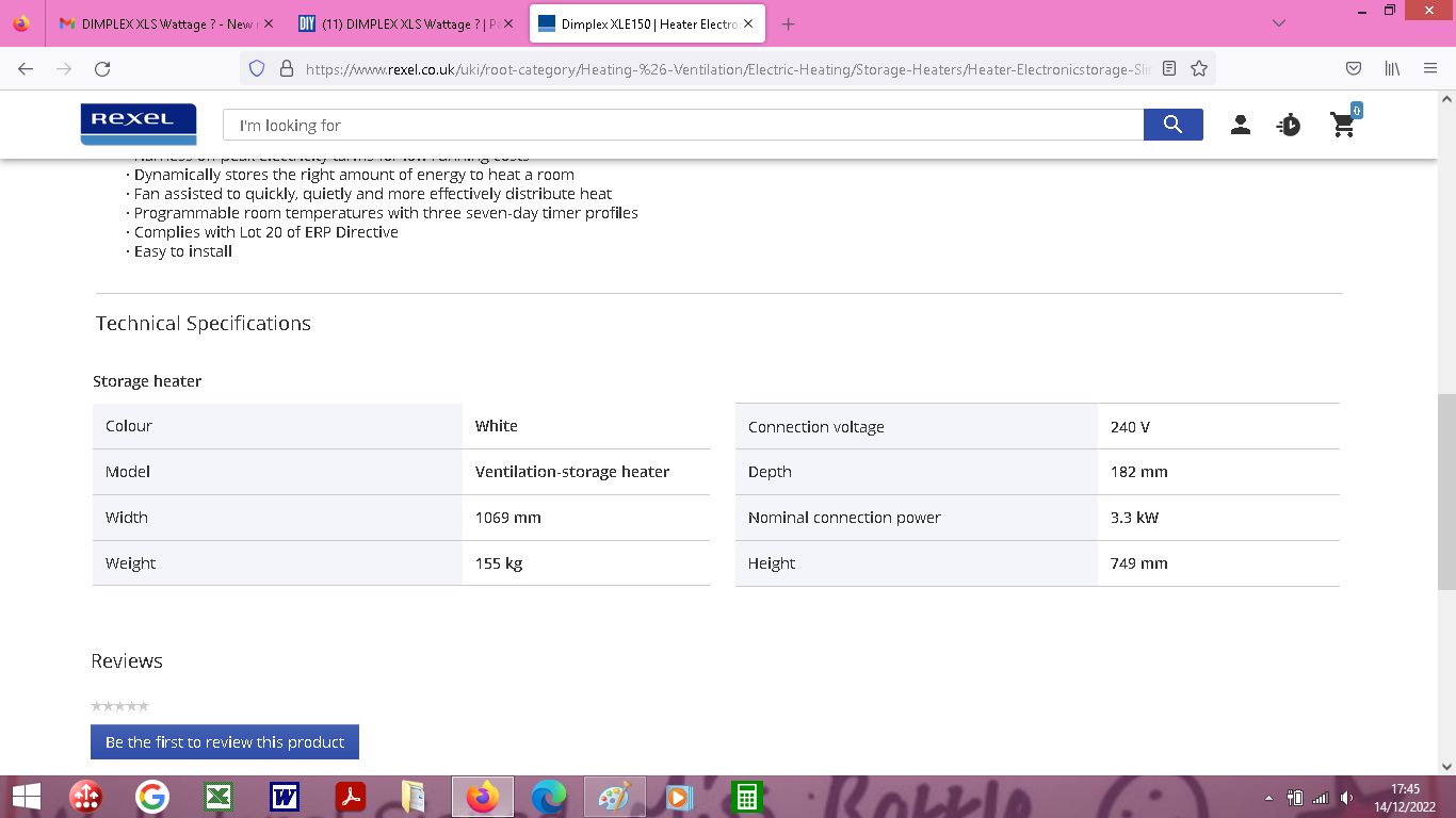

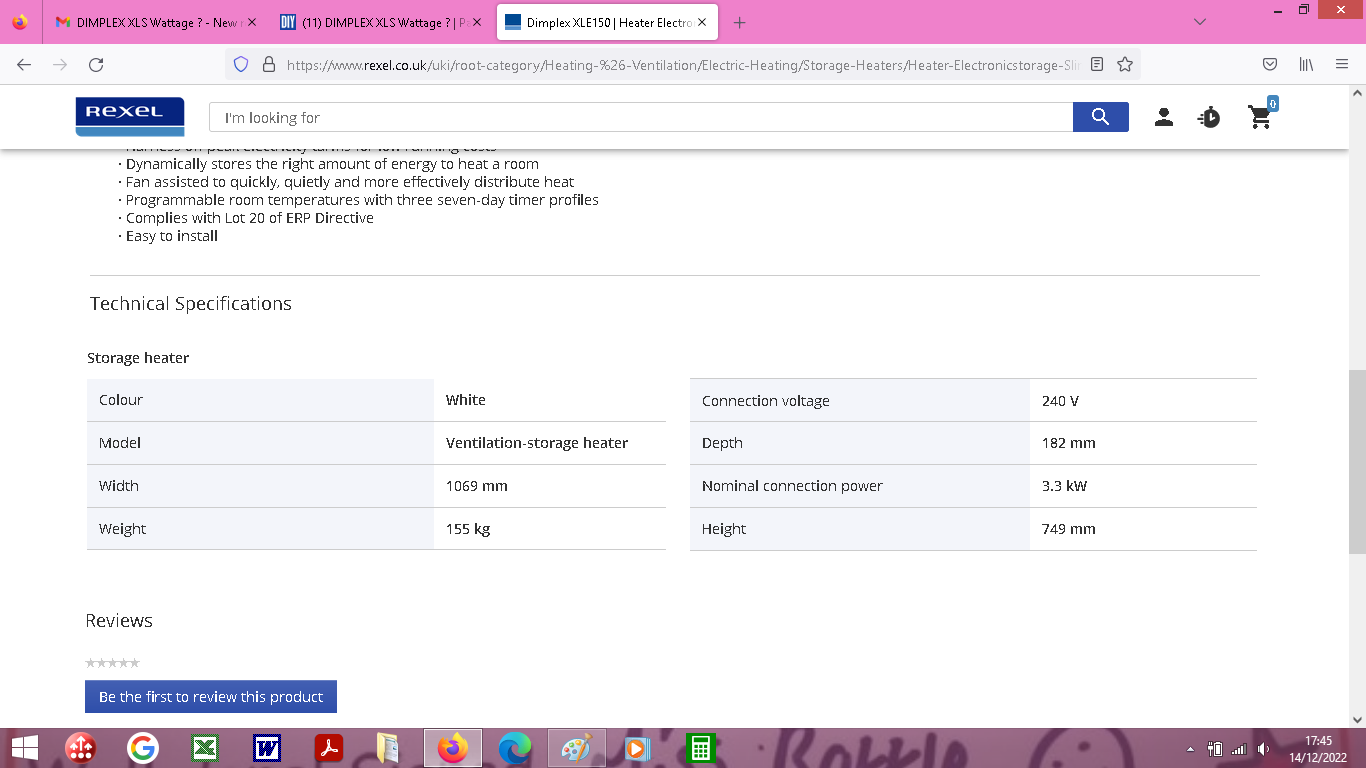

Just be a little aware when investigating these NSH. The listed wattage on websites will be the output wattage - so the XLEO 70 is listed at 700W, when the input wattage is 1560W - This is of course how NSH work! ;)
Yes indeed but the input power is fairly prominant in the spec, example:
I think it's one of those things that I notice more, as I am mostly browsing this site on my mobile.
Mobile sites have a tendancy to hide things behind drop down buttons - sometimes pertinent facts aren't always immediately visible! :)
