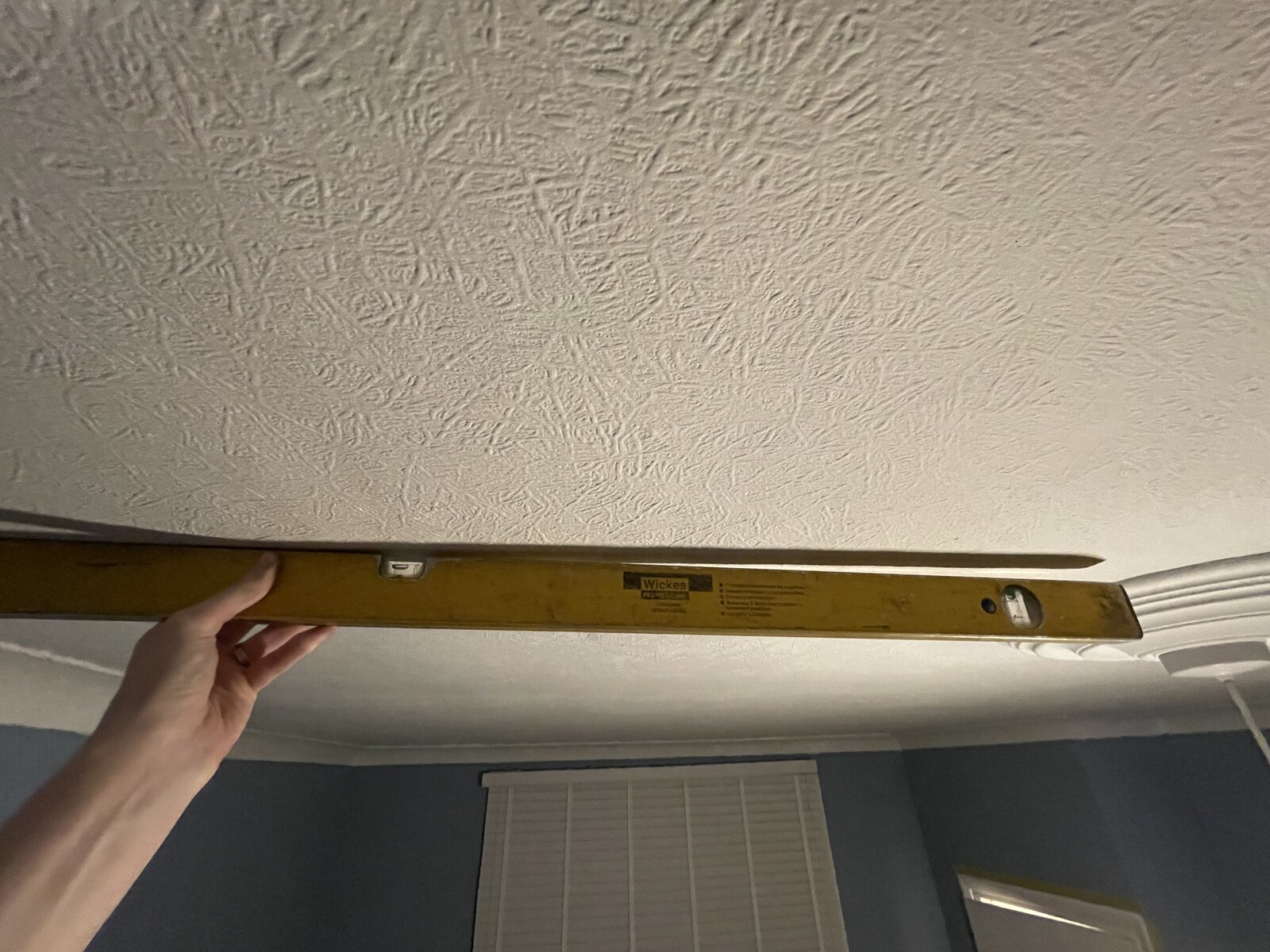

As there is a ceiling below, then any post construction bowing of the joist(s) would crack the ceiling. OK, the ceiling may well have been re-boarded in the past (plasterboards would not tend to be original in Victorian times), but a bow would still show.

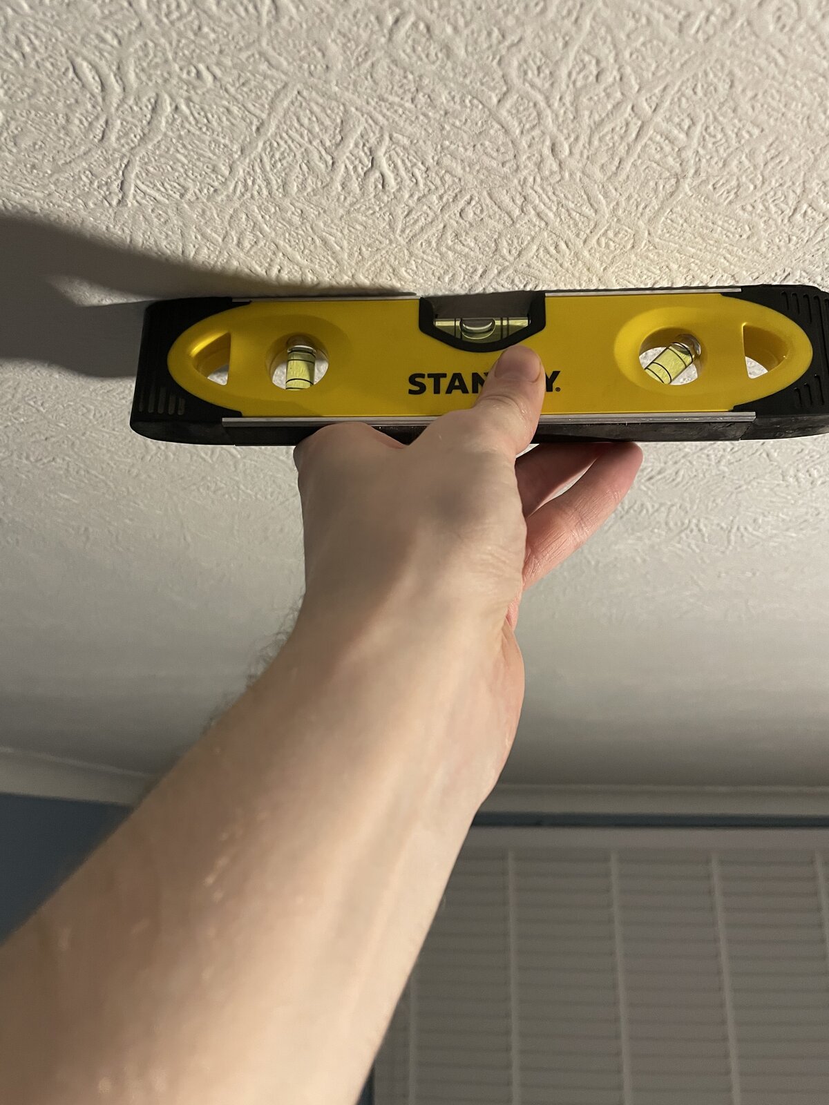

Try your level on the celling below. Also what is that room? just a bedroom?
But TBH, there could be several possible reasons, but fundamentally it would not be a structural concern.

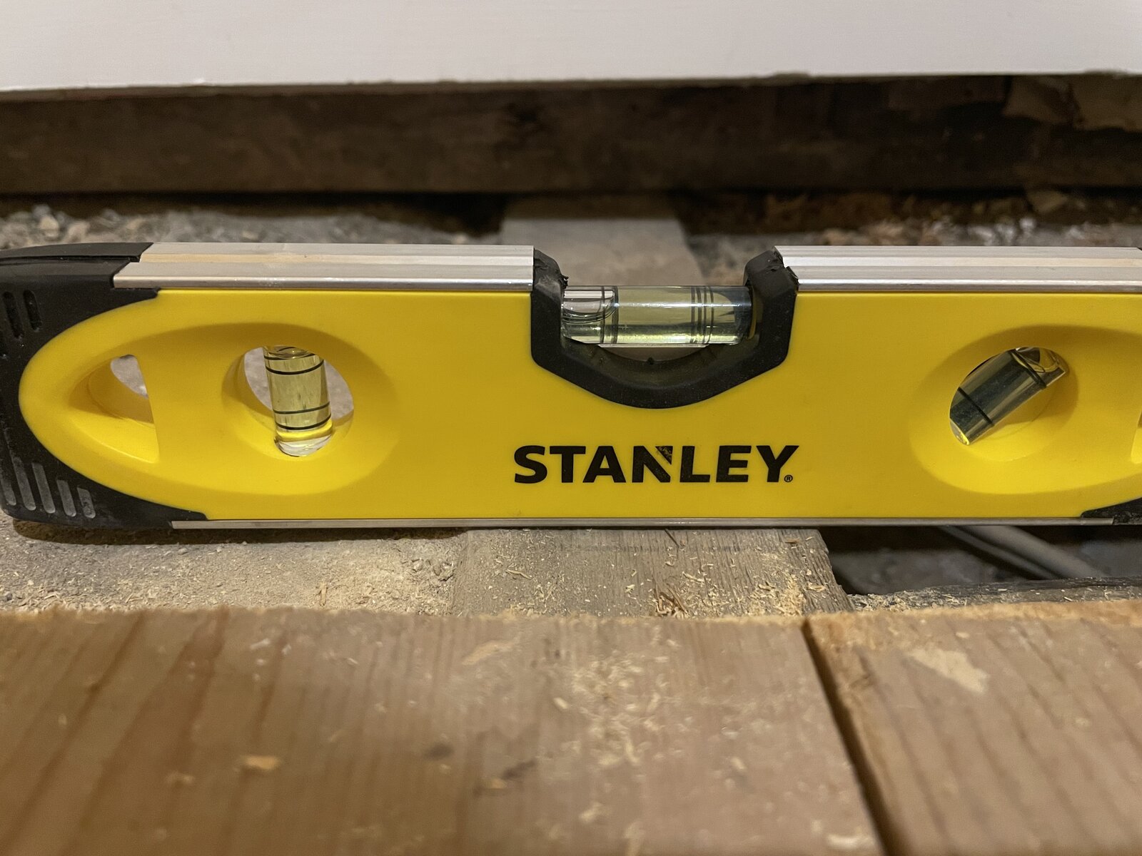

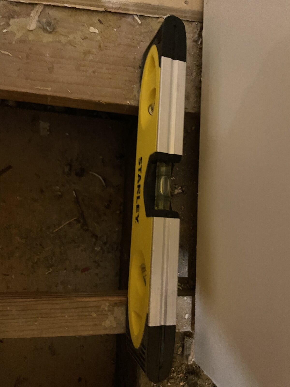

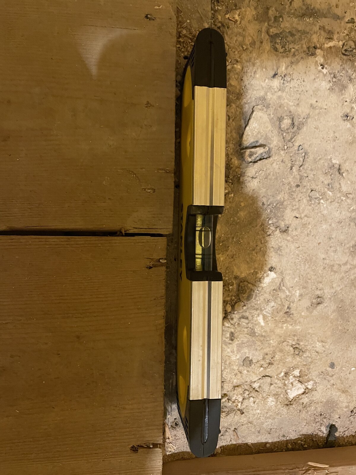

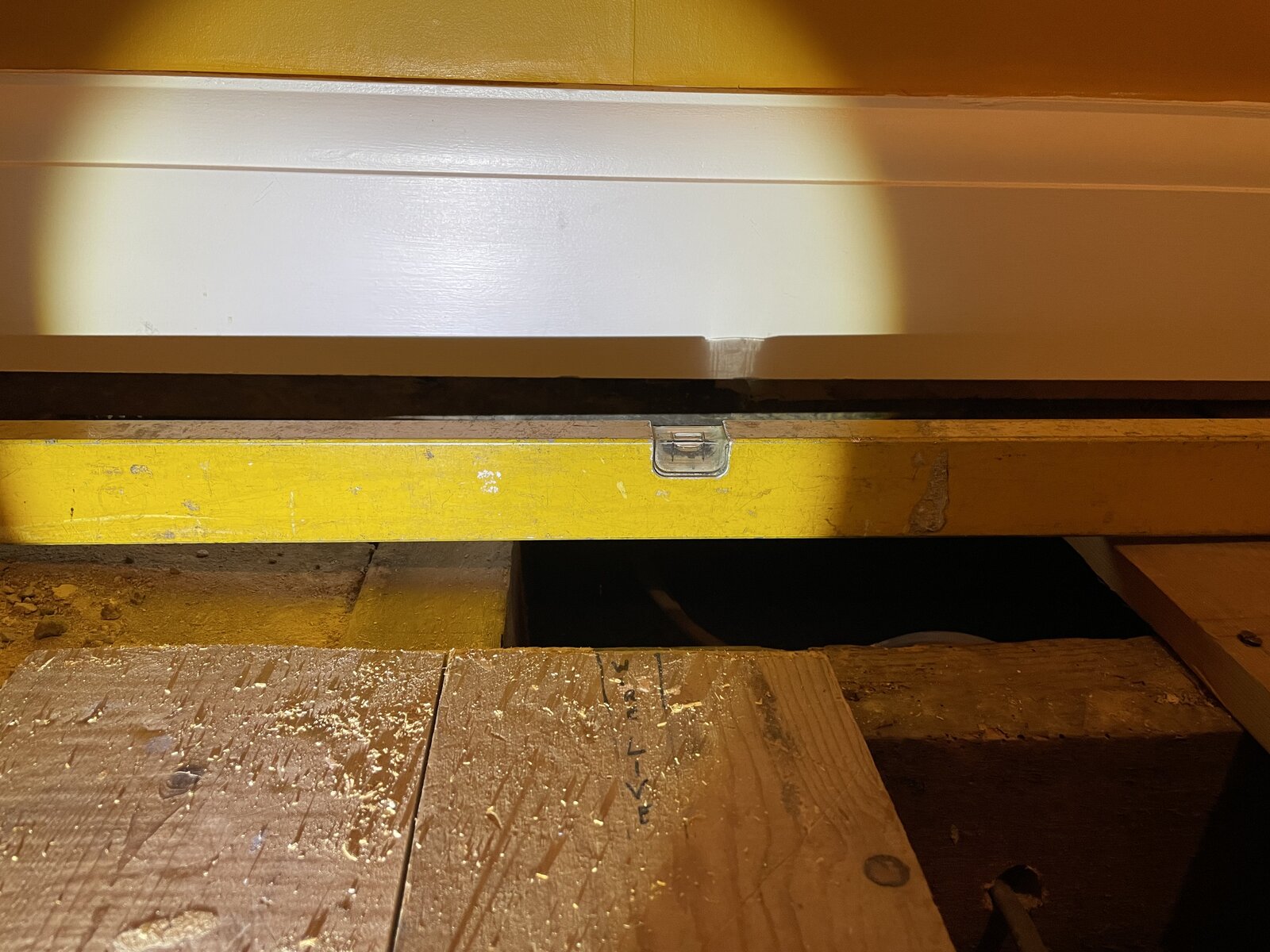

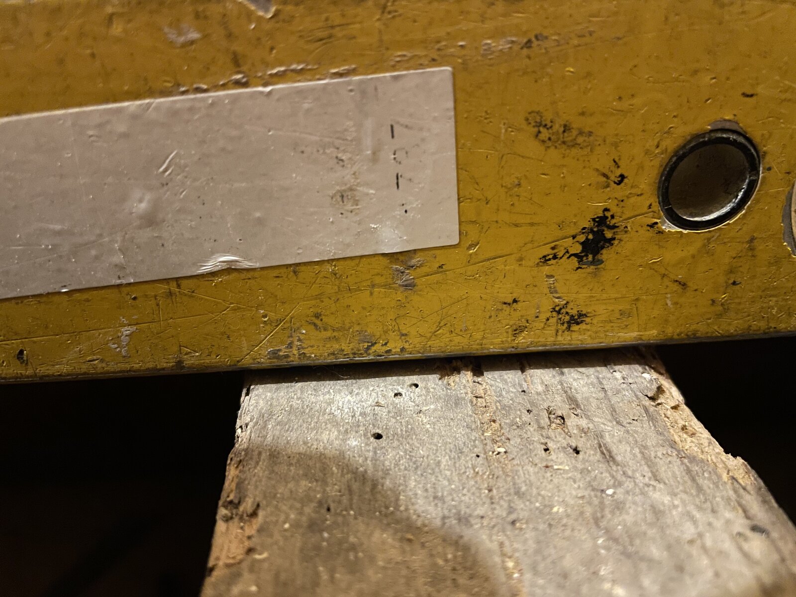

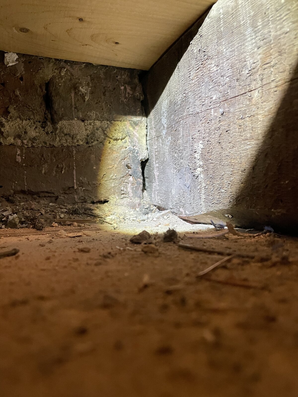

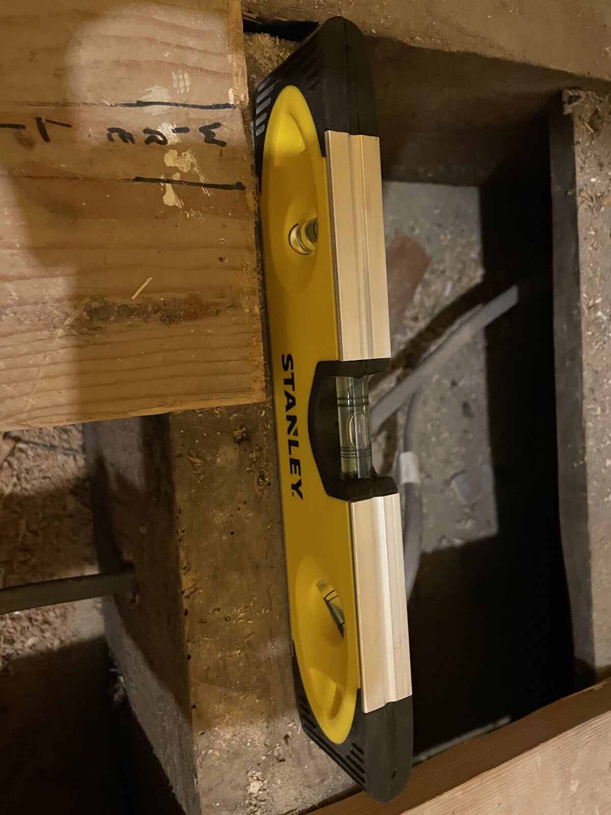

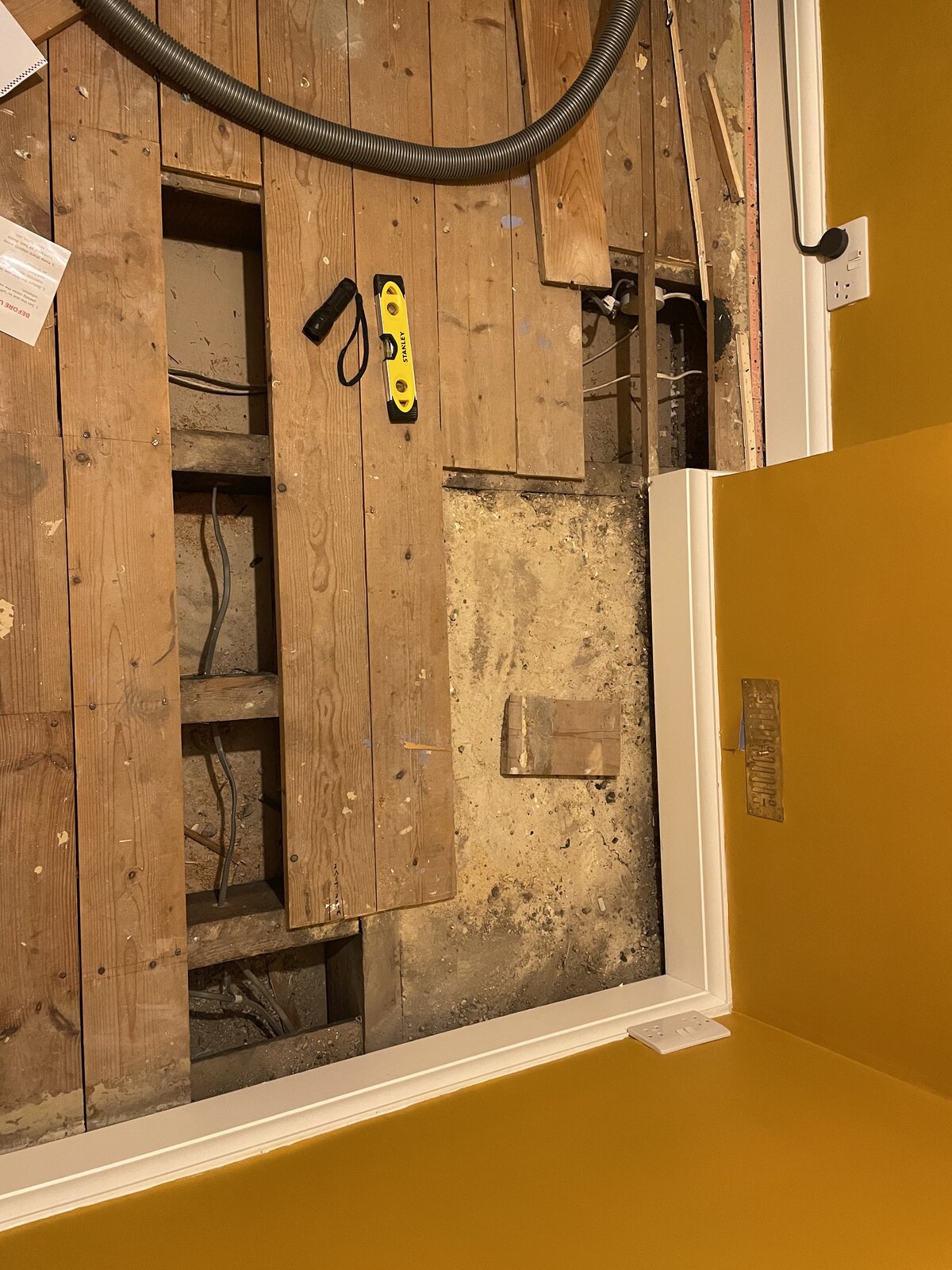

Got as many up as I could with those ******* cut clasp nails. F254 shows the area we’re working with. 9623D, Db4Da deal with the area left of the hearth, where the joist enters the wall. They show that there is only a minor slant in the joist from the wall, and 2DF2 and 5D355 show that joist. Looks alright to me?

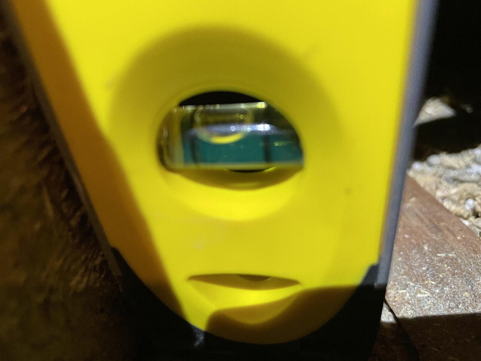

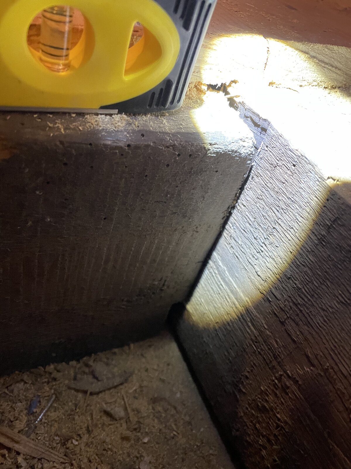

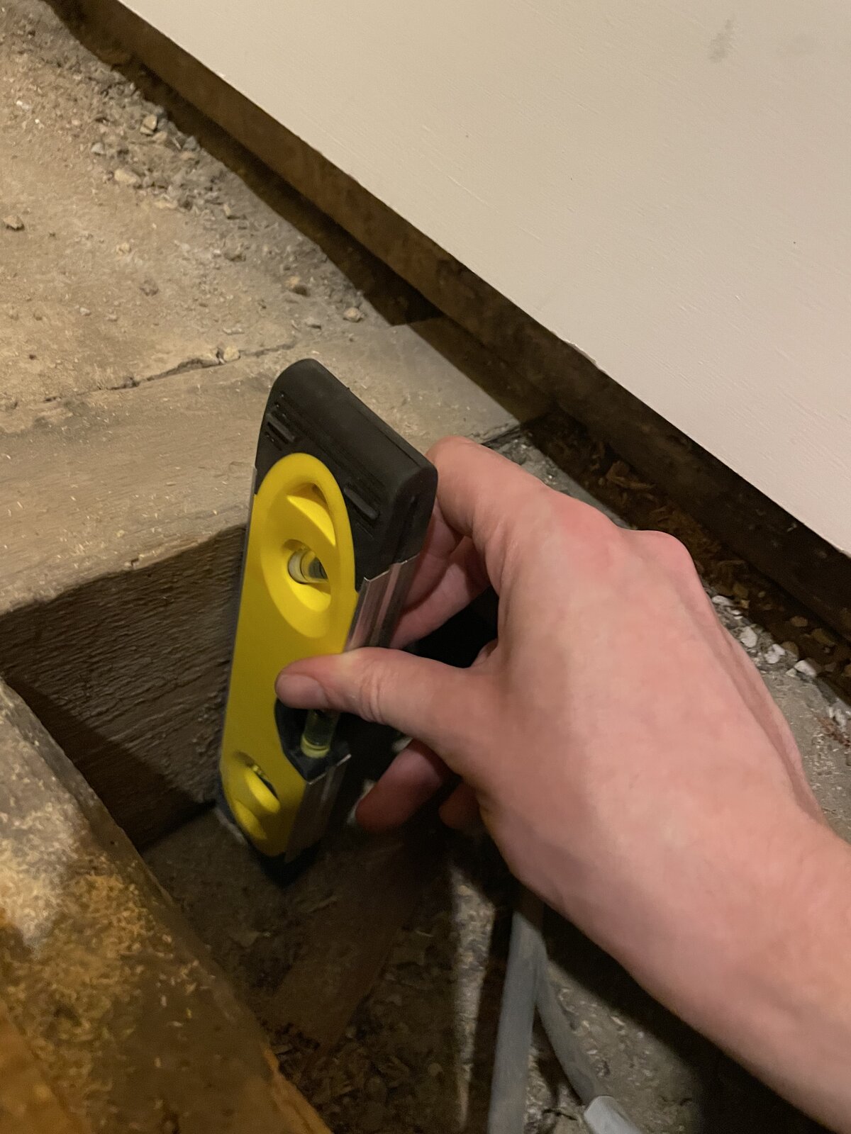

The big gap (2AA2D) comes from how the concrete of the hearth is higher on the wall end than the other, explaining most of the dip. But the concrete is level on the lowest end still with its frame, so doesn’t seem to be slipping (could also slide a piece of paper underneath it from the joist, so the hearth isn’t touching the ceiling). The hearth frame (8AD3) is also diagonal under the floor board, but I measured it in the manner of 9A97 and, as shown in CF852, it’s straight so might have been cut diagonal at the top for some reason?
Will post pics of the joists connected to the hearth frame below.

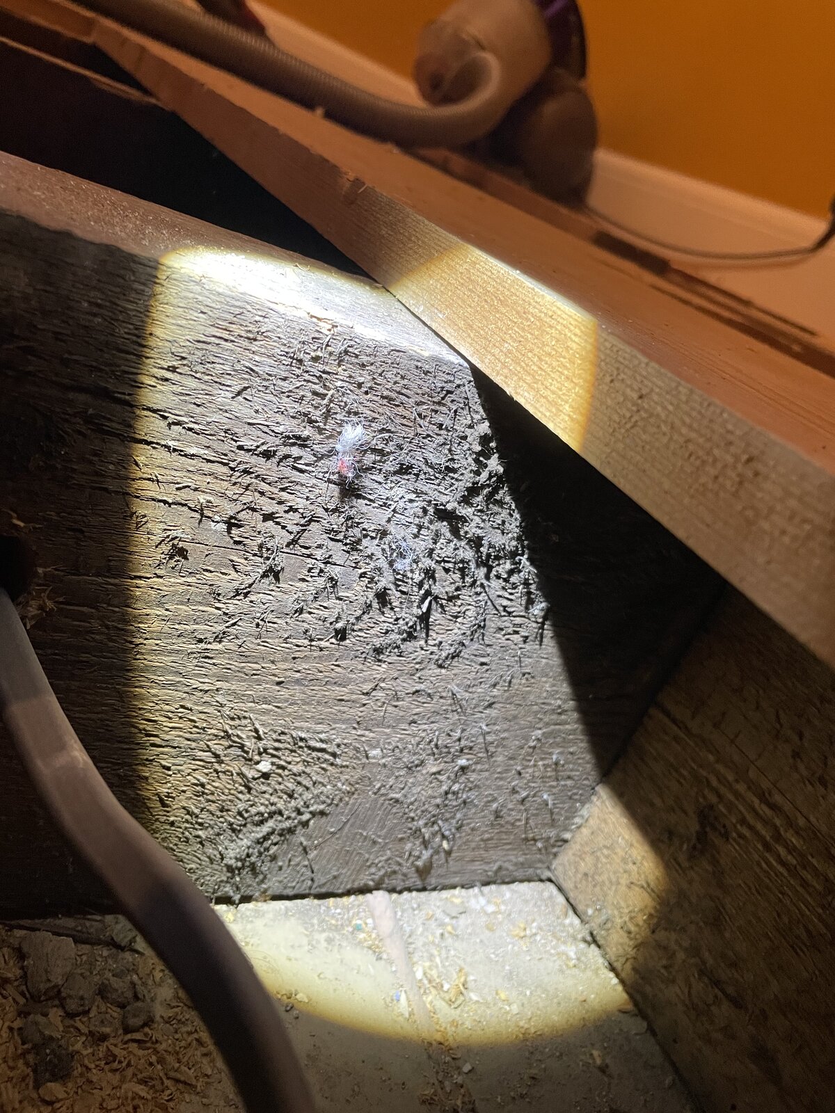

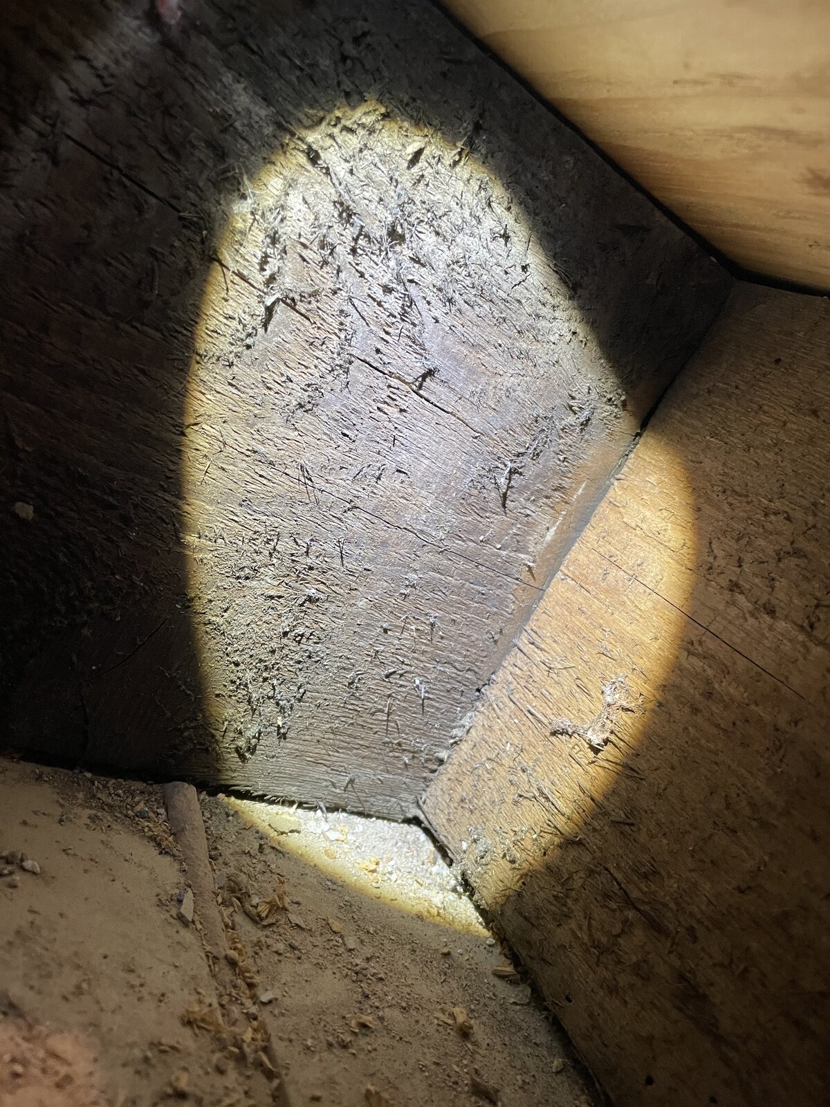

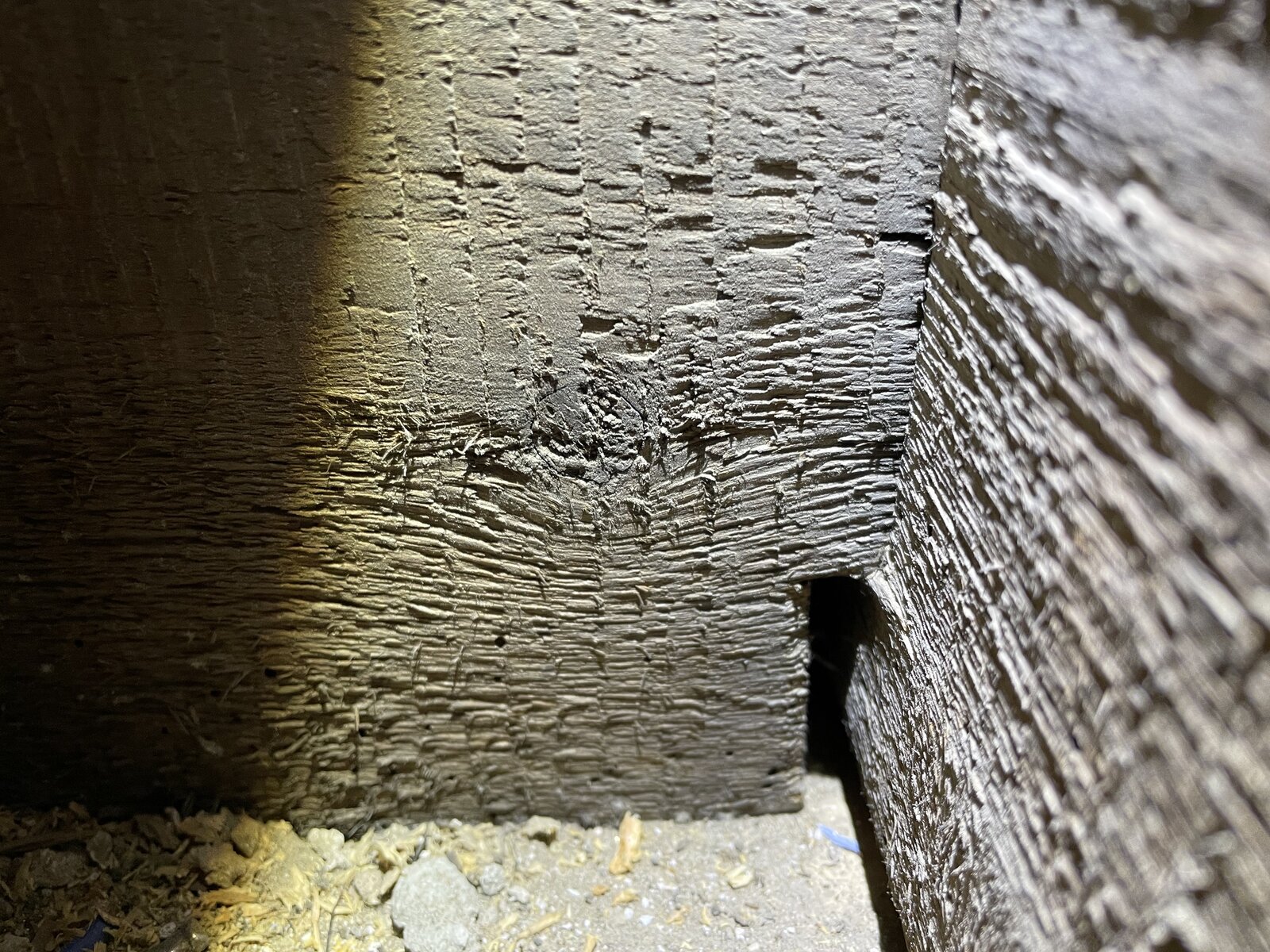

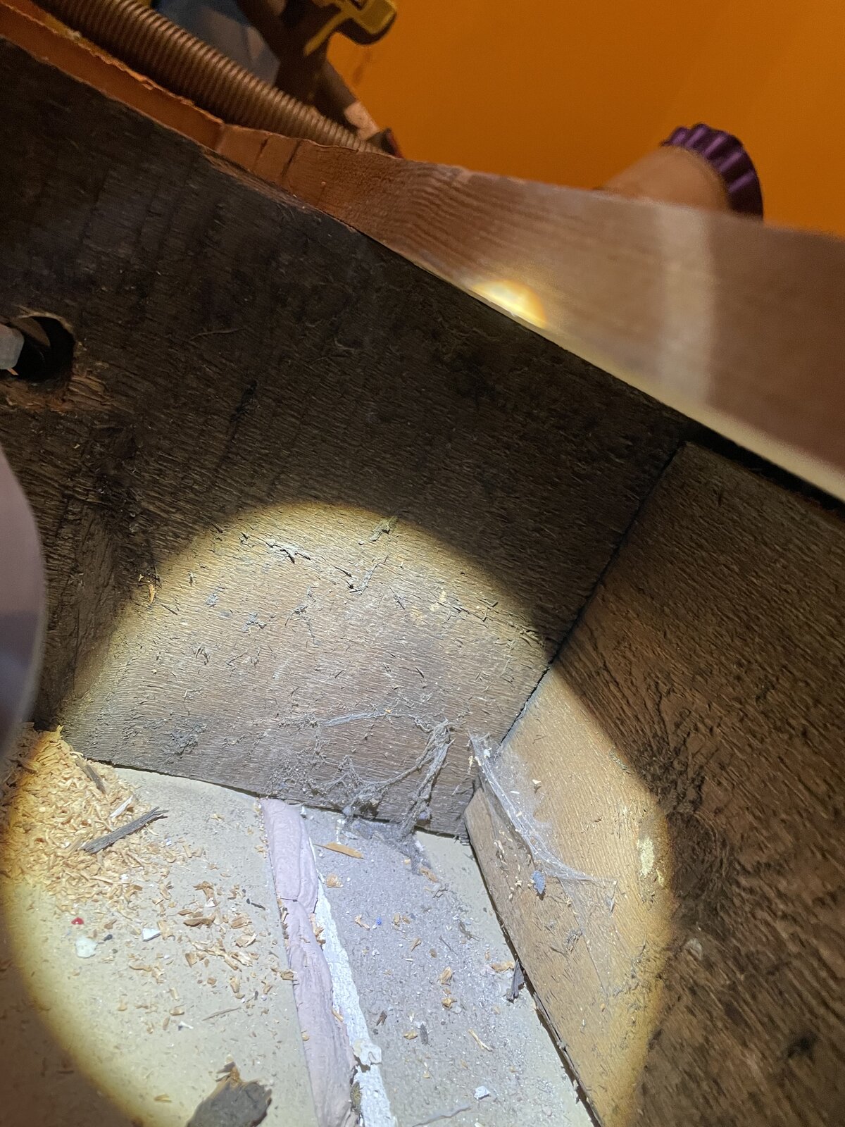

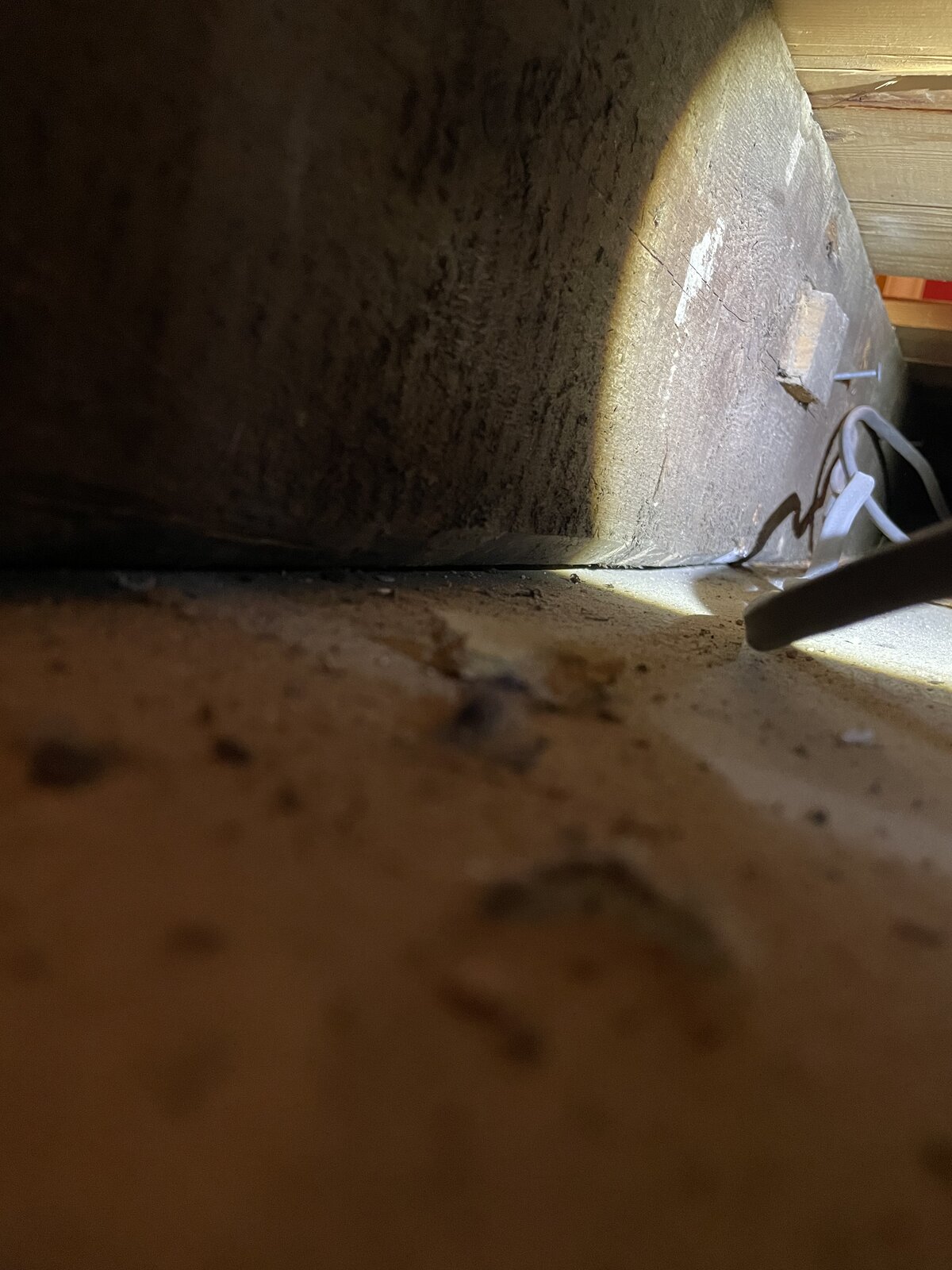

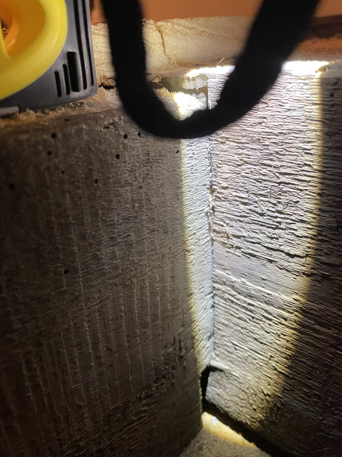

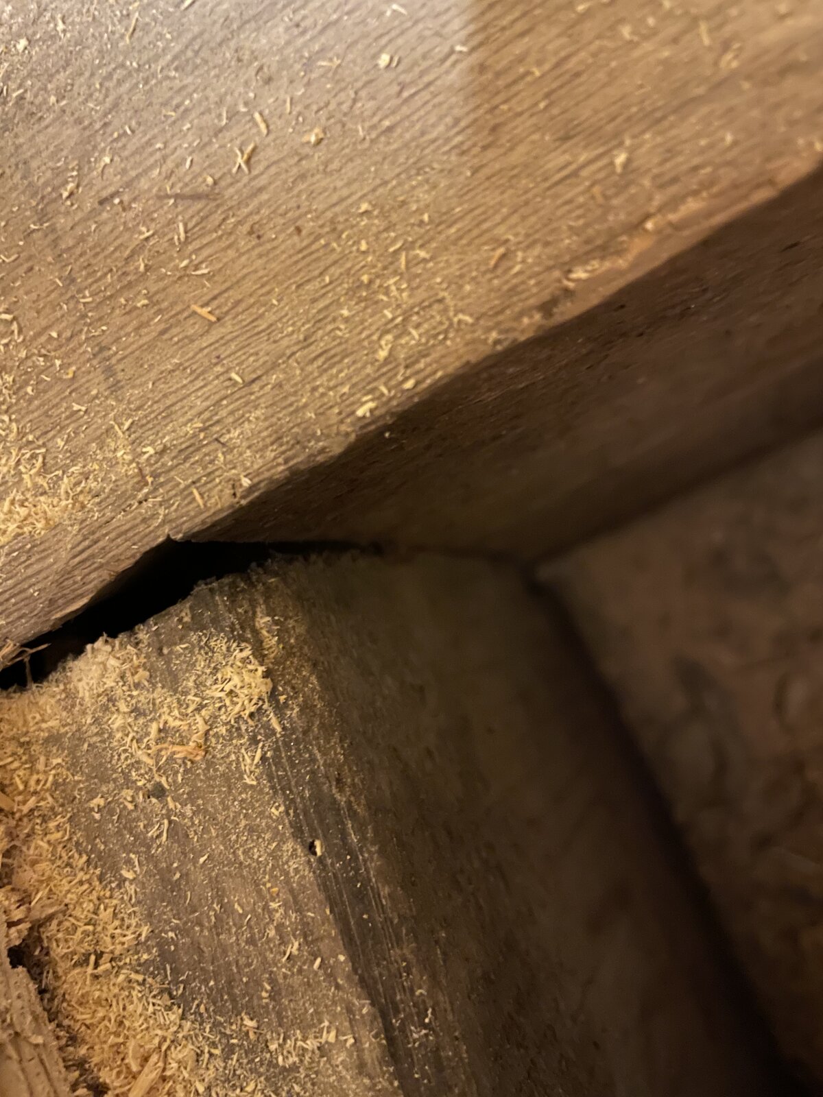

Continued from above. I looked at four joists related to the frame. E0211, 3EDBD, B855 look all connected and sit straight.
The joist closest to the wall (CAE7) is marginally lower, as in probably mms. It does, however, look a little less snug in fit (0DAA, 6682, E60BB), and it sits a little less straight (78D1) than the others next to it. However, it’s contribution to the dip seems marginal.
In sum, nearly all the dip is due to the unlevel concrete hearth! Any thoughts on whether it can be left like this or not?

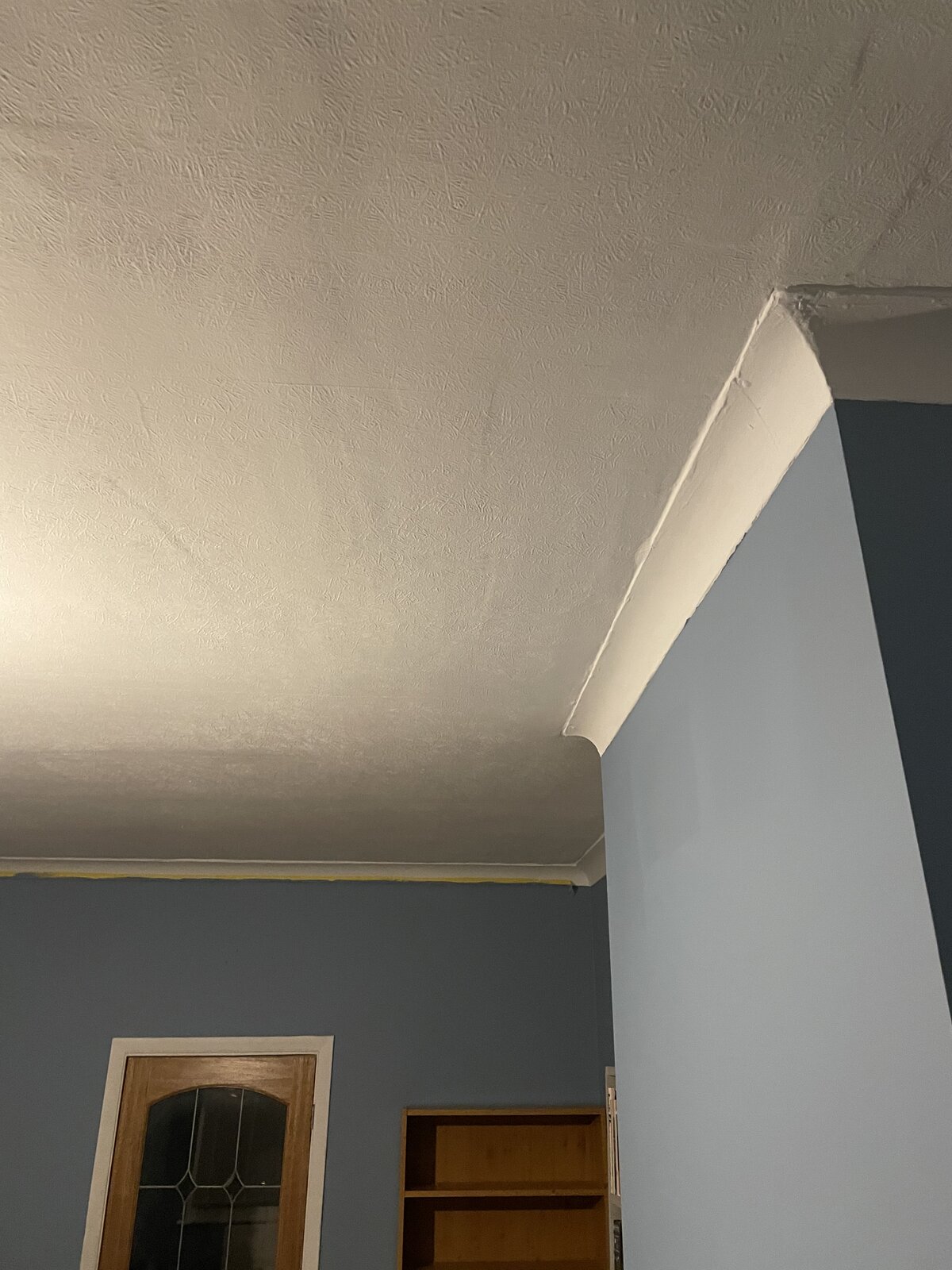

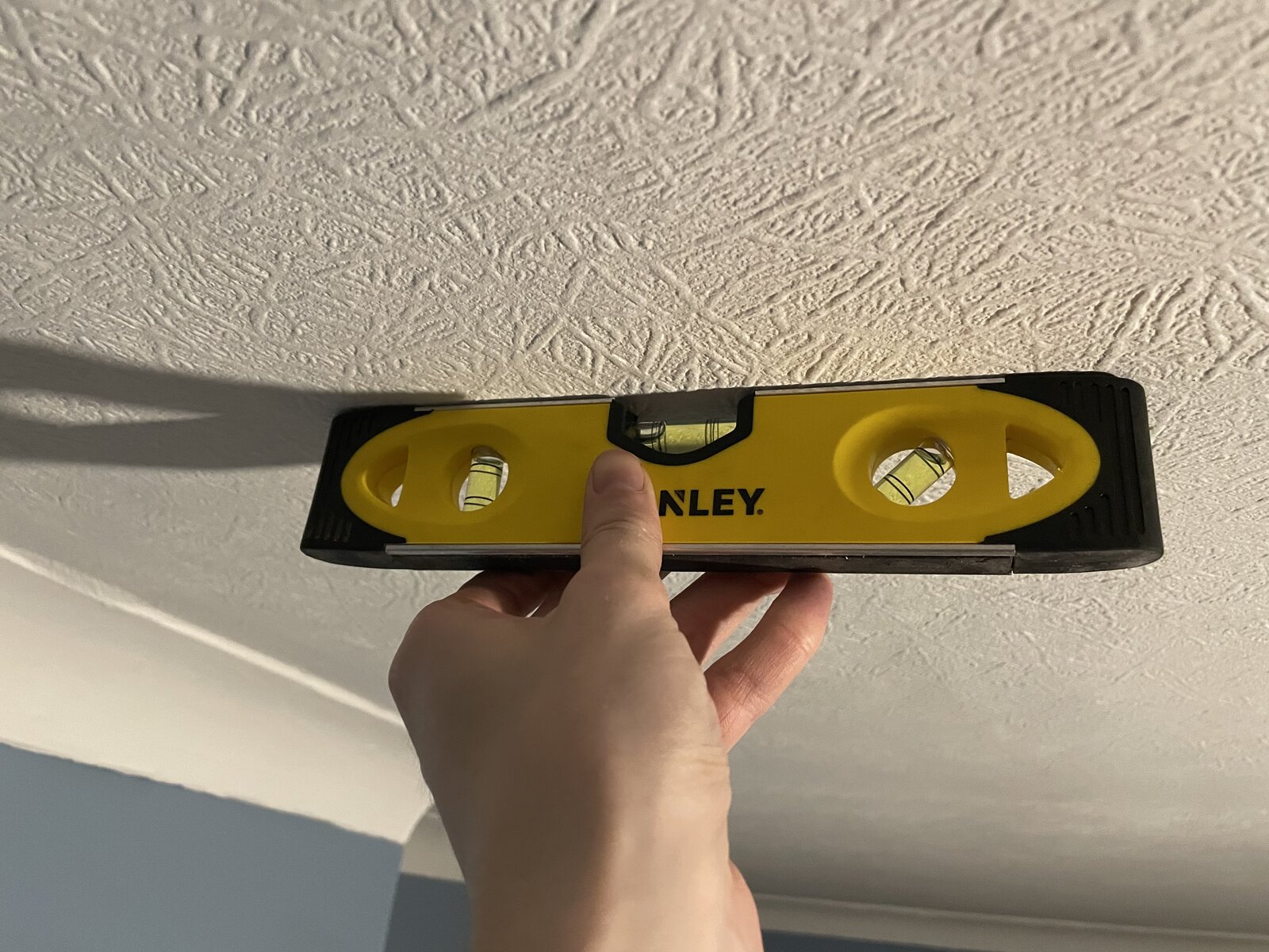

See above for investigation from upstairs. Directly below the bedroom, there is a ceiling bulge. Looks like it start sharply then quickly straightens out. Would be surprised if this is because the hearth were impressing directly on the ceiling as I was able to slip paper below the hearth upstairs so it is still suspended. And the joist connecting to the wall seemed fine.

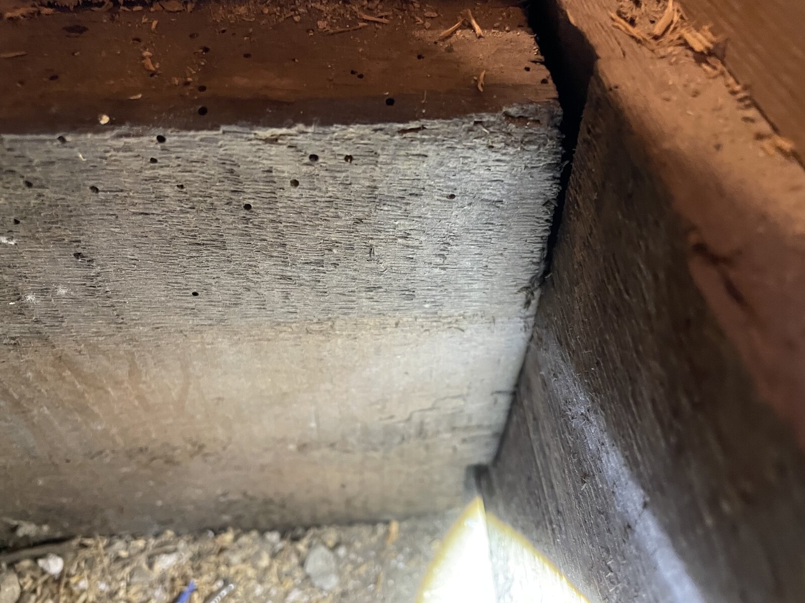

Saggy baggy joists almost certainly. If you've managed to check that the joist ends aren't rotten then it's just old age...not going to suddenly fall out the sky but wonky floors can be a nuisance
Not sure how to identify rotten joist ends, but these didn’t look rotten at all! Will just have to live with the character maybe
