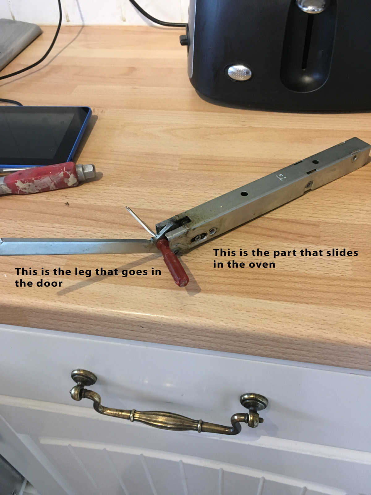

Sorry should say 600 G a Hi I need to change the hinges but can't see how the door comes off on this oven. It doesn't have the flap lock type like most ovens.
Also any advice on how to remove the hinges would be helpful. Is the main body of the huge in the door of the oven

Hi Chaps, I have worked it out myself and TBH I was surprised there was nothing on the net to show how its done
On these ovens the hinge is one item and is unable to be split.
Here is how you need to remove them.
1. Open the oven door you will see a grub screw on the oven door, one each side. this holds the legs inside the oven door.
remove these screws then slide the door back. On the hinge joints there are holes. I put a small screwdriver in to stop the legs springing up. Then slide the door off completely.
1. The remove the hinges: undo the screws holding the oven to the unit, slide the oven out about 6 inches. On each side of the oven close to the bottom you will see
2 silver screws one is about 1 inch in the other about 5 inches in. these hold the remainder of the hinge in the oven. Remove these screws and slide the hinges out.
The problem will be the spring in the main part of the spring has weakened.
Fitting new ones is a reversal of this.
2 new genuine ones cost me £20 off eBay.
Hope this helps
