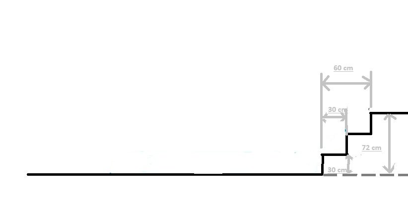

My parents want to come out to visit this year. My Father is in a wheelchair, but the access is absolutely not disabled friendly.
There are 3 steps to the entrance. Their is no other entrance. The space at the front is limited. A disabled ramp is not possible. It would be too steep and any attempt at zig-zagging it would need a lot of re-working the front, which would probably affect the footpath.
I am looking for some clever ideas to get my father, in his wheel chair into the house.
The steps are 720mm high in total. The lowest step is 300mm high, and the top two are 210mm high each.
The space available at the front, including the footpath, to the house floor level, is 2.5 meters to the road.
Even using the footpath as part of the ramp, the angle would still be too steep for even an assisted wheelchair, not to mention blocking the footpath.

This is the situation at the moment.

Theoretically a ramp would work, but practically the angle is far too great. I think it's something like 15 degrees from the horizontal, and the recommended slope is more like 7 degrees. At 15 degrees there's a possibility of the wheel chair overbalancing.

Thanks JJ and Harry. As previously mentioned, the big problem with a ramp is the slope, Anything approaching 15 degrees creates a potential for overbalancing. Any further out and we'd be in the road. Going right to the edge of the pavement would mean mounting the kerb immediately followed by the ramp.
The road isn't that busy, so something in place for the few minutes of going up and down a ramp would be possible, if the ramp was light enough to be easily moved.
