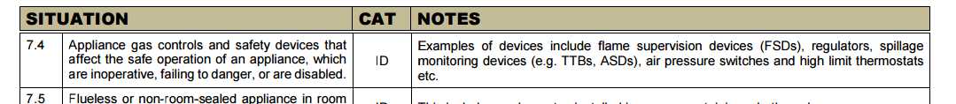

Even so I am not convinced that a failed on FSD would be AR.
It would only be the same as having no FSD where it is now required and I expect there is a good argument for it to just be NCS.
Quite right Tony.
For exactly the same reason that it's ok to leave a boiler on if the safety devices fail to close the gas valve when they should.
What's the worst that can happen eh?? (y)
Errr I seem to remember there's a classification for defective safety devices, now what was it again???

Try the GIUSP Edition 7.1, Subsection 9, paragraph 7.4
In fact the OP may well be due an apology. I didn't see the bit about the failed FSD's
But he was still wrong it should have been ID ;)
Tony knows better than all these bodies in charge of safety as well as the manufacturers with millions invested in product R&D.

AFAIAC, that is not testing them. You should test that the gas is cut off within the prescribed period, which depends upon the appliance category, when the flame fails.
