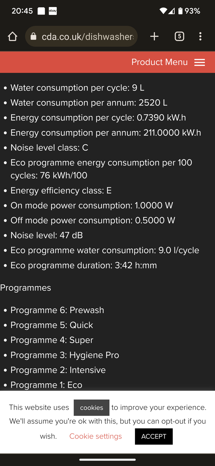

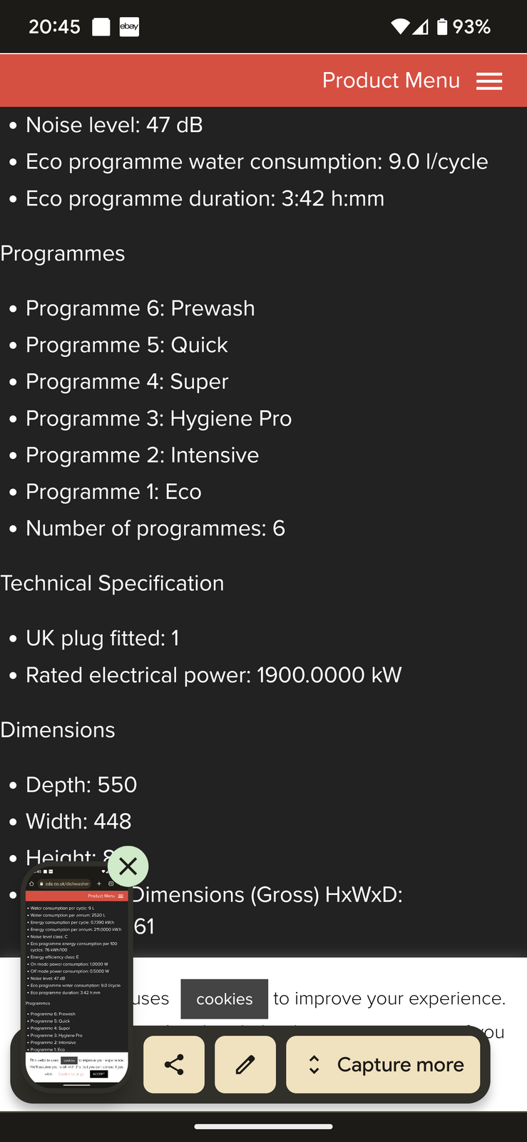

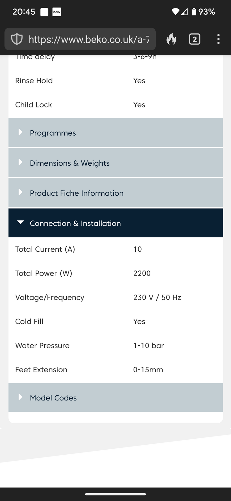

Anyway the washing machine is rated at 2200kw and the dishwasher is rated at 1900kw which would be over the 13a the fcu is rated at ,but from what I have seen on this forum a double socket is rated at 20a so would this be ok or would they their own fcu and single socket?
I have included the spec's for the appliances.

Poor design, that fuse will fail at some point.
Not necessary to have FCUs at all. If you must have separate isolators, a 20A switch for each appliance would be more appropriate.
A double socket is not appropriate for two high load items either, two singles would be far better.
