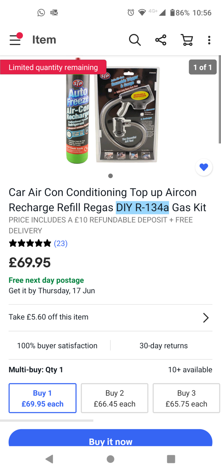

I've ordered a kit. The car's 11 years old, ice cold when we bought it 2 years ago, still working now just not quite as cold - I'm not spending hundreds on it for 3 weeks a year - it's this or we do without.

I've used one of those before. It should work, if there's nothing else wrong with your system, other than a lack of gas. However, it's only the same price as getting someone to do it for you at KwikFit, using a proper machine! (And then, only if you get your £10 deposit back). Of course, you still get your charging valve and gauge assembly to go with it, which you can use in future. I got one too, but the rubber seal in the bit that screws to the bottle got attacked by the stuff in the bottle and turned to jelly! Quite what that says for the stuff in the bottle and your car's seals, I'm not sure. Hopefully, the seal in the gun is just ordinary nitrile rubber so that's why it melted. I replaced mine with a green o-ring, suitable for R134a and I'll see how that fares!
