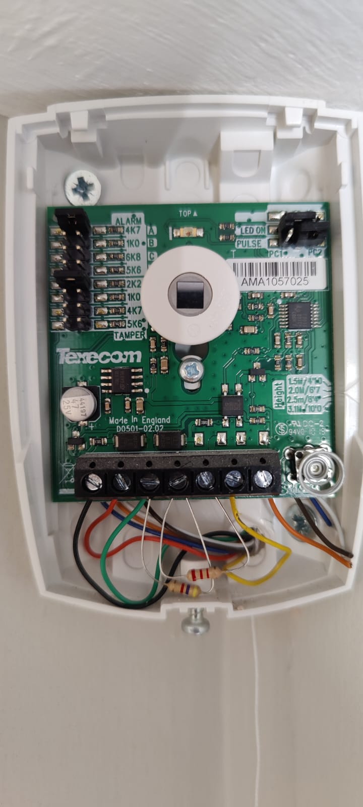

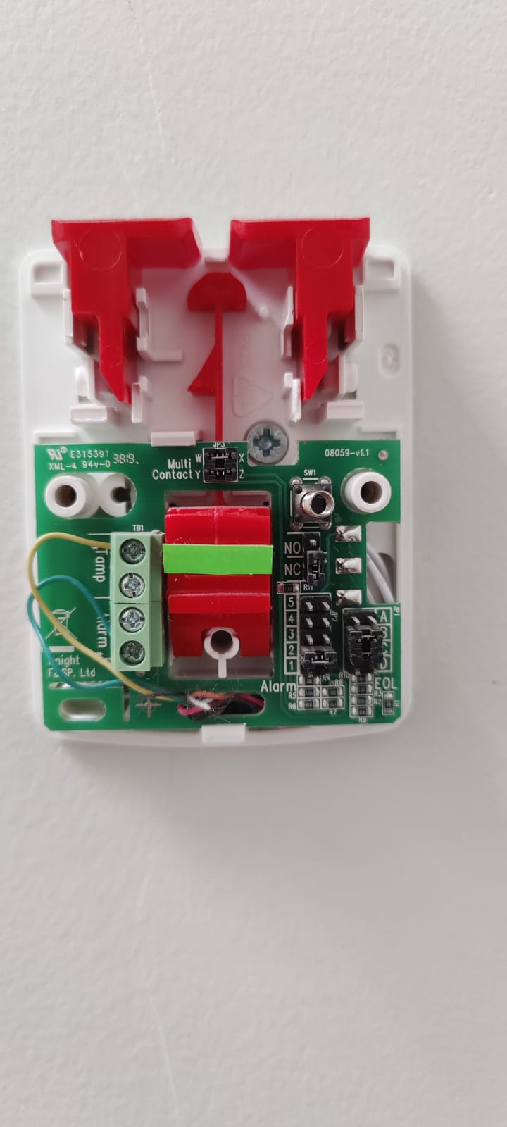

Hey guys,

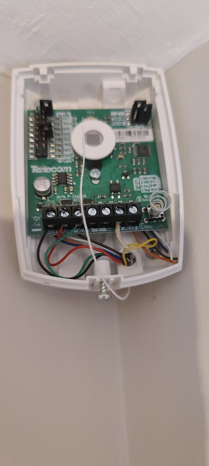

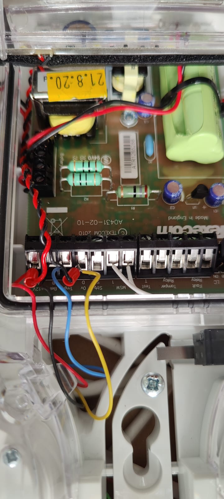

I purchased a Texecom alarm 1.5 years ago have haven't got round to getting this installed. I've mounted all the endpoints and wired them up not using EOL as it's just for home use. I don't have experience in alarms but was thinking if giving it a bash and buying a usb-com to help with programming.
I've wired the PIR as per attached, and have all the cables ready to be wired up. I'm i right in saying red and black should all be linked to power and yellow and green in my case into each zone for the PIRs
Any input would be greatly appreciated
7 PIR

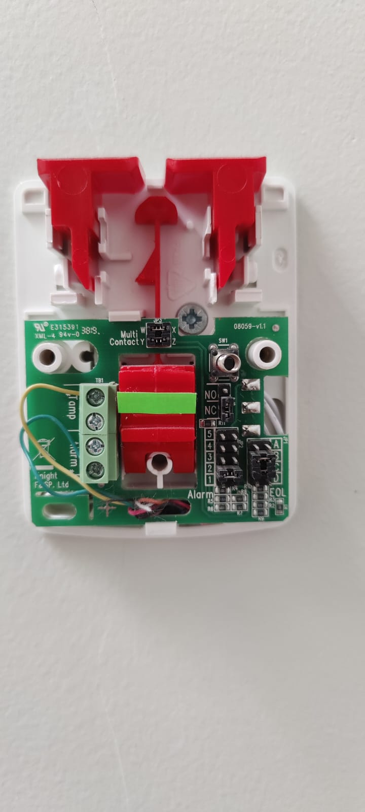

You have wired the detector as if your using EOL , either use 6 wires , 2 for power 2 for alarm and 2 for tamper …..OR set the jumpers in the detector for EOL …

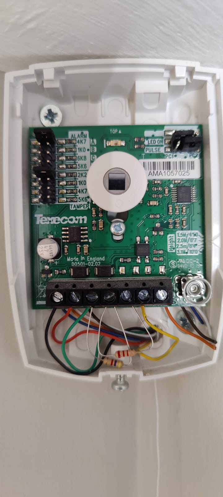

Hey Sparky, thanks you for pointing this out....got it, so I read its probably better to wire it EOL as it makes it easier when it comes to fault finding etc...
So I've put a 4k7 resistor between the 2 alarms and a 2k between alarm and the first tamper as per the pic... please let me know if that's correct?

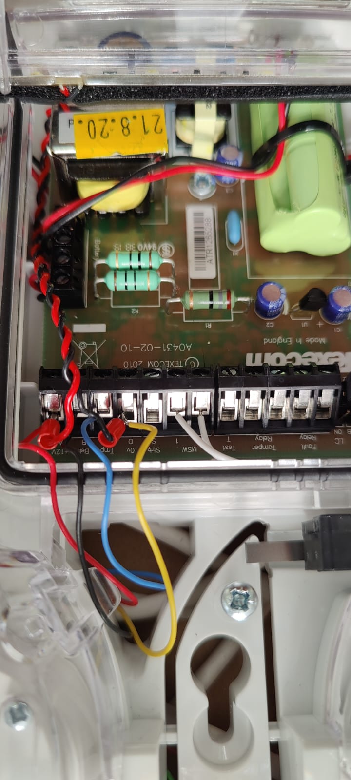

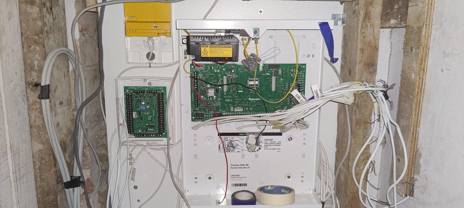

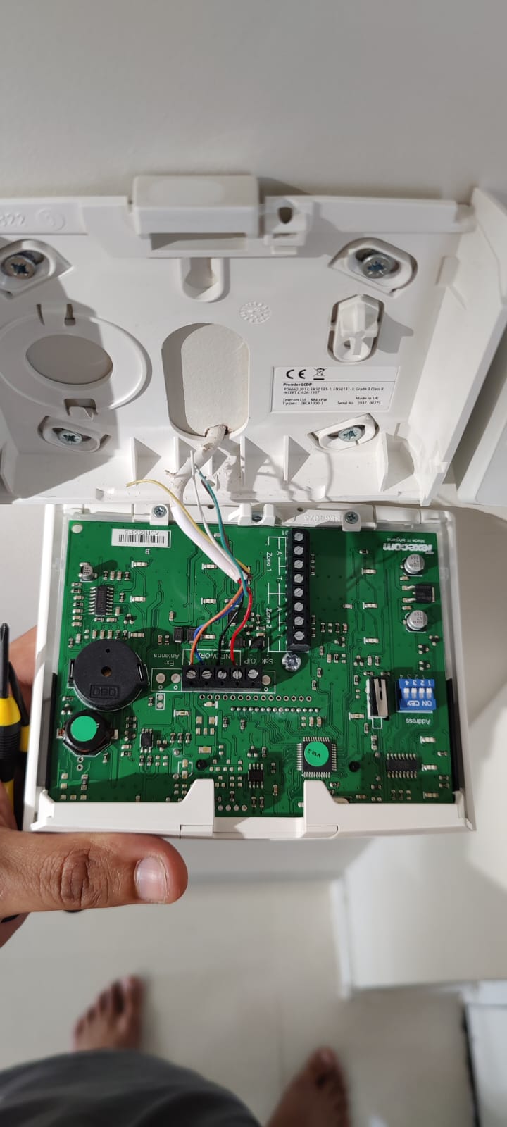

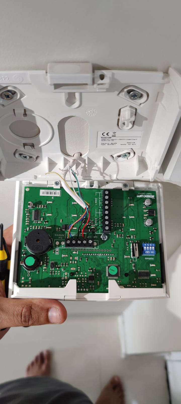

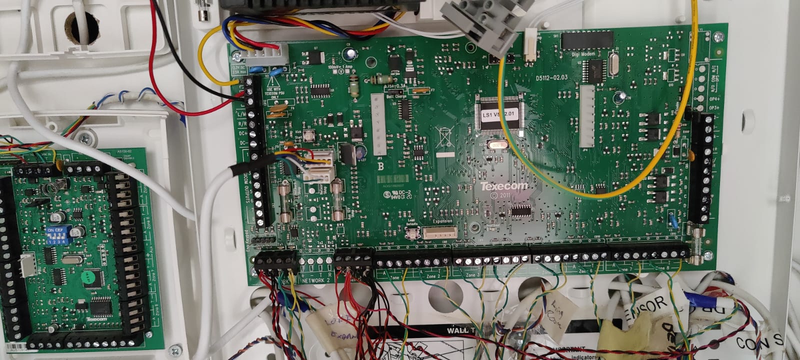

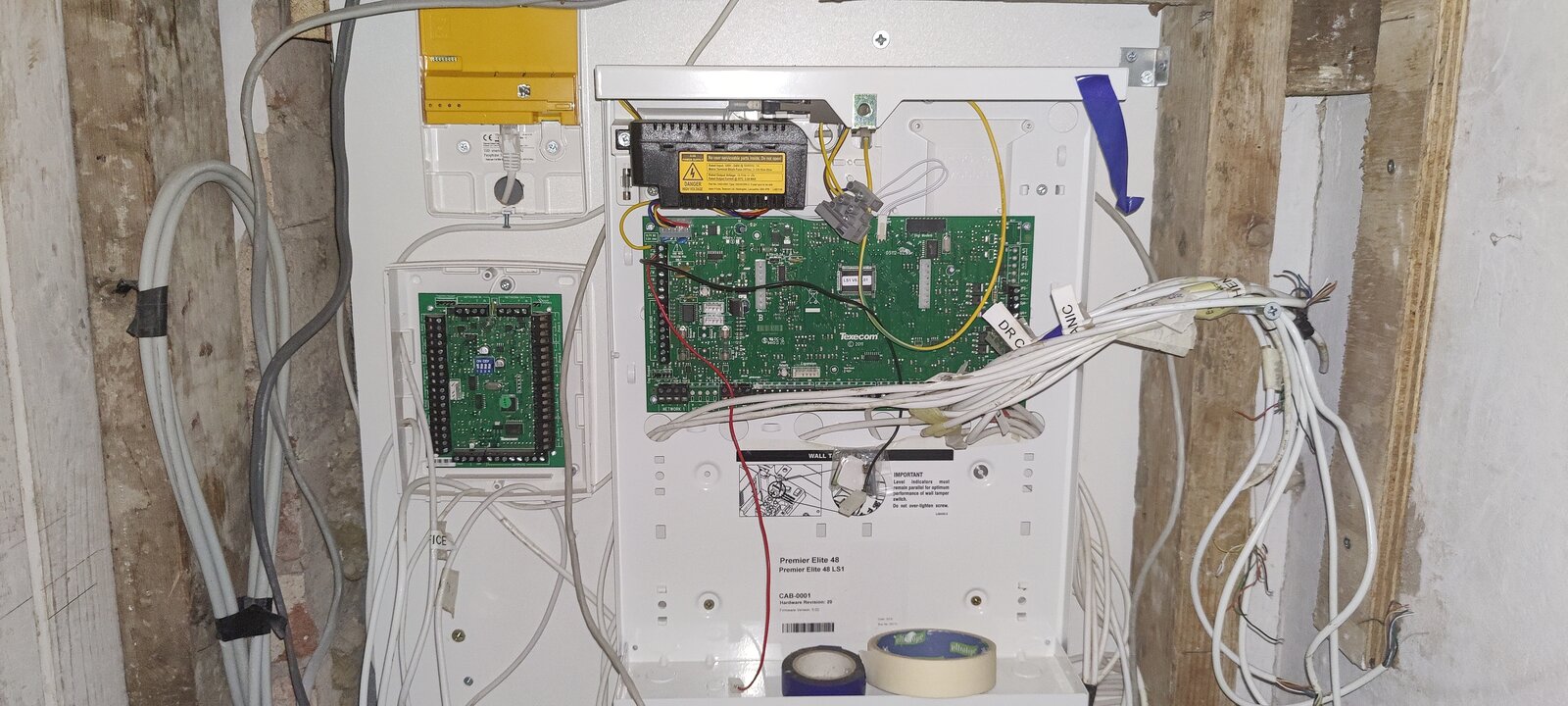

As I've done EOL for the PIR's how do I go about doing the same for the panic buttons / Keypad / Ext bell box...
(I need to change the wires on the keypad as the don't match on the panel end) I've added 2 expanders which I've wired the directly to the network on the panel.

You need to take the resistors out of the pir.
The PIR'S come with resistors built in and you choose the value by selecting the correct black jumpers setting.
The jumpers are correct on the pir.

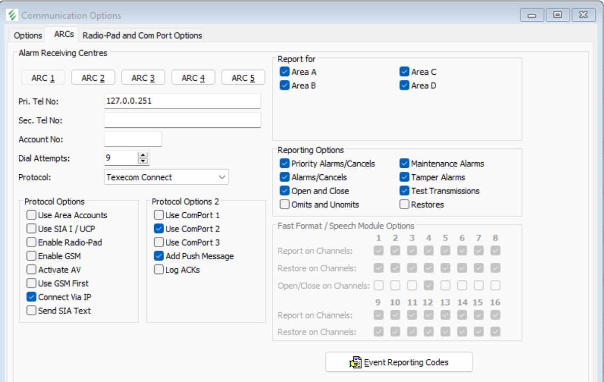

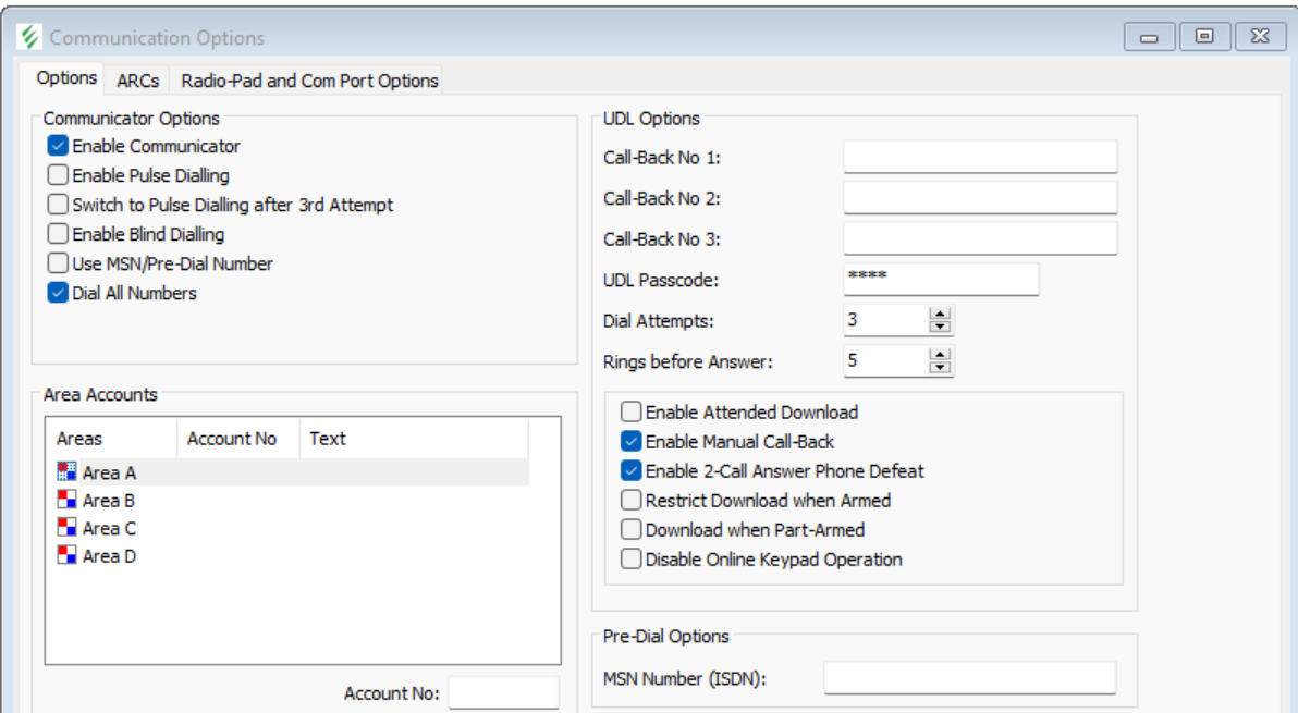

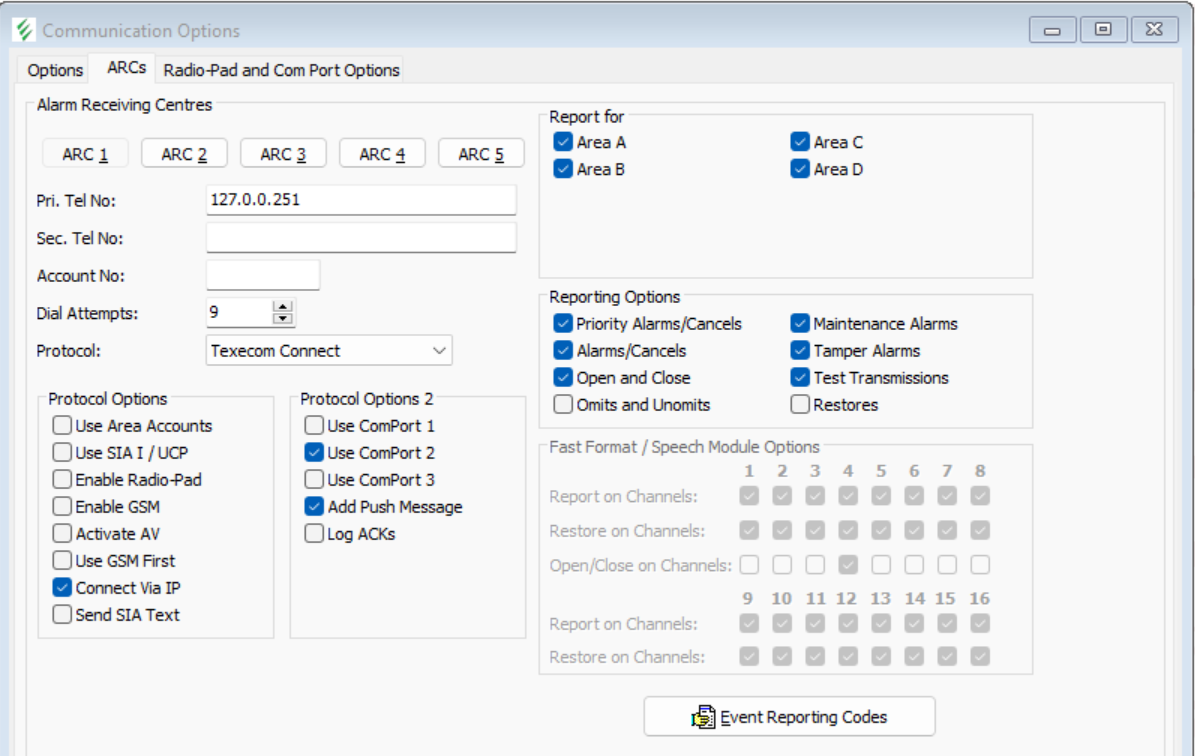

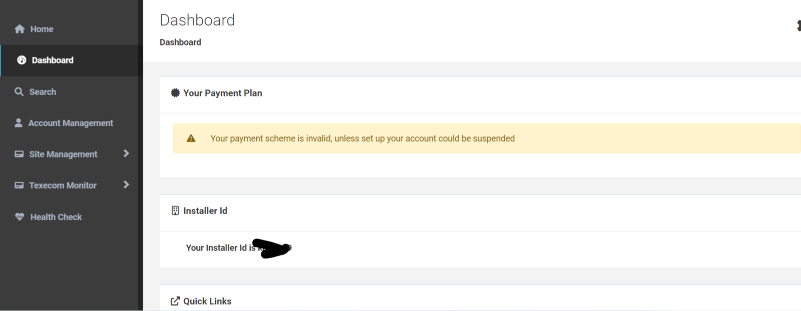

I'm a little stuck on the smart com bit, I've configured the panel for smart com and its generating the app code without any issues.
When I come to login on the mobile app I seem to be getting an error every time - 'Response from comms was null'
Any ideas why this would be? I generated different code but same issue each time, power cycled the smart com a few times.. no joy
Picture of the windows may help us suggest options.
Have you set up a cloud account?

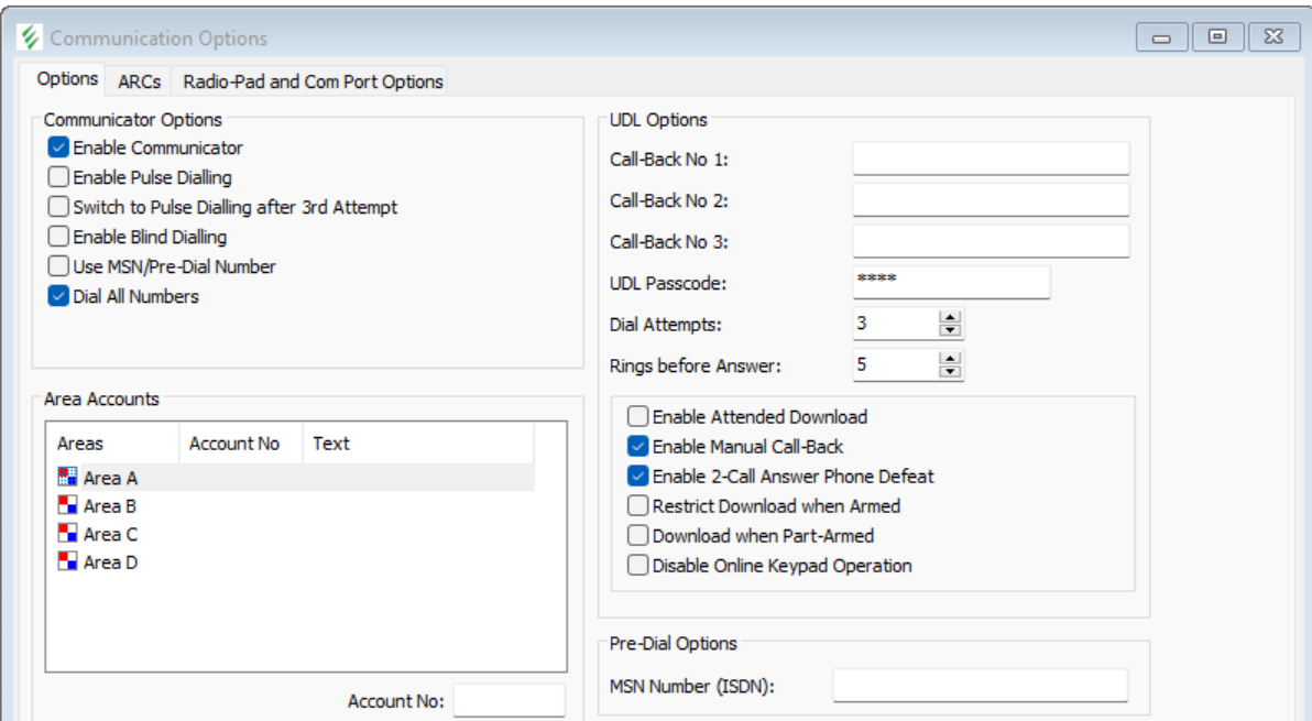

Hi Secureiam,

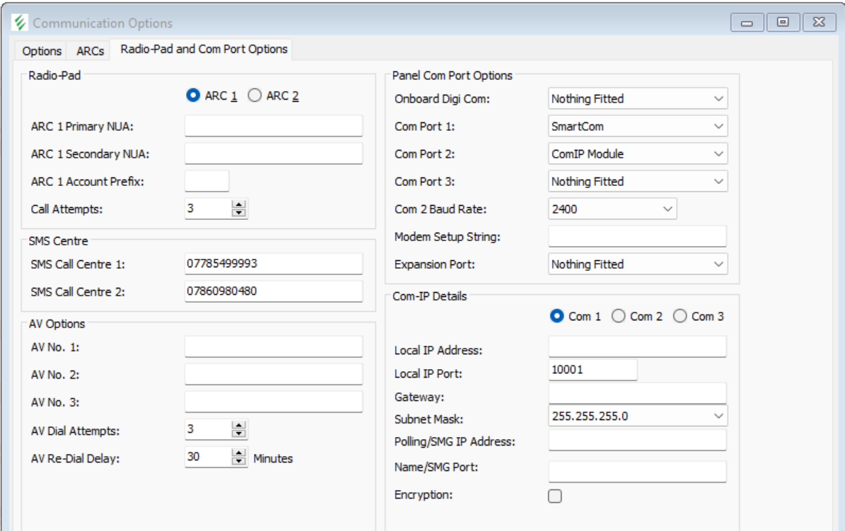

Please see attached pics, I used the USB cable to get onto wintex and uploaded config then put back the smartcom cable into the com ports of the panel.
The smartcom is hard wired with a ethernet cable
ARK 2,3,4,5 are all disabled..

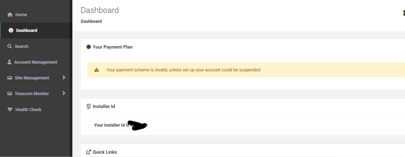

Yes I've setup a cloud account for as I need the ID, but I was also not able to get the smartcom to connect via the cloud portal neither.

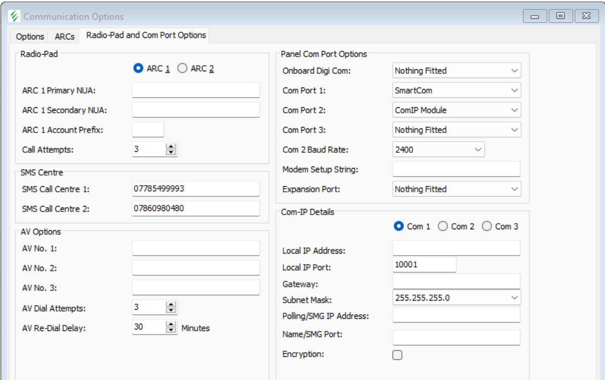

When you say unable, what did you do and what was the outcome.
1. smart com cable 4 wire connector on com 1 (how you have programmed it)
2. smart com 2 wire connecter on com port 2
3.Com port 2 baud rate up to 19200
cloud requires app code plus engineers code to connect.
If your still struggling then you will need someone to do this for you and trouble shoot as you appear to have the basics covered.
Hi,
I meant I got the same error when I tried to register via the cloud portal - 'Response from comms was null'
Yes the 4 wire cable is plugged into com port 1 and reads Smartcom on the keypad
2 wire cable is plugged into com port 2 which reads ComIP Module on the keypad
Ah the com port 2 baud rate is set to 2400. I'll change this and try 19200.
Also the smartcom fireware is V2.01 R17 and has never been online since purchase 2 years ago, I read on another post that Texecom have pushed a firmware update and the ones that were offline got left out and they are basically duds... do you know if this applies to V2?
Sorry unable to pm you but contact Texecom they may be able to help with a replacement but unit is out of warranty
Got it thanks for your help.. I've emailed them so will see if they can send a replacement or I'll buy another..
Hey Guys, so Texecom sent me a new Smartcom device V4 and ive managed to get it working straight away.
