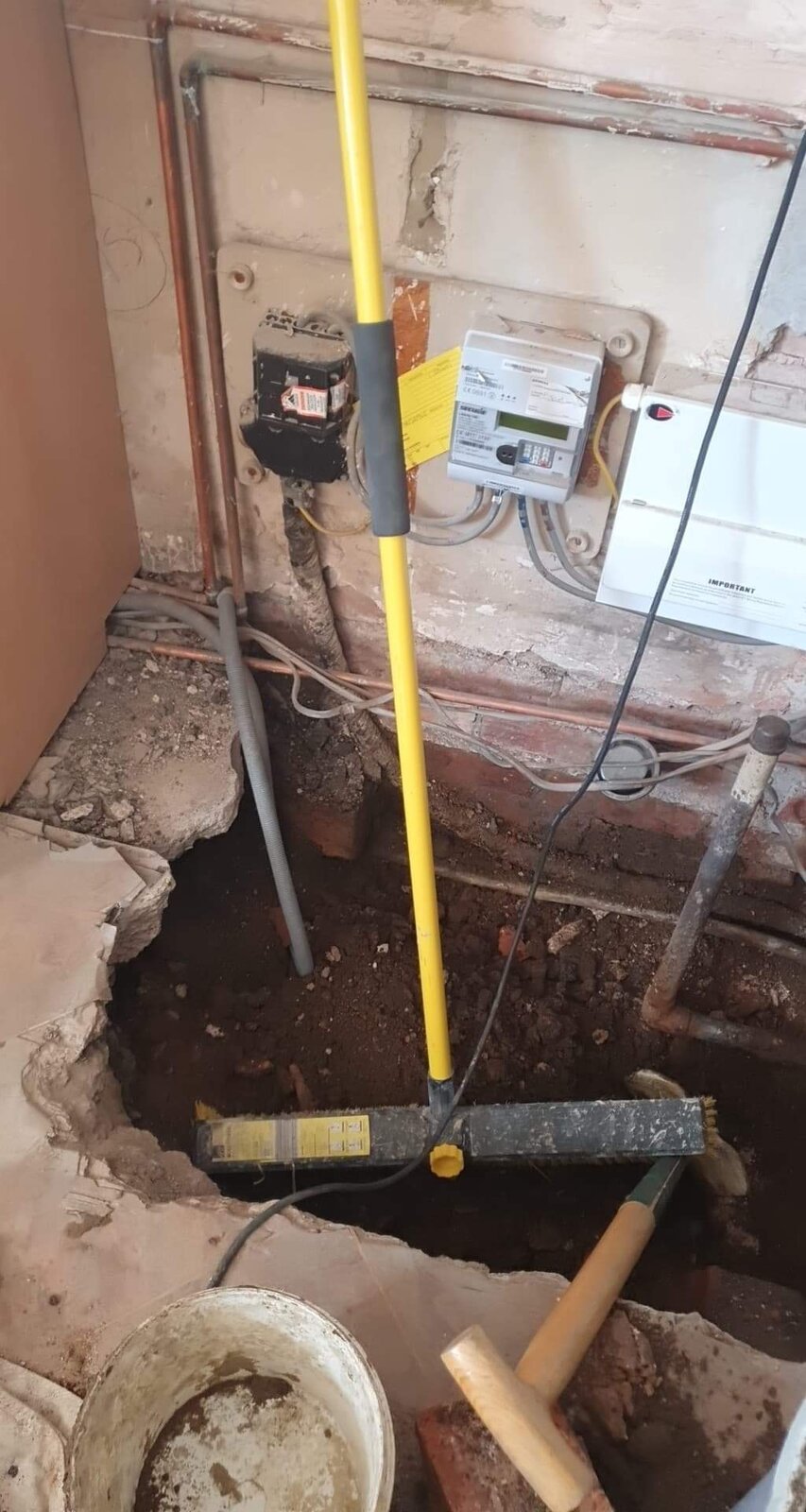

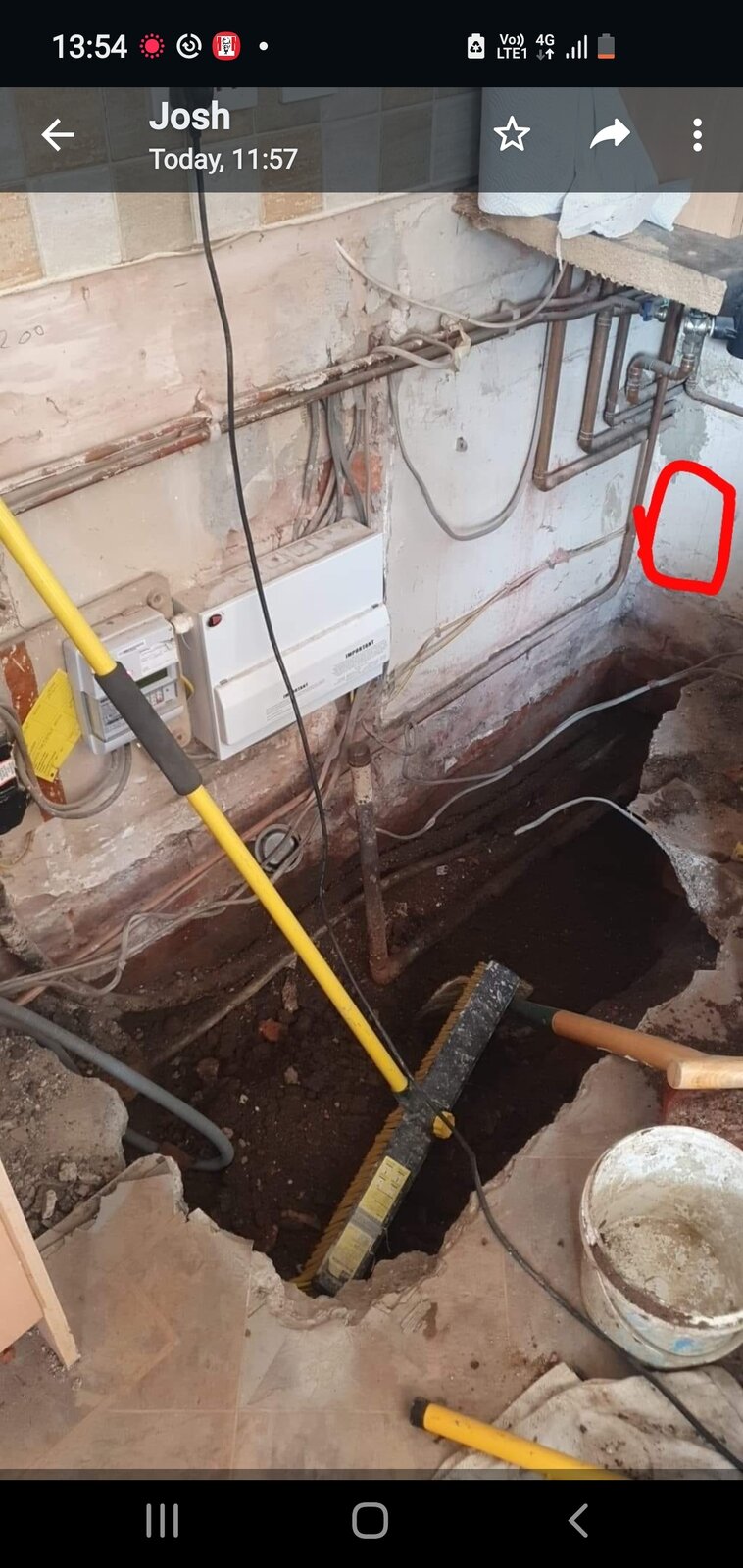

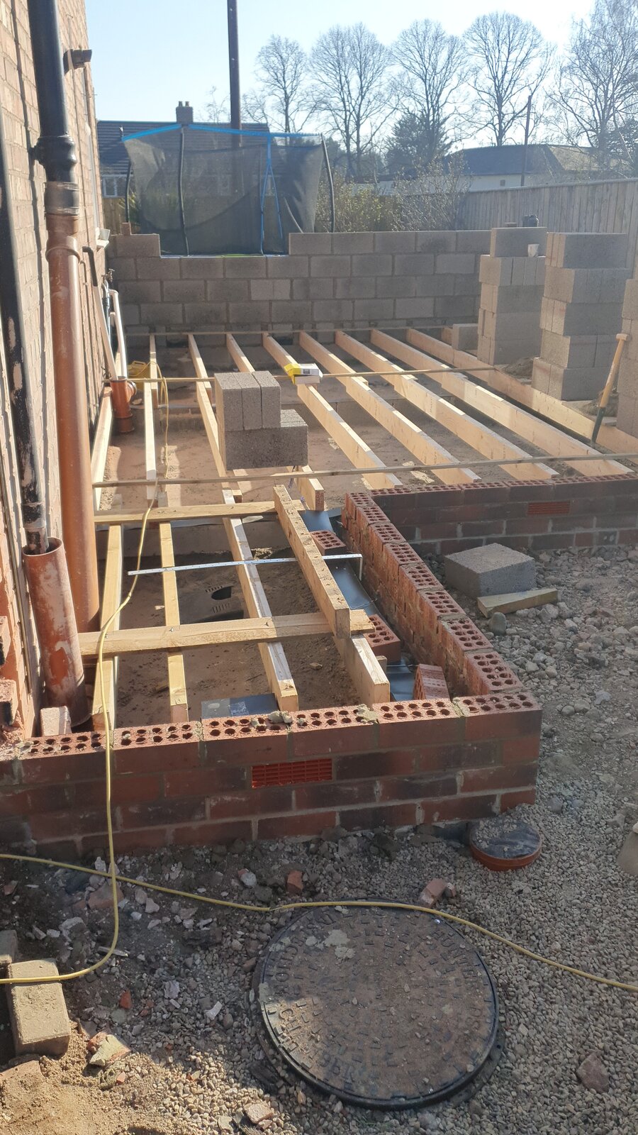

I need to move my electrical supply and my understanding is that the joint has to be made outside, 1 picture is of the existing supply and where I'd like it moved too and the other picture is a suspended timber floor which I'm wondering if they'll be ok to run the cable under there

Probably but the only definite answer will come from the DNO (pretty sure that's non-contestable work). Hope you've got deep pockets :)

I've had a quote from NPG via a utility company to do the works , waiting for a survey next week...the cable is just laid there exposed and it's so tempting to carefuly manoeuvre it round into the new position but the consequences if it goes pop are making me have my sensible head on!!!!
At least it goes past the area where you want it to be re-terminated. Shouldn't cost too much, not sure what sort of figure they charge for that type of rework though.

If they can joint inside it's to move 3 meters and you are looking at 650 quid inc vat, if its too joint outside then about 800 as it's further to run the new length of cable, i guess the survey is too make sure everything goes smooth on the day and there is no nasty surprises and also to check to give a more accurate quote as everything may not be as the customer described when they asked for an online quote

Where does the suspended floor come into this?

My understanding was that A they won't manoeuvre the cable to make a loop in order to relocate the cutout and B they won't do a joint in the house, therefore the joint would need to be outside so that's where the suspended floor comes in as that would be my most direct route to get back to the new location, if they can simply move the cut out then I'm guessing they'd isolate it, move it, dead test it and re energise it
Fitting a new cutout is done on a daily basis, I can't think of a reason why they would want to terminate a cable in a cutout and run that cable elsewhere, then cut into a live cable and make a joint. It seems like work creation to me.
I've witnessed cutouts being moved and leaving surplus in the floor void or buried several times.
I remember reading some documents from one of the DNOs that said they would only allow a head change to be done live if it was a single phase head *AND* was fed with modern cable. If the head was 3 phase or was fed with paper insulated cable, then it would have to be changed dead and in most cases that would mean cutting the service cable to make it dead.
Live working has it's risks of course, but I presume they think they can control the risks better with a standardised cutting/jointing procedure in an outdoor pit than with an old cutout in a potentially confined indoor space
And if they are going to cut the service cable anyway and are going to move the head anyway I can see why they might want to update the cable as well.

Hi just an update, they won't joint inside , and they wont manoeuvre the cable to position I'd like, the cutout has to be on an external wall inside or outside so I will be having a recessed white box on an external wall somewhere with the smart meter and a metal clad isolator inside then a SWA back into where the DB is , nevermind ha
Every intake re-site I have witnessed has been a case of digging outside. Isolating the supply. Fitting a new board/ cutout in the new position, fed with the appropriate PVC cable.
Jointing old with new outside and refilling hole.
