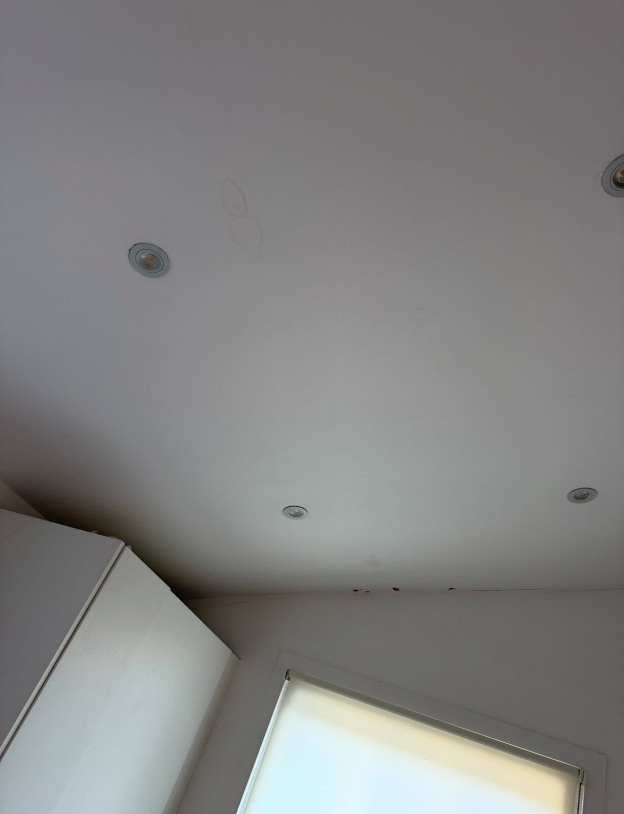

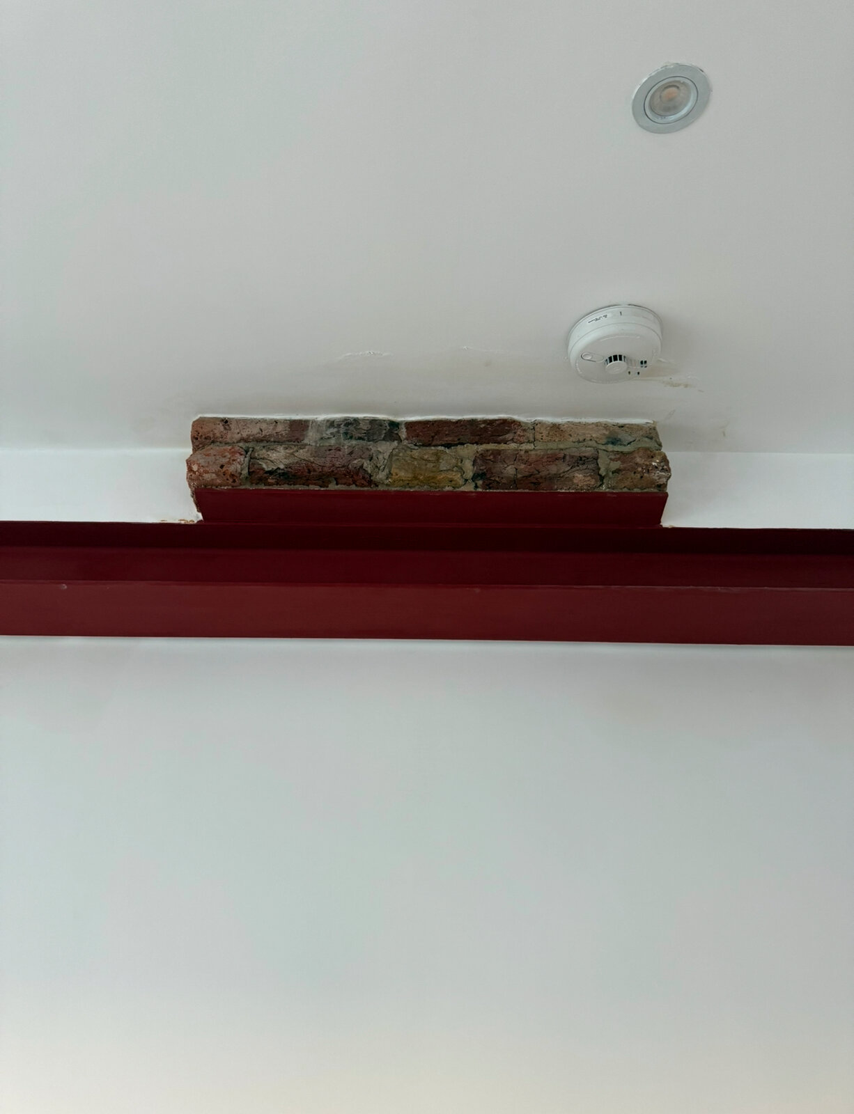

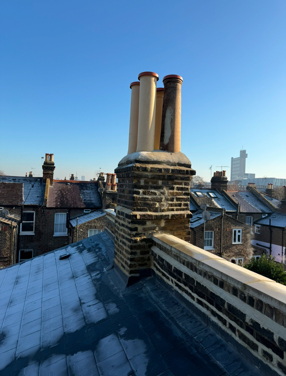

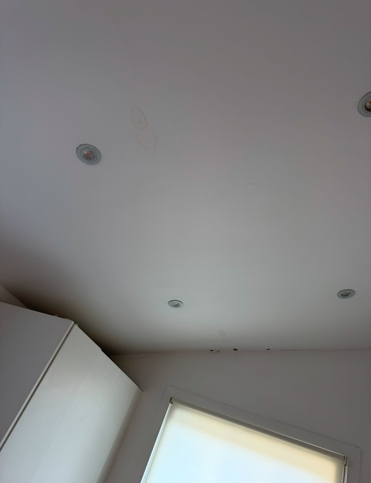

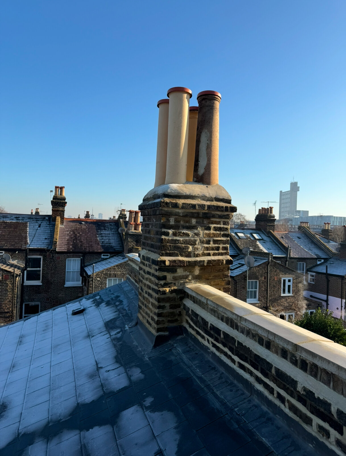

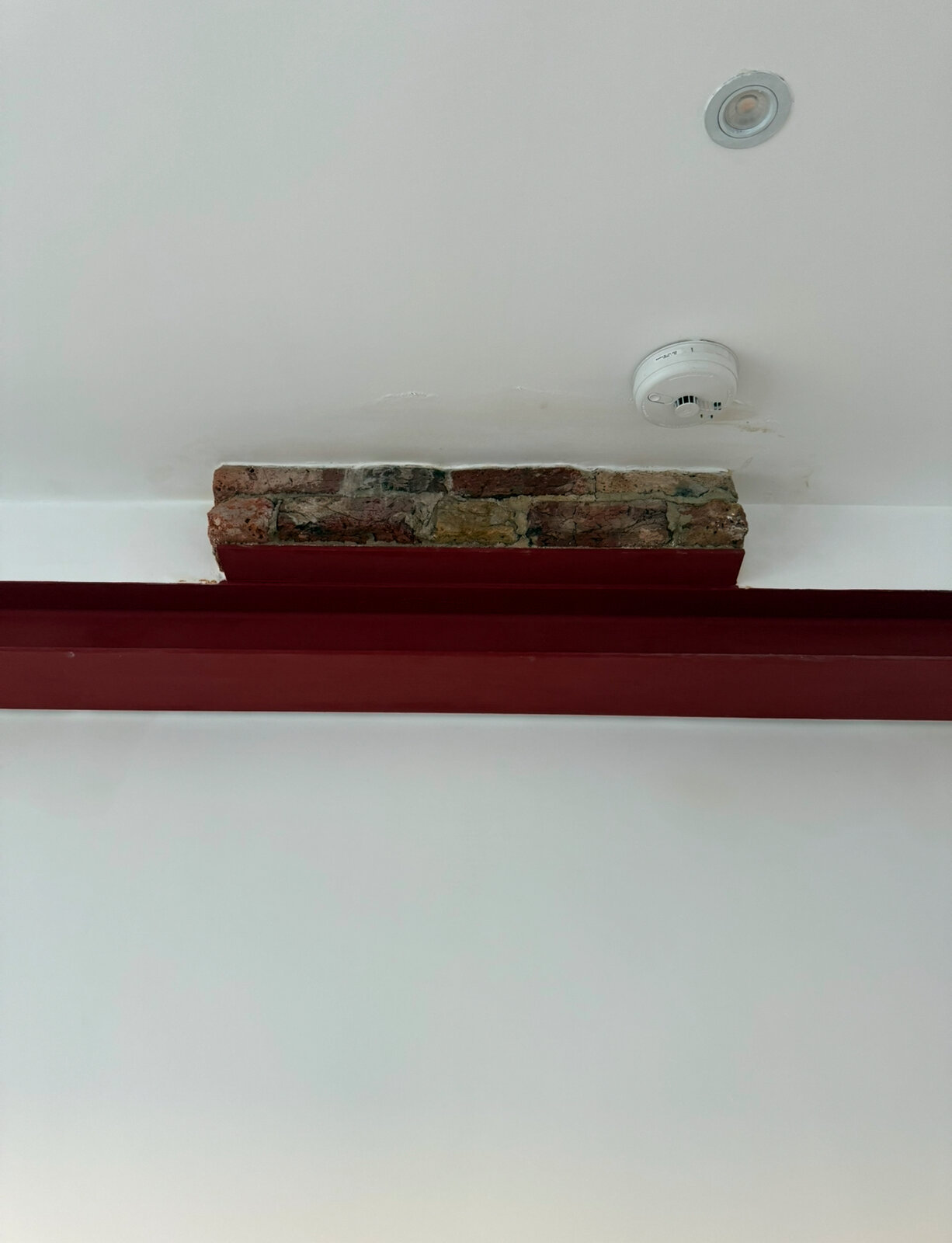

Hey folks, I have a somewhat similar problem, so thought I would ask for advice here.
I have a chimney stack that goes through the roof. Bits of it are visible internally. The chimney breast has been removed (see pics attached).
I previously had issues with leaks through the chimney stack, but it has been repointed and capped properly, so there are no leaks when it rains.
It’s been frosty for the past week or so and I’ve noticed new wet stains on the ceiling.
Could it be because there’s no ventilation at the bottom of the chimney stack? Or is it something else?

Which ceiling is showing wet stains - a pic please?
Why not show a pic of the chimney breast on the floor above the RSJ?

The caps on the chimney pots are for redundant flues so you presumably dont have any active flues?
The lead flashing on the chimney stack & parapet is wrong.
Have you been into the loft & examined the chimney breast for moisture stains?
