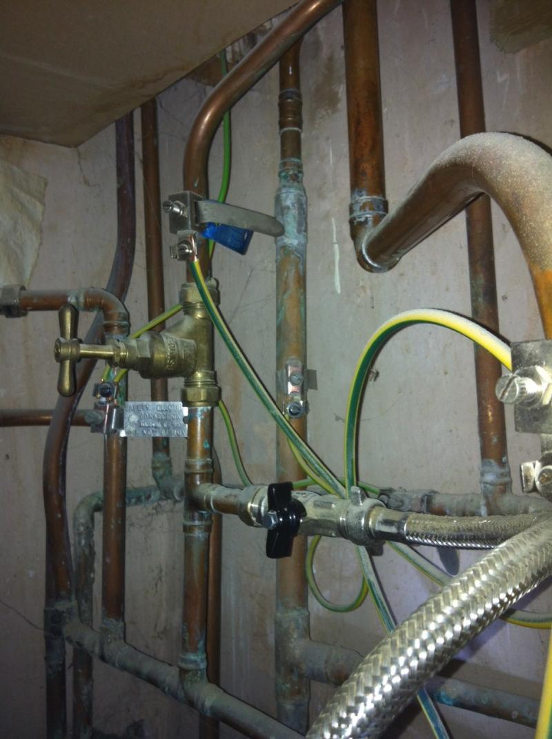

Hi I have looked under my combi boiler in the kitchen which is in the room next door to the bathroom. There are some earth wires that look to me like supplementary bonding, but I am no electrician. Picture is attached of pipework under my boiler behind a kitchen cupboard.
Does this mean I already have supplementary bonding? Am I already protected?
No sign of an RCD hence supplementary bonding is still required, providing of course your pipework is metallic.
Main bonding is also required for metallic pipework such as water, gas etc where it enters the building.
Yes pipework is metallic, I am assuming main bonding is already in place?
Can you do a shot in focus with a wider view?

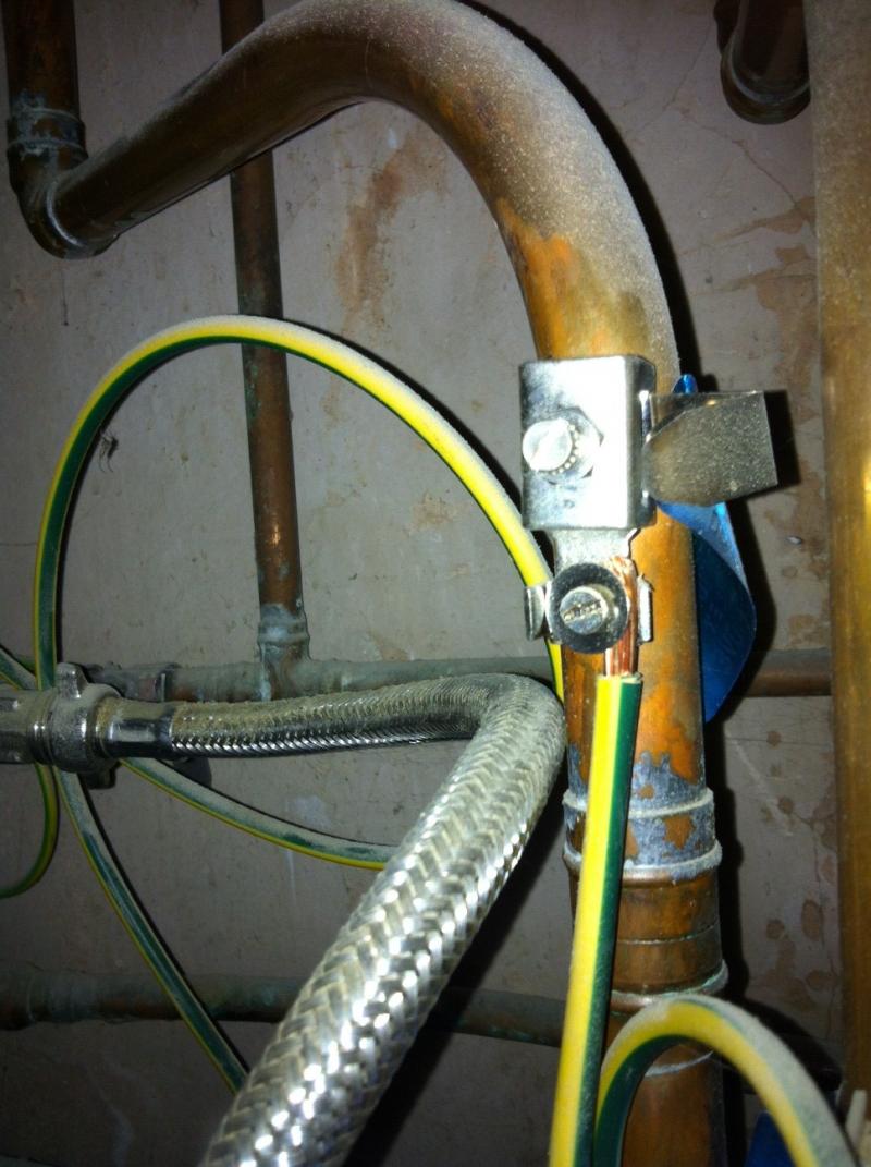

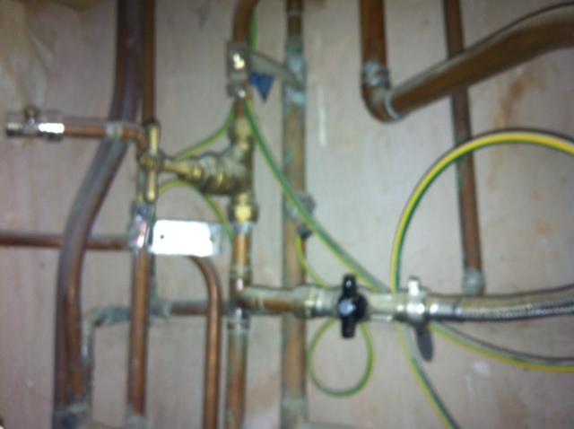

Hi pic one is main photo pic 2 is close detail just left of pic 1.Pic 3 is where the pipes enter through the wall to the bathroom
These are the pipes directly under my boiler I cant get a wider view as the picture is taken from inside a cupboard. Is this clear enough?
The bathroom is located on the other side of the wall to left of image

I take it that it wasn't an electrician who installed those clamps, the aluminium warning labels are all over the place (and look to be in places they shouldn't) - dissimilar metals react!
The core needs wrapping around the terminal screw at least, not just shoved down one side - the right-hand side at that !!!! :roll:
They need wrapping around in preferably a clockwise direction, so there is less of a tendency for pushing out.
