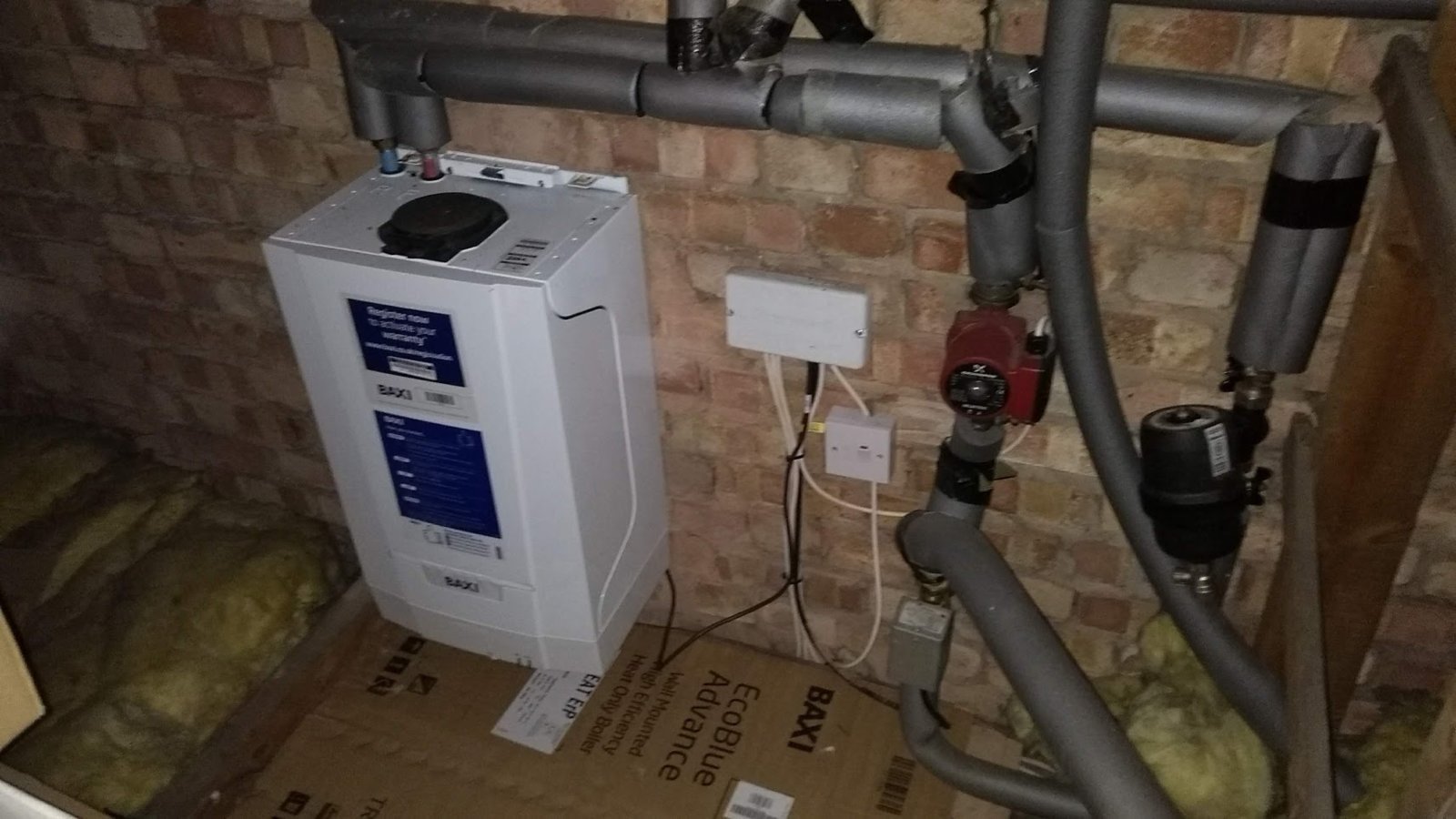

New house has a boiler in the loft, new in Jan 2017. Not been serviced yet ...

New boiler is in the loft too. I've probably just opened another can of worms! It's not a combi.
Was installed by a local heating / plumbing firm. Then had the flue changed by a Gas Safe guy when the extension was added behind this wall (exhaust now goes up through roof)
and was signed off by building control.
So plenty have seen it, nobody said "OMG your boiler is in the loft!".
No felt in the roof (1930s house) so well ventilated. Didn't stop working when it was -5 winter before last either.
The problem with putting boilers in the loft , is that if there is a leak anywhere and it is a sealed system then the boiler will cut out as it is the highest point in the system, there are regs about putting boilers in lofts to ensure the safety of any one working on the boiler, personally I hate boilers in lofts but it is sometimes the only reasonable option
