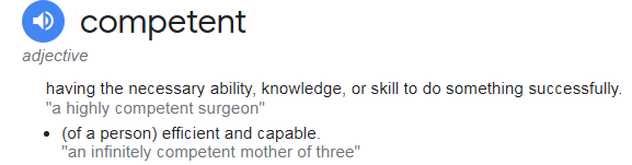

Competent person. A person who possesses sufficient technical knowledge, relevant practical skills and experience for the nature of the electrical work undertaken and is able at all times to prevent danger and, where appropriate, injury to him/herself and others.
After 2008 competent person was dropped. Maybe to avoid confusion as Part P brought in the competent person scheme, but it seems Skilled person only looks after himself, where competent also looks after others.
Skilled person. A person with technical knowledge or sufficient experience to enable him/her to avoid dangers which electricity may create.
That could be the explanation but, even before 2008, I don't really understand the difference between "skilled" and "competent" persons per those definitions. If a "skilled" person were able to "avoid dangers which electricity may create" would they not also satisfy the definition of "competent person"? Although you go on to say ...
....but it seems Skilled person only looks after himself, where competent also looks after others.
... I see nothing in the above definition of a "skilled person" which restricts the avoidance of "dangers which electricity may create" to dangers which only affect the "skilled person", do you?
Kind Regards, John
Likely why it was dropped, but it seemed to be a question often asked in the exam.
Agreed. However, there was, in practice, another issue. The previous definitions (which you quoted) give no real indication of how one was meant to decide whether a particular person was "skilled" or "competent", given that the definitions were so similar!
... not to mention, of course, the fact that the word 'competent" has a very well-established 'everyday' meaning.
