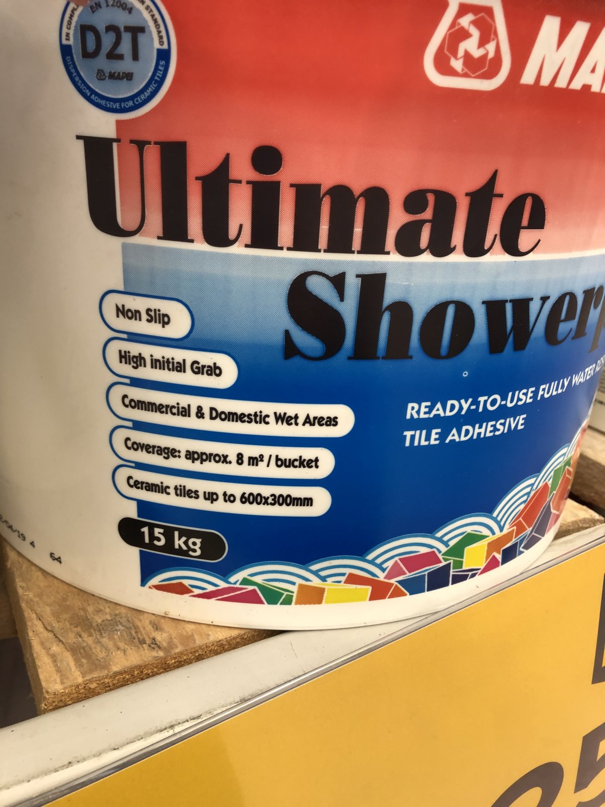

Hello all. I’m going to tile with 250x400x7mm tiles. Half way up the wall (or there abouts), I’m going to put a 100mm strip of mosaic tiles horizontally. It’s concerning me that as these mosaics are on a web, the tiles which go above them may compress them together if there is any slippage , then the tiles and the mosaic would be misaligned etc. Is this a concern?
Secondly, has anyone used the attached adhesive to good effect or should I use a powdered quick dry?
Thank you

I only use powder adhesive for mosaics, and larger size tiles ( including the size you refer to ).
