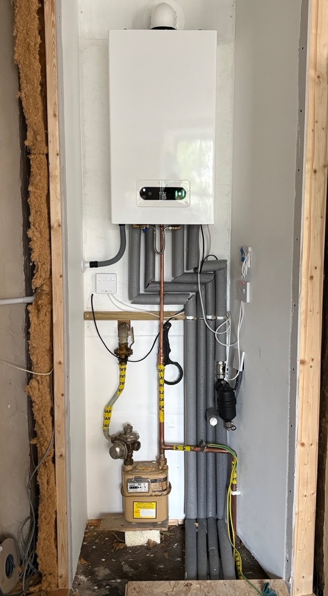

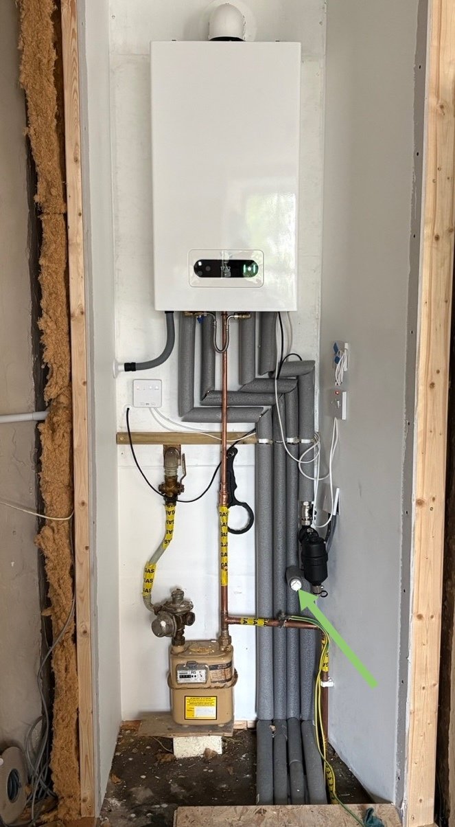

Well here it is, share any observations if you want:
Please forgive the dangling cables; I've said I'll tidy those up once some other things are done. There will be a shelf where the batten is. I am surprised by the lack of strain relief in both the boiler connections (opentherm and black wire to weather sensor) and the EPH receiver. Is this common?
Copper pipes and press-fit fittings are hidden under the insulation. The guy who did it was proud of his pipework and when he asked whether I wanted insulation all the way up to the boiler, he seemed disappointed with my reply of "no reason not to?". Again I will tidy that up in due course.
Currently it is only connected to the two living-room radiators (see my thread in "Projects", https://www.diynot.com/diy/threads/insulating-my-ancient-living-room.648034/) and they've been briefly tested. I have, however, tested the hot water and I got my best shower for a few years!
(Edited to add: what do you think I (should have) paid?)
Main earth bonding is after the branch (Tee) and as you say wiring needs tidying up. Other than that seems ok
Right; as you can see there is no opportunity to fit it before the branch because they put the tee so close to the meter.
Previously there was an undersized cable; I had run a new 10mm cable from the CU while I had the floor up for them to connect. Then they left without connecting it, so I did it.
I've just found a drip from the mag filter connections... which seem to be full of LS-X.
I wouldn't trust this...
See the mag filter spanner? It is hanging on a pipe coming through the wall from an outside tap. Your arrow points to a push-fit stop end on the cold mains which will be connected to that, via an isolation valve, non-return etc. That was my request.
Note how they’ve mounted the boiler slightly off-centre so that the gas pipe can run vertically - but awkwardly close to the outside tap pipe. And how the stop end and its tee are awkwardly close to the mag filter’s lower valve, which is the one that seems to be dripping.
