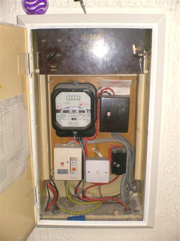

Doing works to the house at the moment and need to replace a couple of single sockets with doubles and install 1 extra socket. However don't know if we actually need a rewire. The fuse box has a thin red and thin black wire and an earth wire and some grey cabling. I would prefer not to go to the expense and hastle of a full rewire but anything I do to the house now I want to last for the next 10 years. We don't seem to have any problems with blowing fuses or anything.

To be more specific, we need all these details, and ideally that picture. If it does all you need, and looks reasonably modern, its unlikely to need a full re-wire, but it might still be a good idea to get someone to quote you to give it the once over (professionally called a 'periodic inspection report) if you are really worried.

I would say that that is definitely due for a re-wire.
WHAT are those tails feeding the box next to the meter????
They are not kosher - look like 2 x 2.5 twisted together.
Plus, the cabinet your fusebox is mounted in will make fitting a replacement awkward at the least, due to the skinny width.

More to the point WTF is the top bit that says fuses, with an on / off switch.. plus cables in bottom left corner.
David
My guess is that that's where the fuses are, and that the on/off switch is the main incomer for those fuses.
The rest of the stuff is obviously later additions.
Yes, that's the fusebox.
It is supplied as a complete unit with a metal case, door and a combined fuse box with ceramic fuse carriers and a rotary isolator. It is rather elderly, and cramped for retro-fitting modern units, so most people have them removed and recess a larger cupboard into the cavity to be able to accommodate what they need.
It isn't a small job, though, as you have to get the REC DNO whatever to re-jig the incoming supply.
So which of these wires do we think are the incoming supply then? - I can't see anything I'd really like as an incoming main (i.e. nothing beefy)!

I'd suggest, having seen the picture, that at least as soon as anything more needs adding to the fuse board, you should budget for it all to be changed -it reminds me of the worst kind of "church hall" installations, where things have been added over the ages by people who never met each other, each working in a different style, but nothing ever taken away.
Hopefully some of it is redundant, and can be switched off without the loss of anything critical, but that would be sadly unusual. :confused:
When it is changed you will probably end up with a new cupboard and box on the surface in front off the old one, or else a new hole along side this recessed cupboard (and a lot of brick dust while the hole is made)
You might like to identify what goes off with each switch (and if really brave which fuse in the upper box) if only for your own reference.
