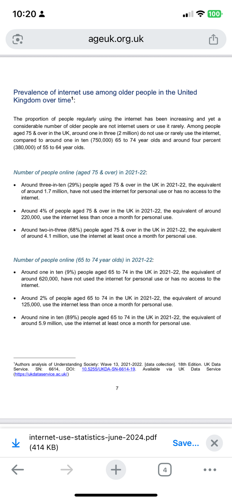

Many people can't easily decipher this though. Last I read, about half of over 70s are still not online. Also, the average reading age for elderly people is about aged 9,
That's interesting. Where did you get this information?
