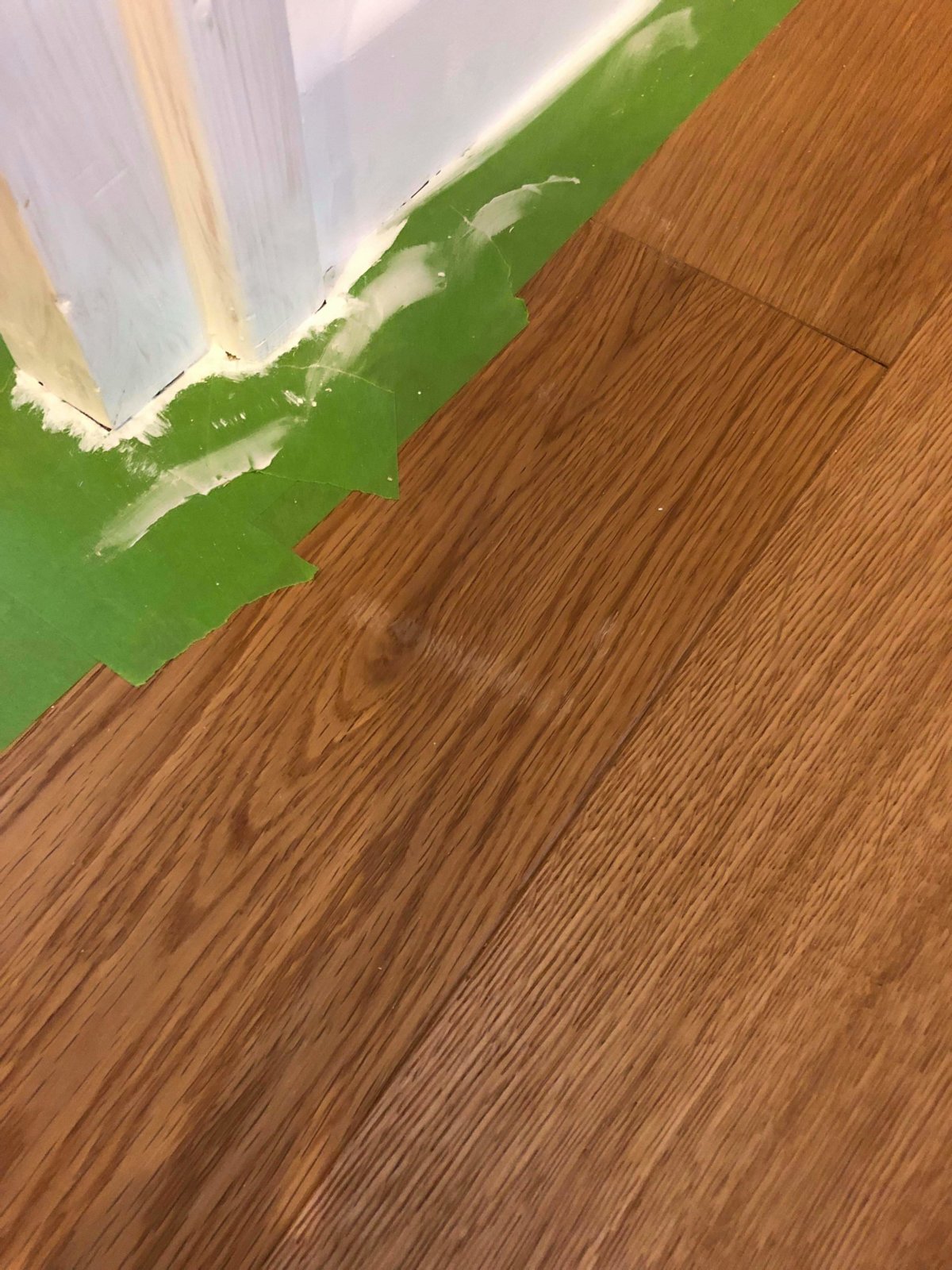

First problem is, we have newly installed oak flooring, it was a decision we made to have it laid prior to decorating as we wanted the skirting to be laid after to eliminate scotia, also again time run away and i didn't get round to paiting anything else as planned, prior to the floor going down (it was booked in with a local very reputable company, that had again along waiting list).
Anyway I thought this would be a problem as I'd protect it throughout painting.

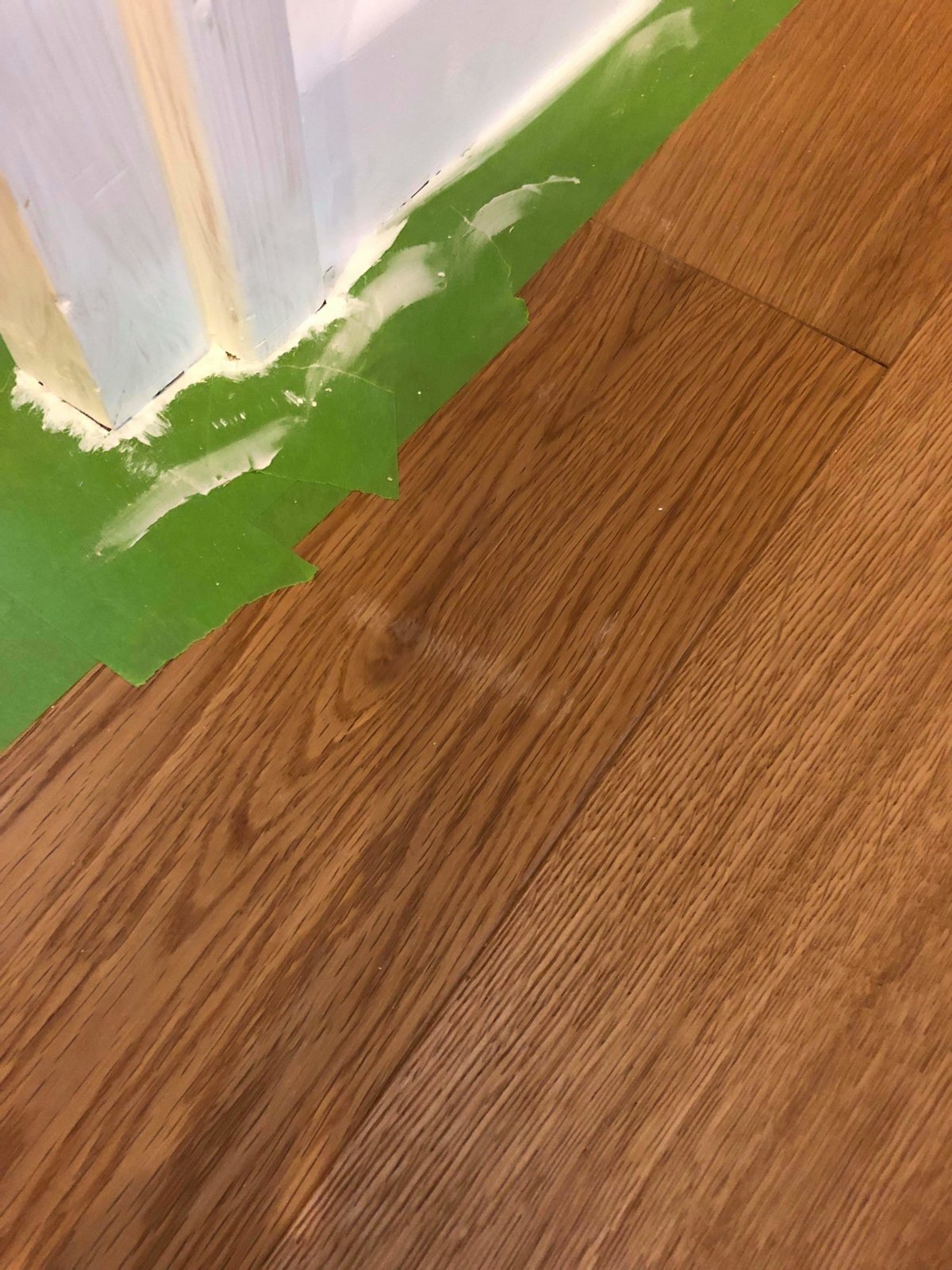

Wellllll..... the decorator hasnt shared the same logic and has not bothered to use dust sheets, he has used the good olde frog tape around the edge of skirting and floor but no protection to the floor, paint has ended up on the oak flooring and when pointed out by my missus he has decided in his wisdom to use a STANLEY BLADE!!! to scrape this off. This ofcourse has damaged our flooring. He has agreed to pay if necessary to have this fixed. but I just dont understand the logic. When questioned his main response was we should have had it laid after decorating ! Surely this shouldn't matter as what if this was a standard redecorating job or worse a 100 year old piece of historic flooring you cant just say oh well not my problem should have ripped it up and relaid it after I was finished. (See photo)

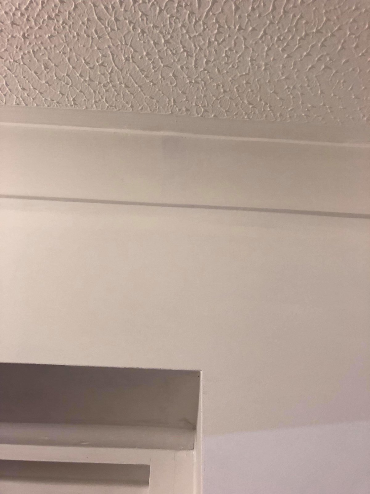

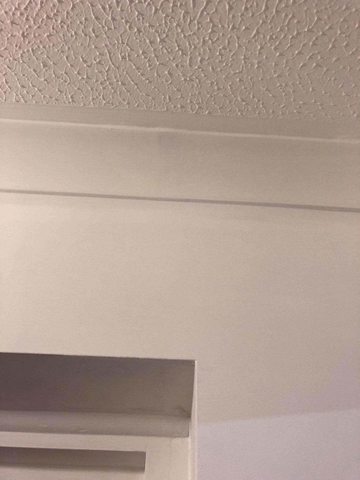

Now I have come home to find he has painted only one coat on the ceiling and there is still clear mark's coming through the paint where I had previously prepped. dont get me wrong it's as he quoted, 1 coat. But he hasnt said " I think itll need another coat as it's not covered as well as I'd have thought it may cost a bit more and take x amount longer" or something similar (See photo) surely you cant just think well I only quoted for one not my problem it looks ****e.

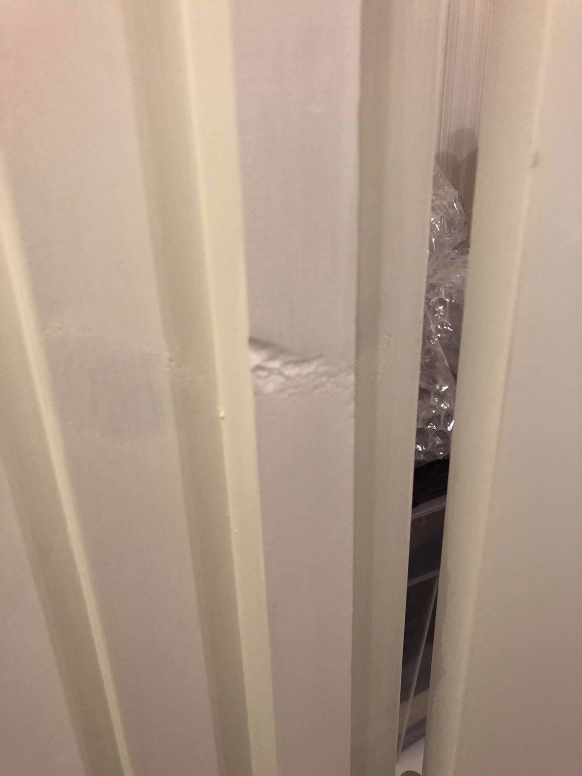

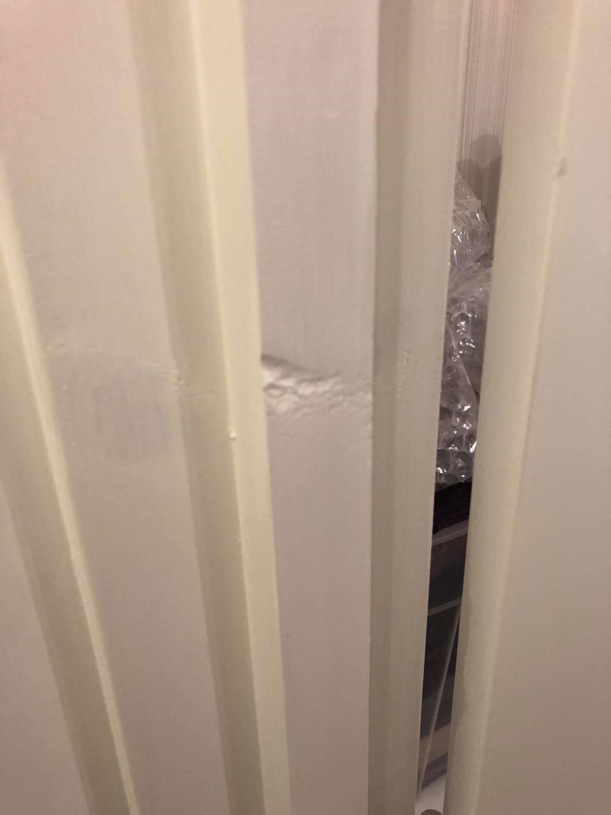

Then I have had a look at his priming and under coating on the woodwork and have come across this mark that was in the wood to start with (surely he is going to fill this!) Please see photo.

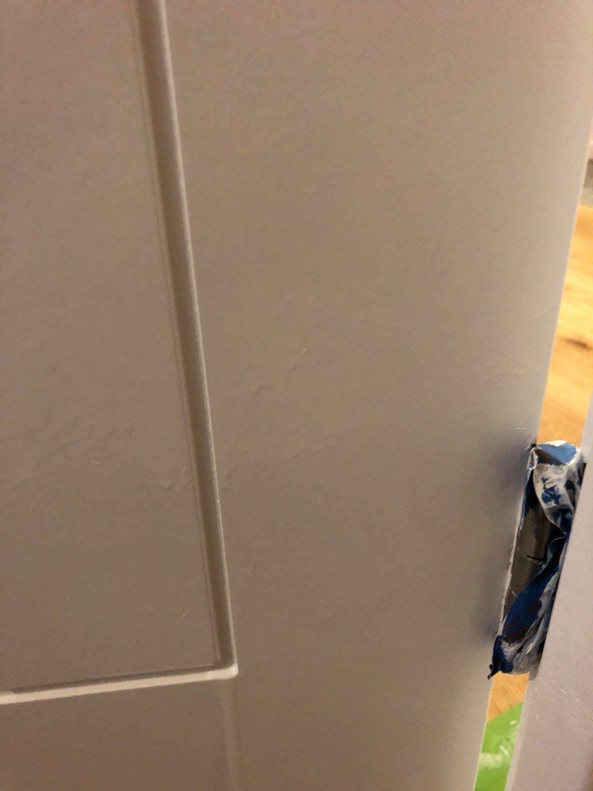

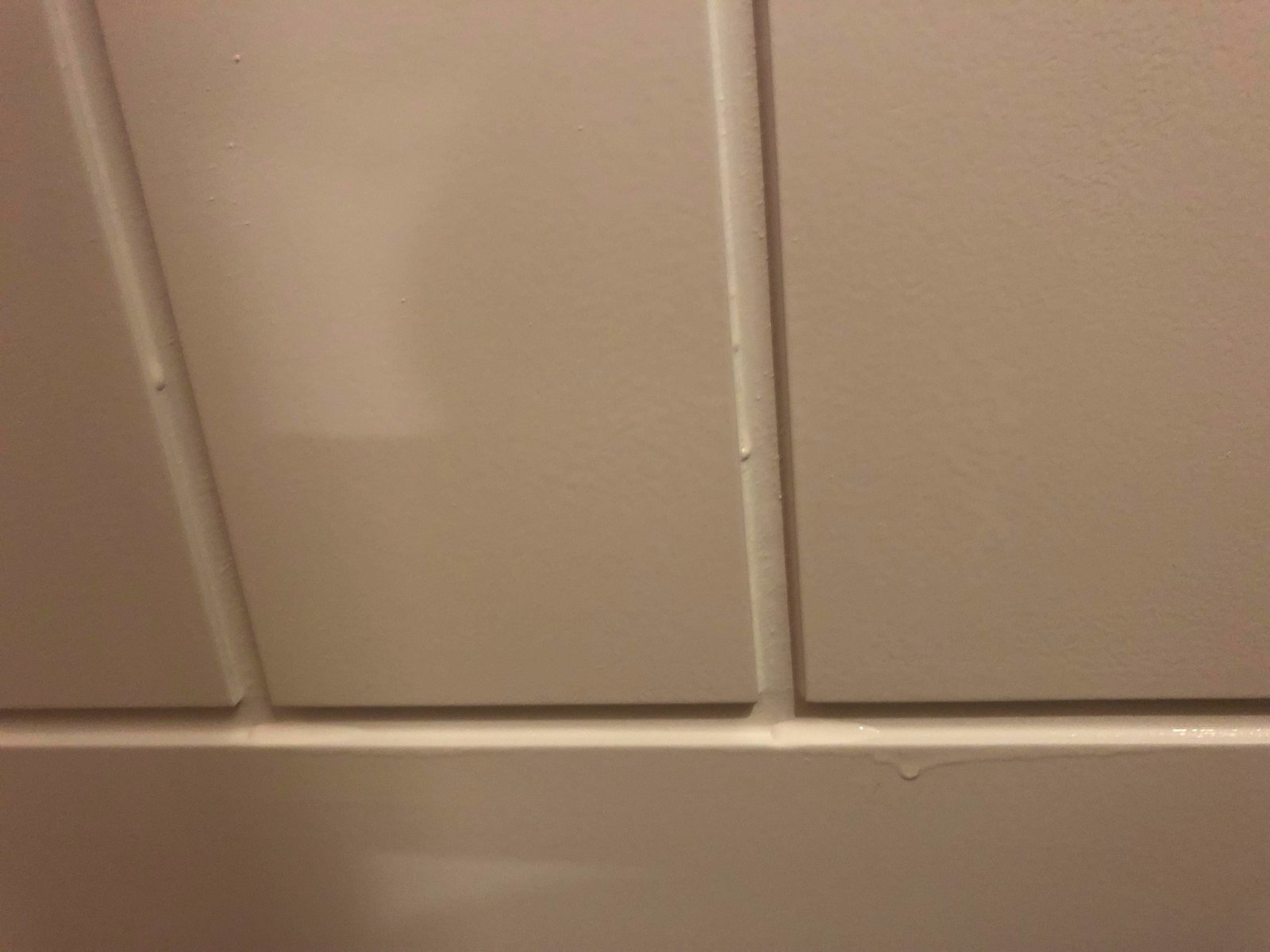

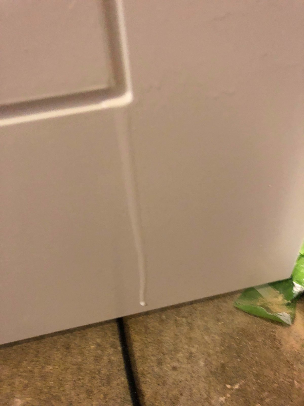

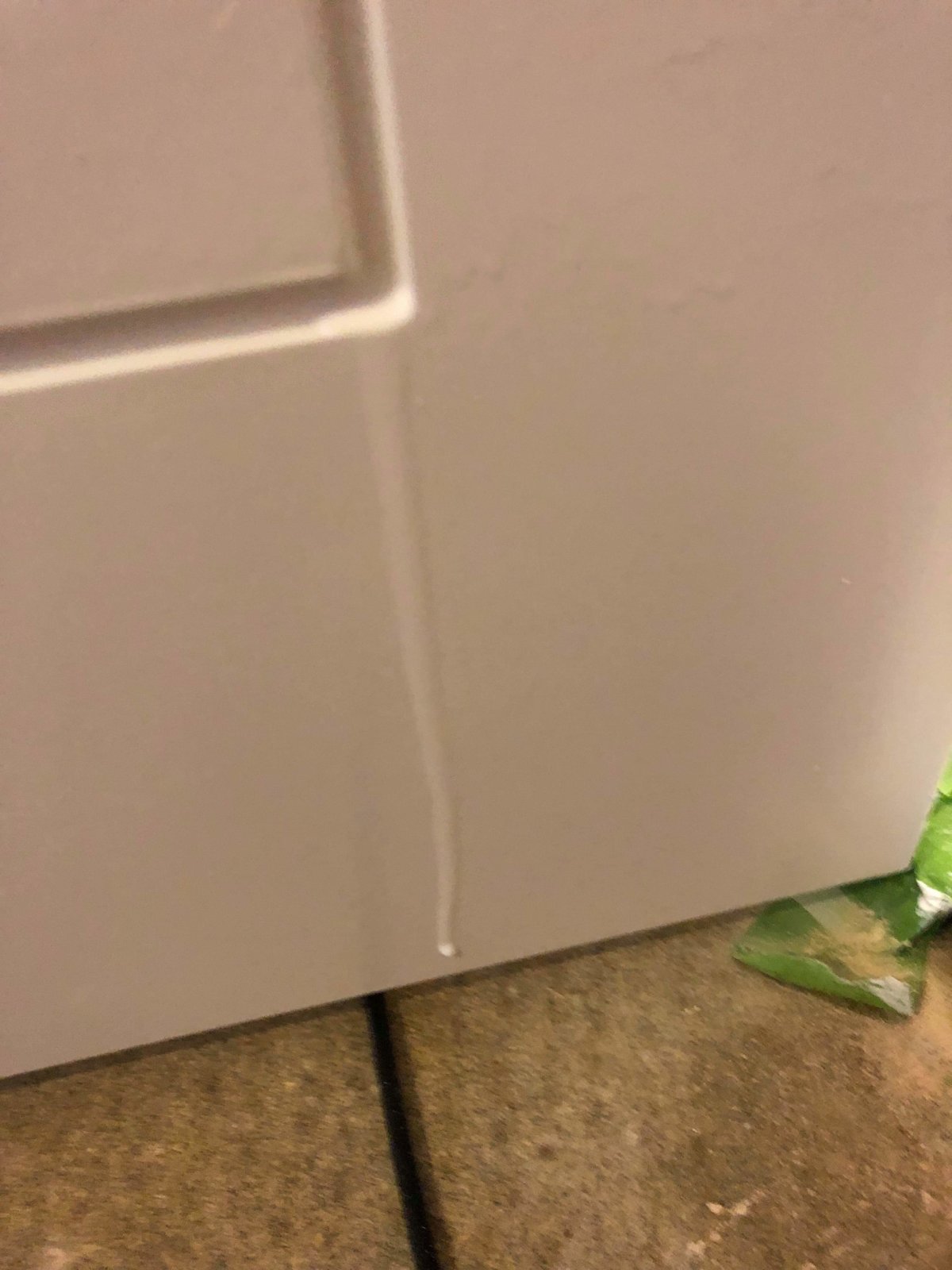

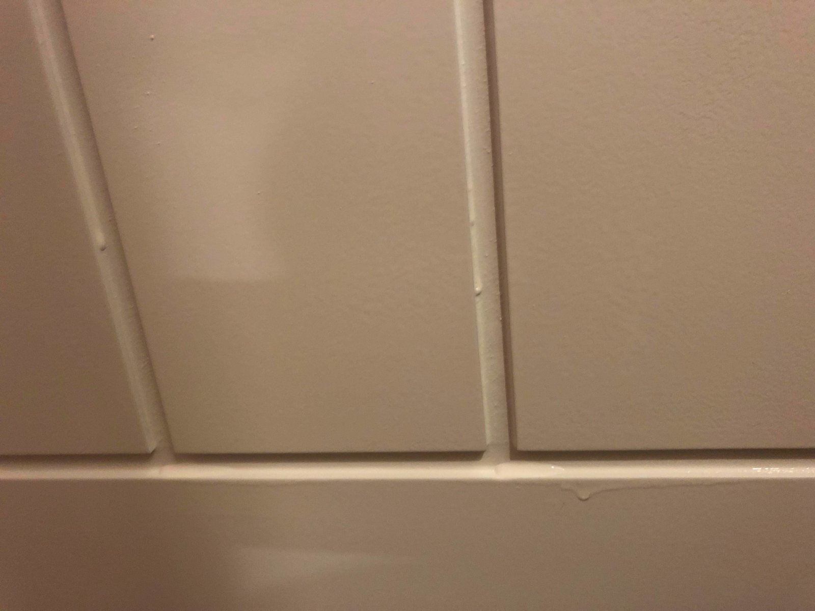

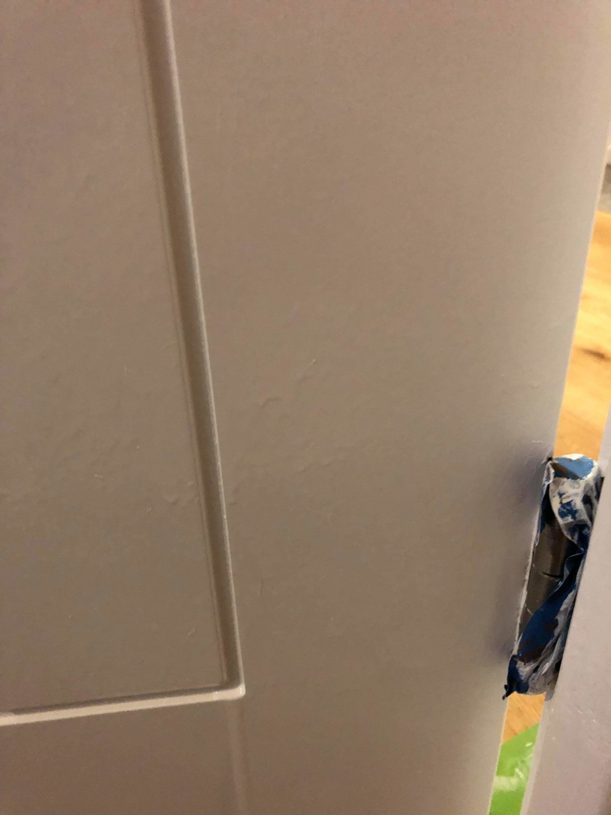

Thennnnnnn I have spotted a couple of the doors he has apparently finished painting, drips galore. Please see photos.

Did the quote state he'd fill any holes in the woodwork? It sounds like you hired him to do a list of tasks (i.e. one coat of this or that), rather than to decorate a wall or a ceiling. The latter to me would have him required to make good as necessary, but the former I am not so sure.
Either way I think he should have protected the floor, and the drip marks are annoying. For sure you can ask him to make these good.

AAAAAND, no decorator would ever use only one coat on anything.

Quote stated he would;
Sand, fill and repair any cracks and holes prior to priming, under coating and finishing. There are dents and holes all over the wood work and it doesn't seem like he has sanded the woodwork down to be honest prior to priming. trouble is I'm not sure if he has any intention of filling some of the holes in the wood work now that its undercoated prior to top coat. Again dont want to jump on my high horse for him to say well I was going to do that I haven't finished yet.

Ive been involved on many site jobs where floors are down but other trades are working, of course its possible, if not ideal.
In your situation floor protection is vital. Personally I wouldve bought some floor protection sheets -its thin correx board. It can be gaffa taped together and makes a good flat surface -its what pro builders often do, it allows boots to be worn and ladders wont damage floor.

A pro decorator would be horrified to see a run -they pride themselves on brush skills.
Top coat, singular?
If eggshell, which requires two top coats, you can get away with filling pin holes and (depending on the filler) two coats of eggshell will be fine.
