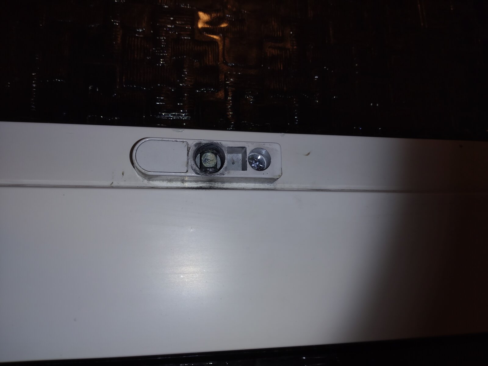

Does anyone know if this type of window handle is still available and if so where I could buy one.
13 Sep 2009
113
4
London

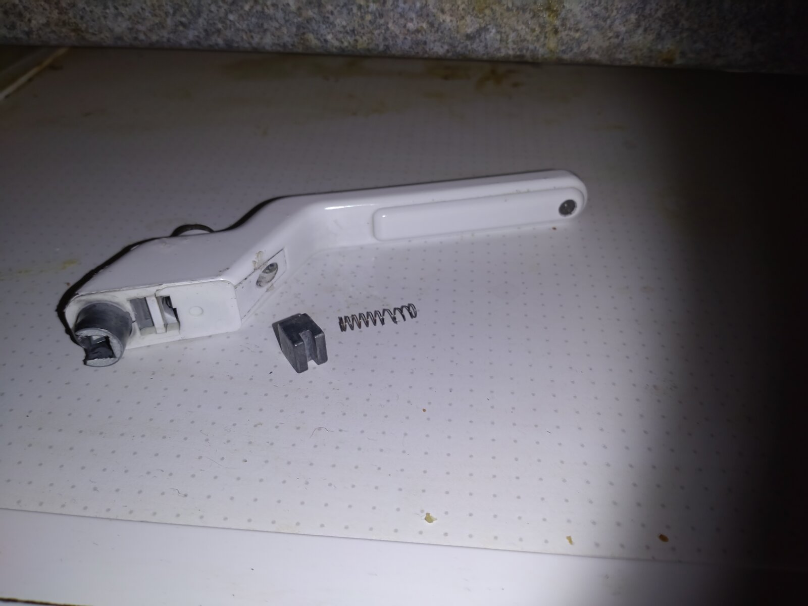

This window handle broke off. Does anyone know if there handles are still available and if so, where l could buy one?
Not an exact replica ... no , discontinued many years ago. Plenty of 'in line ' white handles on the likes of evil bay
Does this mean l can remove the part attached to the window and replace the handle with an in line handle and what do they look like?
Sorry for sounding like I haven't a clue what I need because l don't
Mila hero are pretty straight design
or look at ERA, Avocet, Hoppe etc
Do I just take off the part that's attached to the window and fix the handle?
Unscrew the two screws from the frame, replace with new handle in existing fixing holes. Msy need to cut spindle down, if so , hacksaw

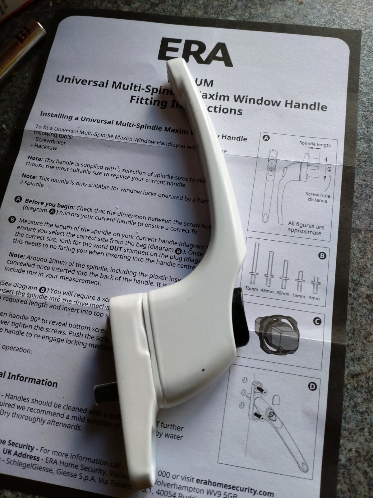

Bought handle but it won't move from its position. Handle isn't locked. Is it just faulty or am l missing something?
Make sure the button presses in, hold the back plate in one hand and turn with the other, new handles can be stiff but do free off
Thanks. Flaming heck, it was so stiff. I have arthritis in my right hand and it was difficult but it did move after some considerable force
