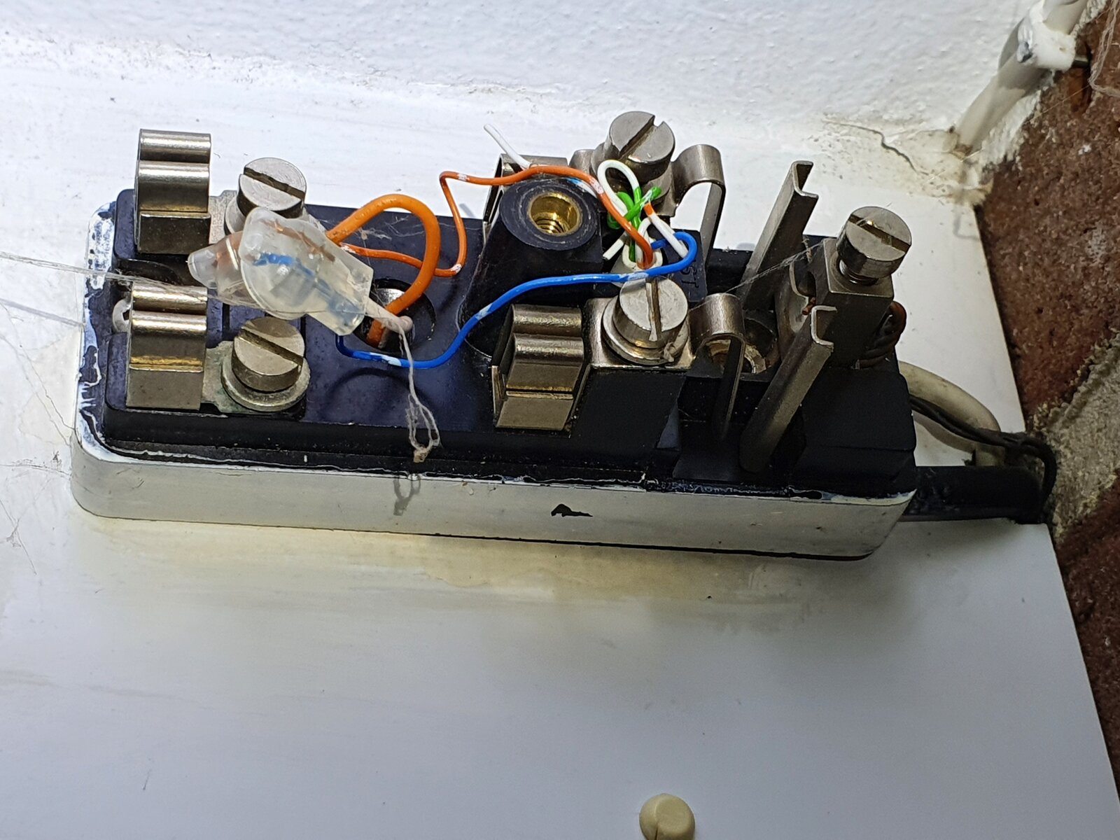

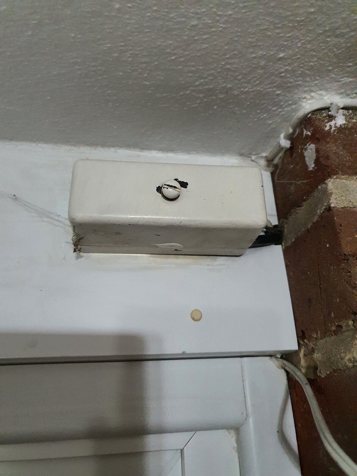

Hi all,
I have this bolted to the inside of my porch. I'm assuming it's an old doorbell but can't be sure?
Does anyone know?

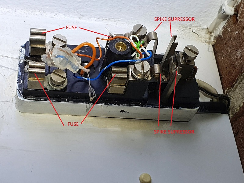

It’s a very old phone joint box, but has had modern Jelly joints used within it, rather than replacing it. It would of had blades in there. Not sure if they used to be fused.
The odd thing is the colours used. They’ve split the line over two twisted pairs.
It is telephone, but I have never seen anything similar before. It is in very good condition for its age, but the links are missing unless the links are mage by fitting the lid?

No, the line which goes from that box, to the telephone exchange - it will either be underground, or in the air and going to a telephone pole.

So bearing in mind that I don't need it currently, is there any reason why I shouldn't cut it? Do any of the cables supply power?
Should I call BT and get them to visit first?
Disconnect it.
Try and leave it so you could make use of it in future.
