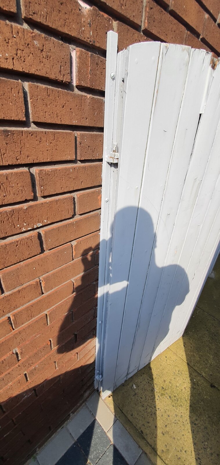

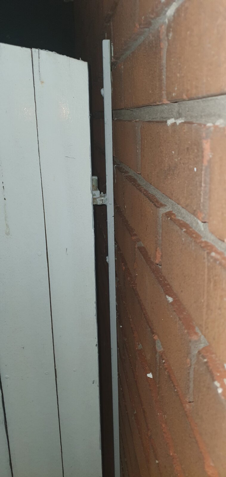

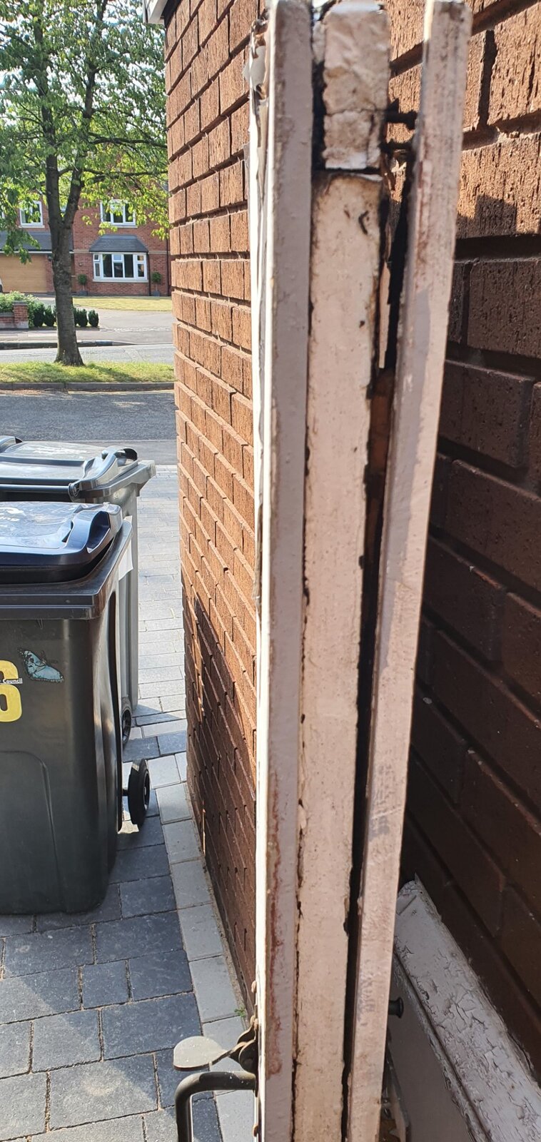

I am trying to replace a side gate - what should be a simple task, but I am stumped by the type of gate and fixing I have currently.
It is a wooden panelled gate, with 'finished' panels both sides and bracing sandwiched between the two panels. On the hinge side is a metal rail with 2 'eyes' that sit on 2 mounting pins attached to the wall. Pics attached will tell the story better than I can...
To make matters worse, the opening is 91cm from wall to post, so the gate itself is only 86cm wide (as I assume a standard 90cm gate won't fit).
I can't find anything like it to replace it with. I was hoping for something that I can just drop on the mounting pins that are already there. Everything I find is 90cm wide, only has the finished panel on one side and doesn't have the eye holes rail built in.
Has anyone seen a gate like this and does it have a special name I can put into a search engine?

That is homemade, to fit the size needed. It looks as if the made a frame, then paneled it of each side with ordinary T&G floorboards. Best to find one adaptable to fit and get a joiner to trim it down to fit, with new hinges, or buy a saw plus some treated timber and make one from scratch your self. They are not difficult to DIY.

I've just been back out there peeling away bits of it - I can see its a metal frame gate with the tongue & groove planks screwed either side (the bread if you like) to blocks of wood in the middle (the 'sandwich filling').
I guess as the metal frame is still good, I could fix it up myself with new wood either side without much difficulty.

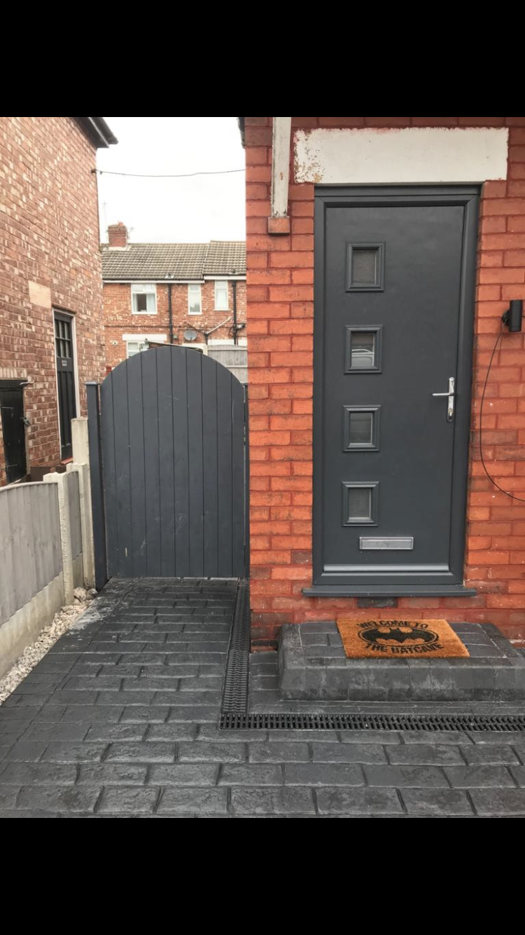

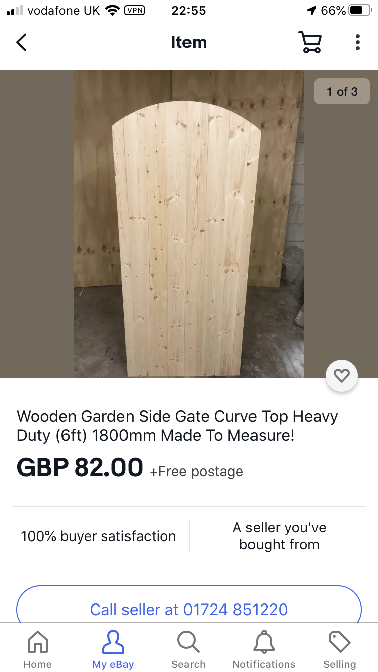

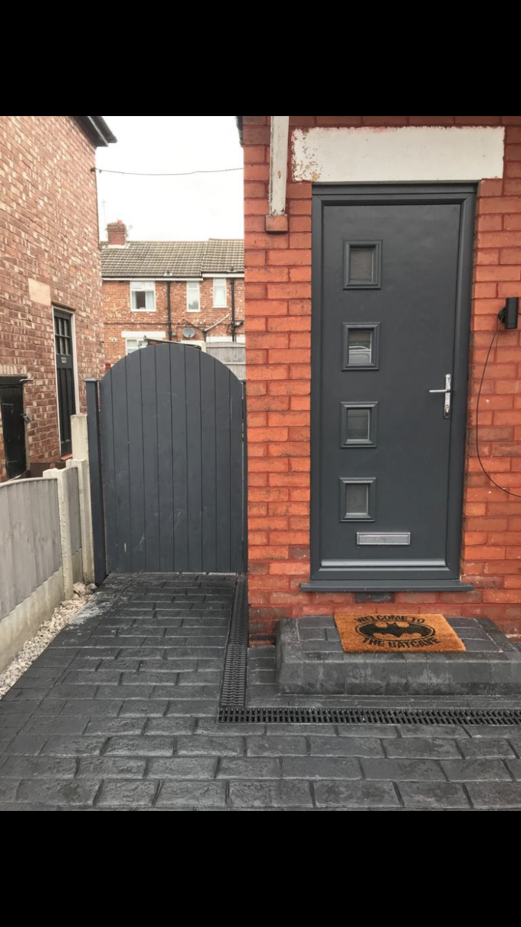

I bought one like this off E Bay , they make to size or a size close to yours , quite good quality etc , looks good fitted
Phil
