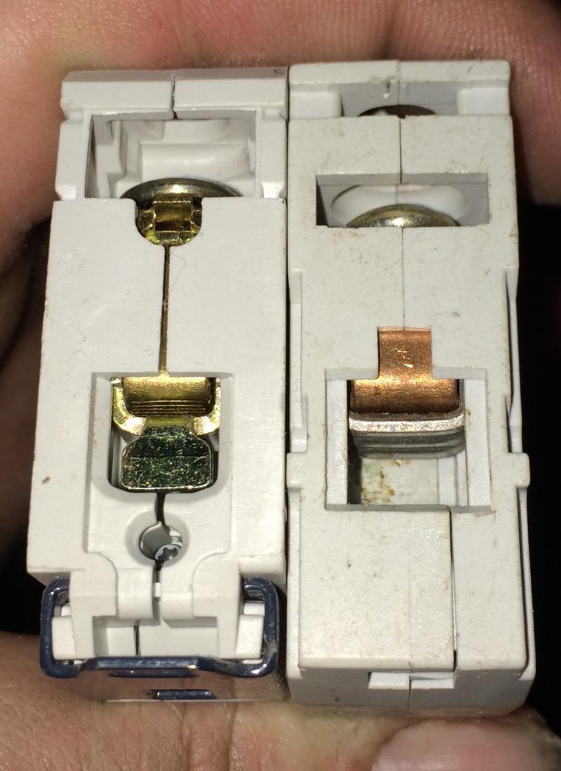

Hager also have the design of clamp where you can not miss the busbar.
Hager on the left, MEM on the right. You can see how the busbar hole is completely filled when the clamp is done up, unlike the MEM where the busbar could sit at the wrong side of the clamp.
My Wylex unit from 2010 is of the solid fixed busbar format - if a busbar connection is not properly secured, the breaker will simply flop about loose, as its the clamping action of the lower terminal onto the busbar, which secures the breaker into the board.
