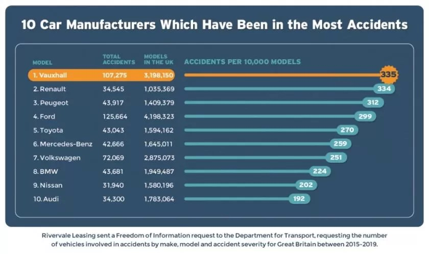

Apart from being a ludicrously sweeping generalisation; if accident statistics are at all a reflection of poor driving - Vauxhall's appear to be top of the list! ;)
