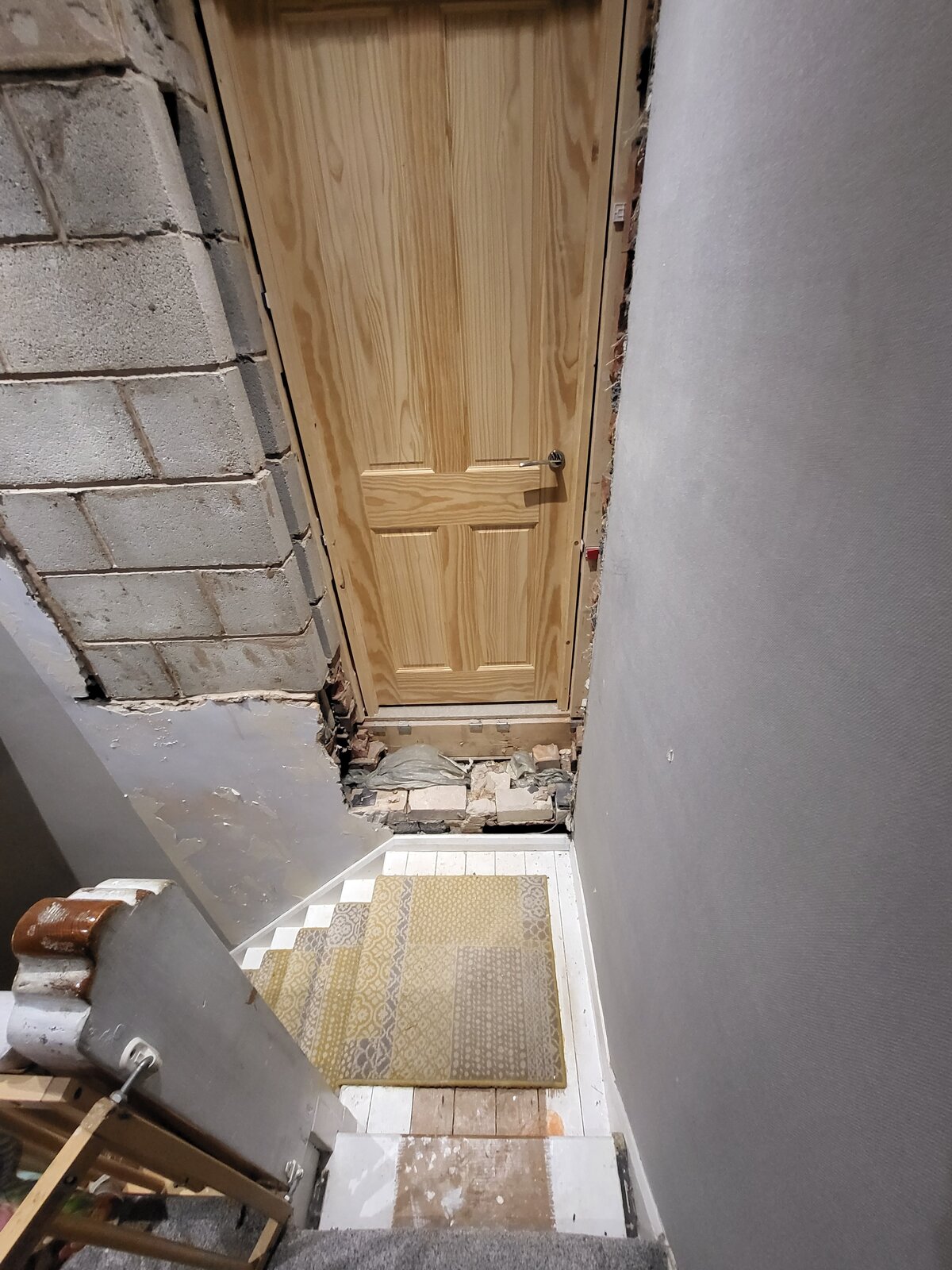

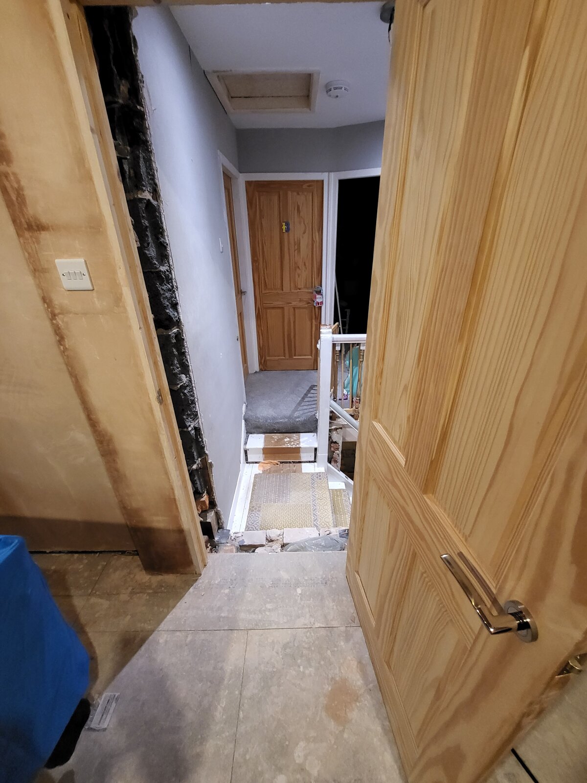

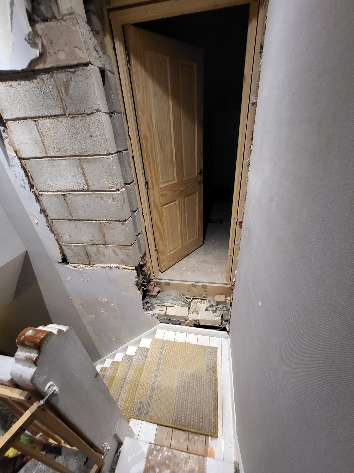

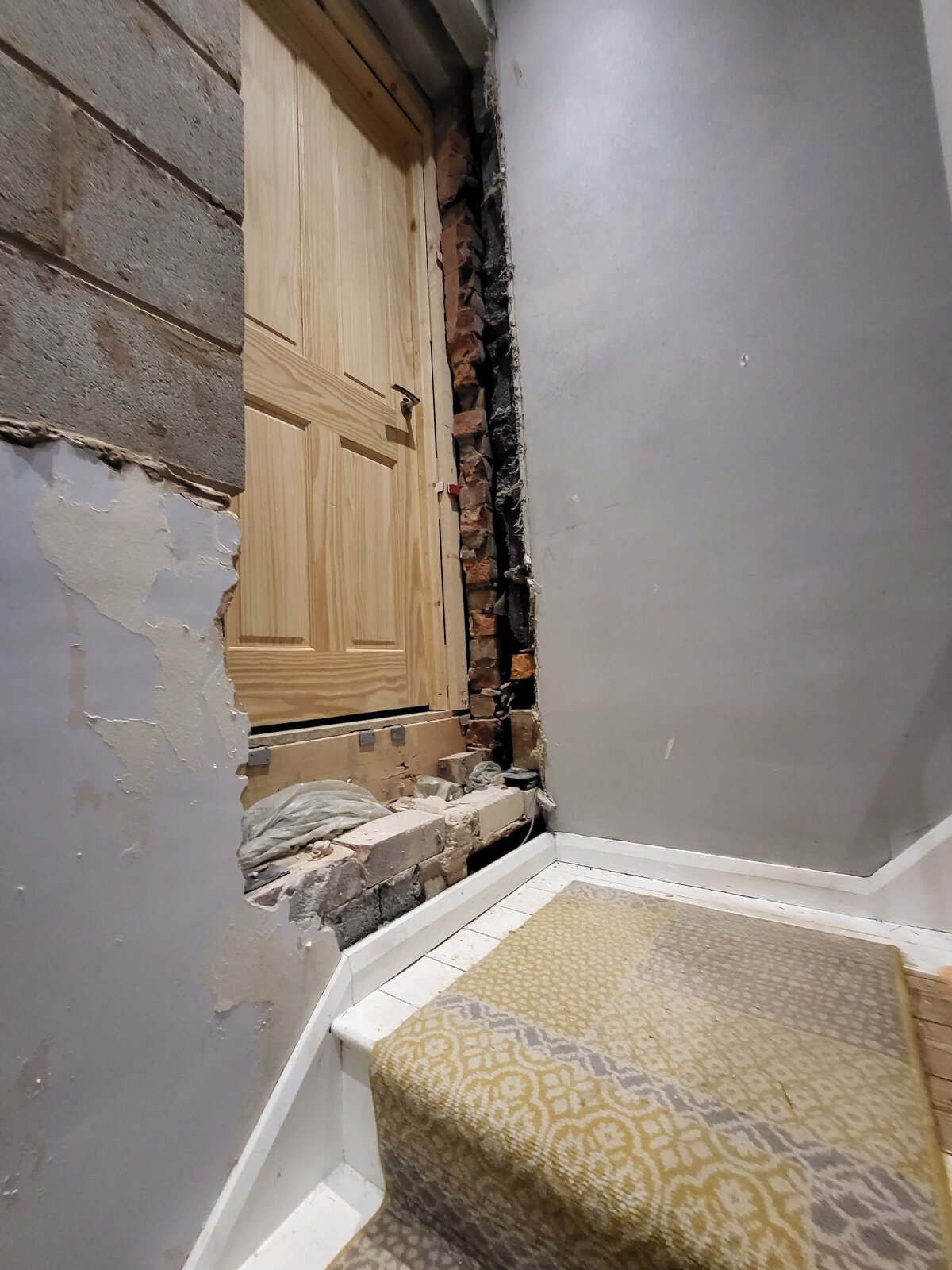

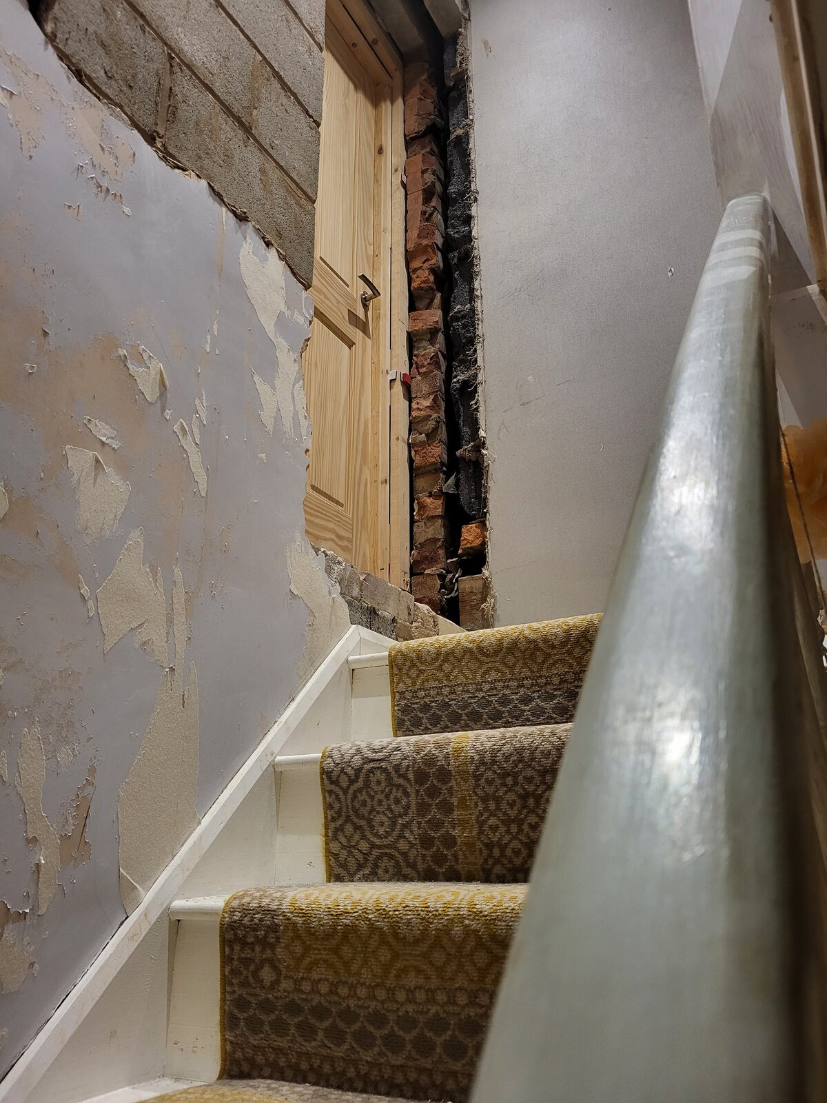

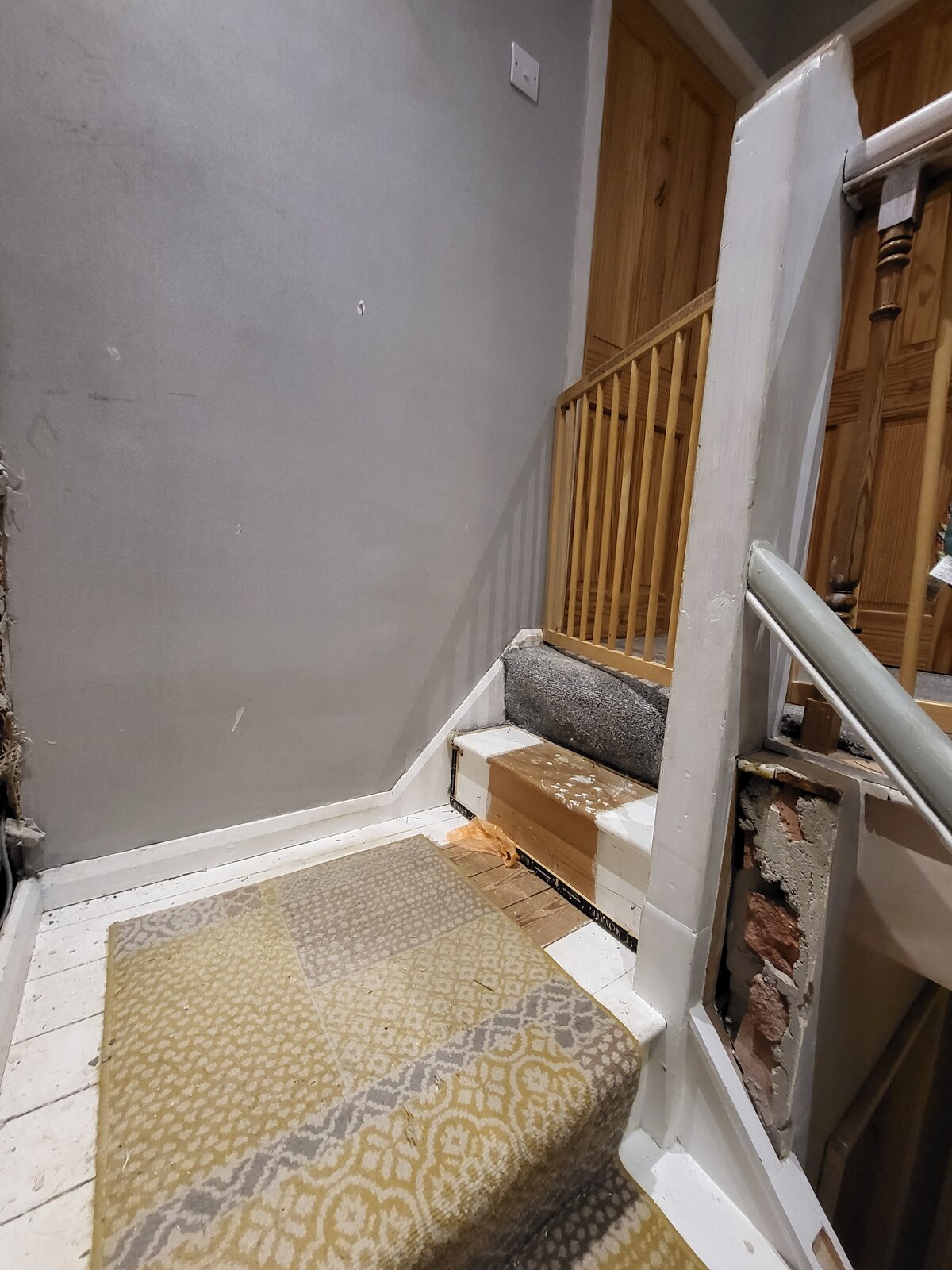

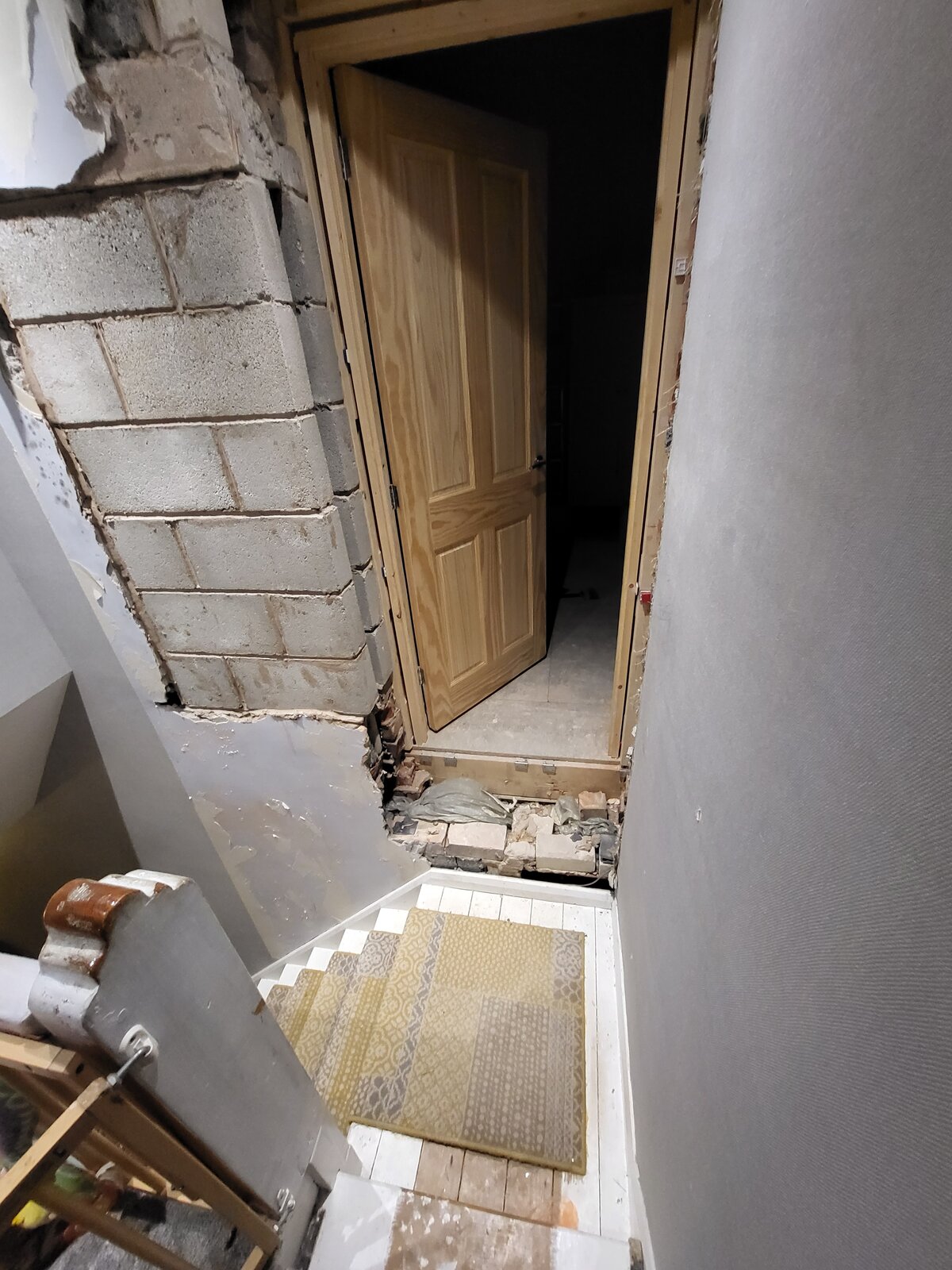

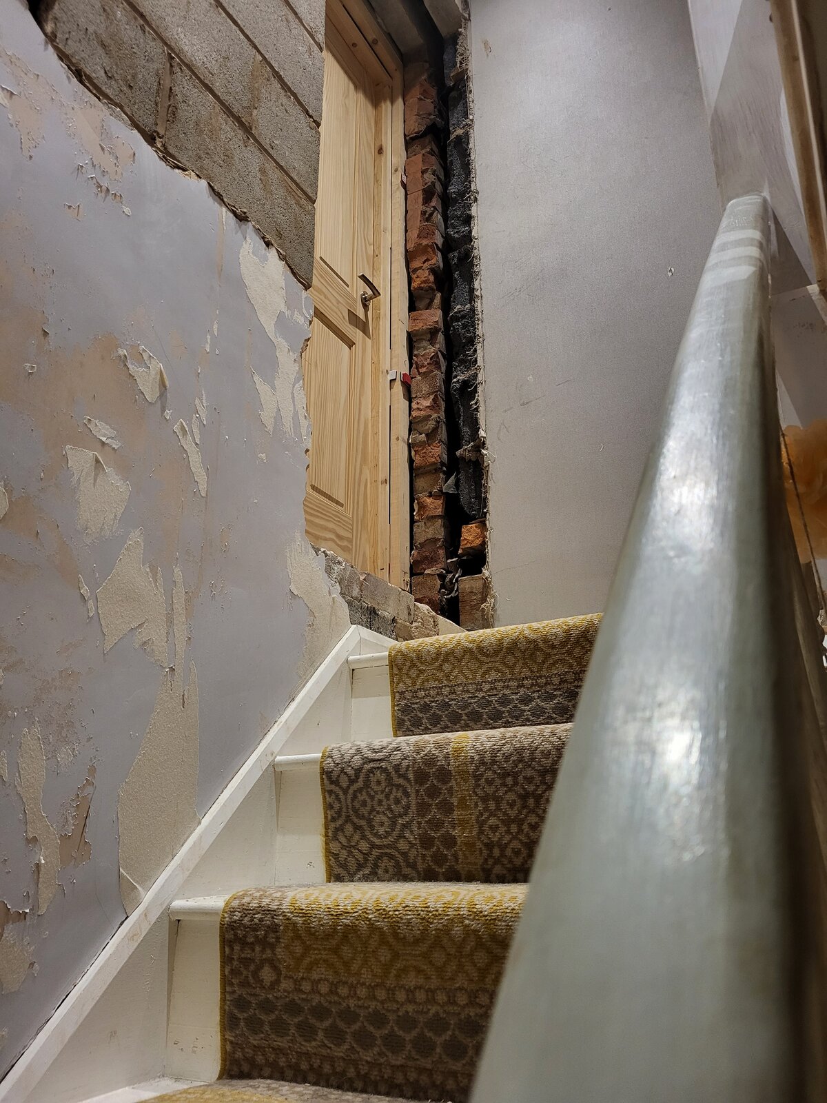

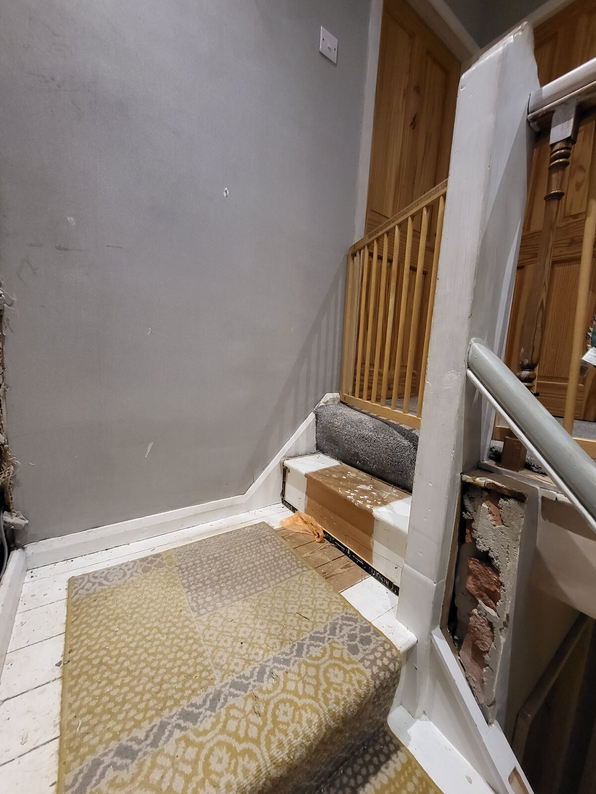

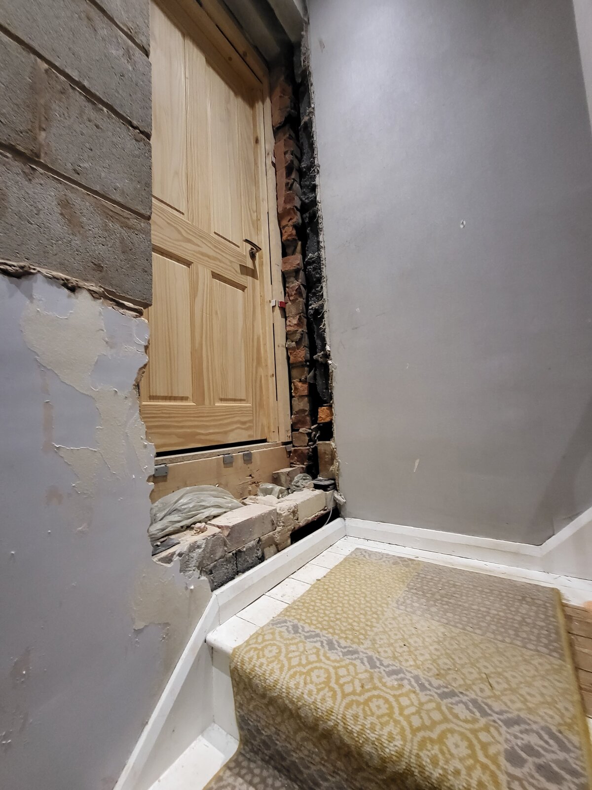

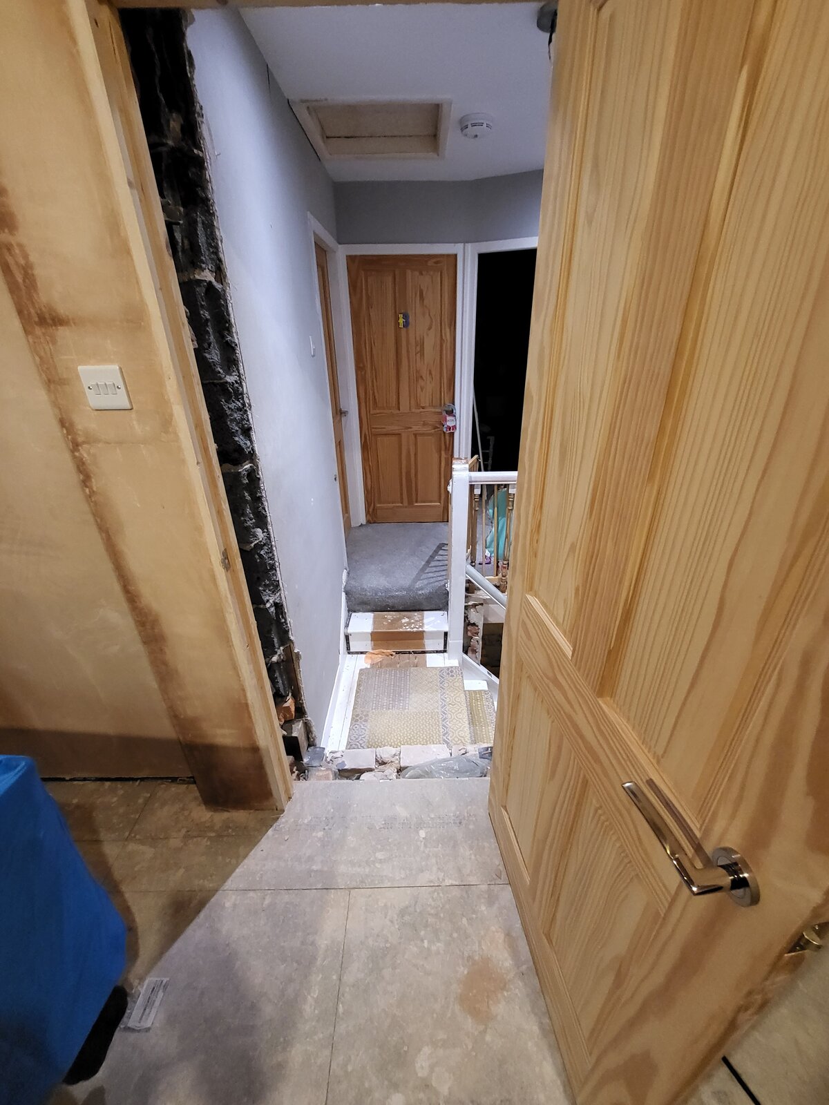

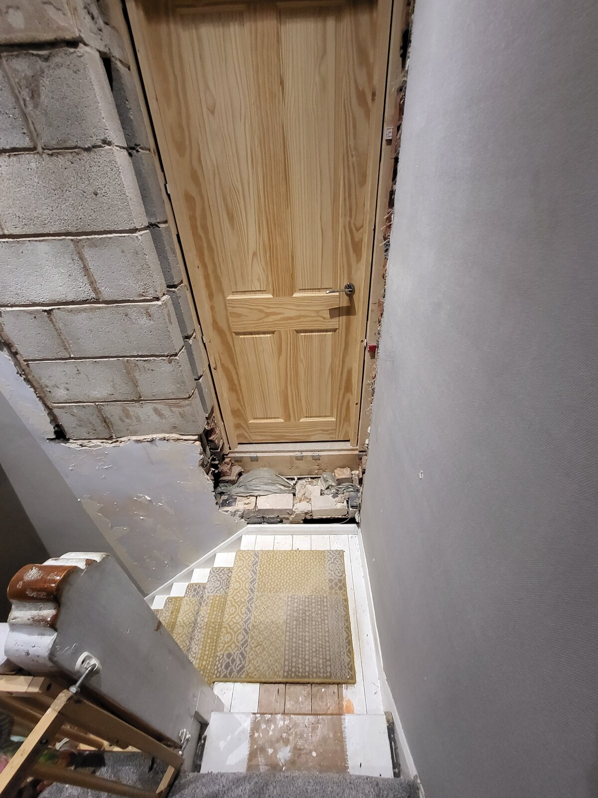

I've built a 1st floor bedroom above my attached garage. The stairs go to a quarter landing, and I have the doorway pretty much off the landing. As shown in the pics. It's going through BCO, and I'm pre-empting him not being over the moon about it.
Is this acceptable

It doesn't look compliant, no. I'm pretty sure you need 400mm of landing beyond the door threshold before the first step down. It looks as if that new floor joist against the wall should have been trimmed to allow a very small well and the door casing moved back inside the extension to suit.
Hmmmmm... I was (wrongly it appears now ) under the impression that the steps up to the door were off a quarter landing and as such, can be considered seperate to the main stairs.... and they are less than 600mm high. I'll have to see what he says, but don't fancy ripping it all out.....
Can't have a door directly on to a step.
Didn't you have approved plans to follow?
In my defence, I read doc K and I couldn't find anything that directly relates to this situation. The door opens away from the landing and the step up off the landing is less than 60 cm. The plans show a daft landing into the room, but it would create a load of unusable space. I cant find anything in Doc K that prohibits what I've done.
No rule against that in a domestic setting.
The ultimate regulation on stairs is K2; "shall be designed, constructed and installed so as to be safe for people moving in and about the building"
If I was a BCO, I'd accept that due to the change in direction, and the limited rise. Although the 600mm limit is not mention in the latest update of Part K, it states clearly in the preface that no substantive change in the law has been made. On that basis, it could be argued that 2 risers are not unreasonable.
If the door is hinged on the right (from the room-side) as in the pics, that would be better than the other side. Its a more tricky situation if the access has to be off winders, but a square landing is less of an issue.
