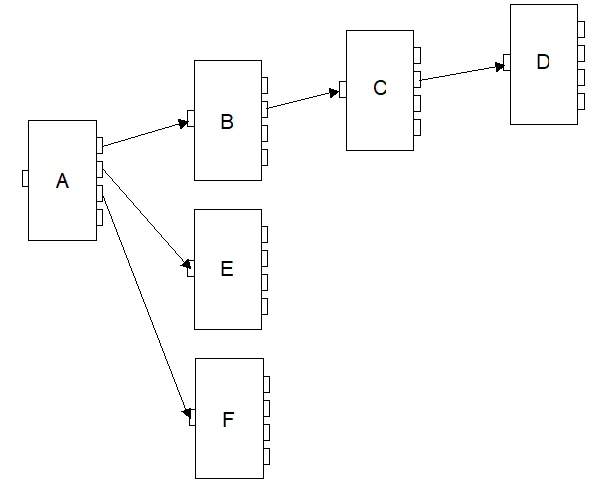

However, I would have thought that, even in IT, meanings of 'series' and 'parallel' similar to the electrical meanings would often be used. In terms of, say, network switches, would you not say that, in the following diagram, switches A, B, C and D were 'in series', whereas B, E and F were 'in parallel'?

I agree that 'serial' and 'parallel' are totally different concepts (from the electrical one) in terms of communication - although the latter are, I would have thought, largely a historical thing as far as IT is concerned. Originally, much of it was 'parallel' (e.g. Centronics printer ports), but that gave way to things like RS232 and eventually USB. However, those descriptors did not really refer to the method of wiring but, rather, to the way in which data was transmitted - either one bit at a time, 'serially' over time or by transmitted 7, 8 or whatever bits simultaneously ('in parallel'), through separate conductors. I suppose that's comparable with 4 cars wanting to travel down a road - they can either travel 'in parallel', each in their own lane of a 4-lane road, or 'in series', each behind one another on a single-lane road.
Serial communication is, I suspect, probably properly described as 'time-multiplexing', since groups of bits which eventually have to be separated and dealt with simultaneously (i.e. in parallel') are transmitted as a 'series' of discrete items transmitted separately over time. Put another way, the difference between serial and parallel communication relates to whether several pieces of information (bits of data) are transmitted simultaneous along different communication links or 'serially' (over time) along a single link.
However, in electrical-speak, that would not be regarded as 'in parallel' since the 7/8/whatever conductors necessarily go to different places, rather than being 'joined together' (as in 'electrical parallel'). Within a computer, the data buses do, at least to some extent, represent 'parallel communication' (in the 'Centronics' sense of simultaneous transmission of different pieces on information along physically separate paths).
