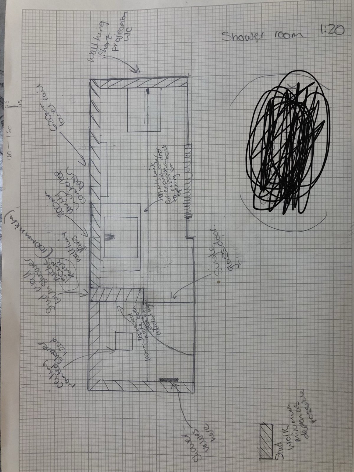

Im renovating a shower room and am wondering how many downlights are needed. I’m thinking 3 downlights plus however many in the shower.
I’ve attached a scale drawing of the room. The shower consists of a simple glass door which is hinged from a false wall measuring 2m high. I’m concerned it may get dark in there. My original theory was to put a downlight in the shower centralised to the glass door (see pic). But with the false wall being pretty high I’m thinking there needs to be another light down that end of the shower. The problem is the shower head comes from the ceiling and I’m unsure how i’d centralise the lights whilst also lighting it well and avoiding a shadow of the shower head!
Help would be appreciated! Thanks!

If you really want an opinion, then no downlights. Instead choose something which is designed to light rooms up by shining in various directions instead of just lighting the floor. There is a range of opinions on this subject. Bear in mind also that in a bathroom you have additional legal responsibilities like not making holes to allow moisture up into the attic to rot the wood there.
There are millions of downlights in bathrooms in the UK.
But Detlef is right about stopping moisture getting into the roof space.
Look for downlights that confirm to the requirements of Building Regulations part C.
As for positioning. Put lights where you need them.
Having them in straight lines and symmetrical isnt that important. Being able to see to shave is!
By all means install downlighter if you want really bright spots on floors and surfaces and deep shadows where you need light.
I'm with the others here - don't use downlights unless you like lighting that creates bright spots where you don't need them (on the floor), hard shadows where you don't want them, and generally are a PITA. I've stayed in hotels designed by people with more attention to style over function and fitted with these things - stood in the bathroom looking in the mirror, face in shadow, light reflecting off my shiny head. Complete carp.
