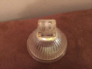

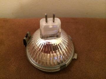

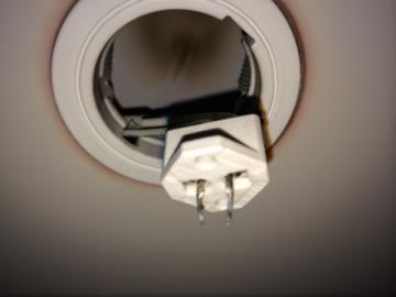

Hi - I have a similar problem with a downlight bulb in the bathroom.
I managed to pop the bulb out from the hole in the ceiling okay, but disconnecting it from the wired fitting is an issue.
Most online vids say you simply unplug it (pull the two prongs out.) Mine was harder work, but I just assumed it was just jammed in harder, and eventually I eased the bulb out from the fitting - but the two prongs were left in the wire fitting and ripped out of the old bulb, as you can see:
This is a new bulb I bought, which kind of tells me those two prongs shouldn't be stuck in the fitting:
And here is the fitting with the two pins stuck in there:
How did I mess this up, and how do I sort it out? There are four screws either side of the fitting - was I meant to unscrew them rather than simply unplugging the bulb?

that holder screws on you should have loosened the lower screws on each side first
Aha. Thanks, I'll unscrew the bottom screws and hopefully the pins will just fall out.
I did notice a slightly worrying brown burn mark above the fitting (and reddish mark around the gap where the bulb clips in...
