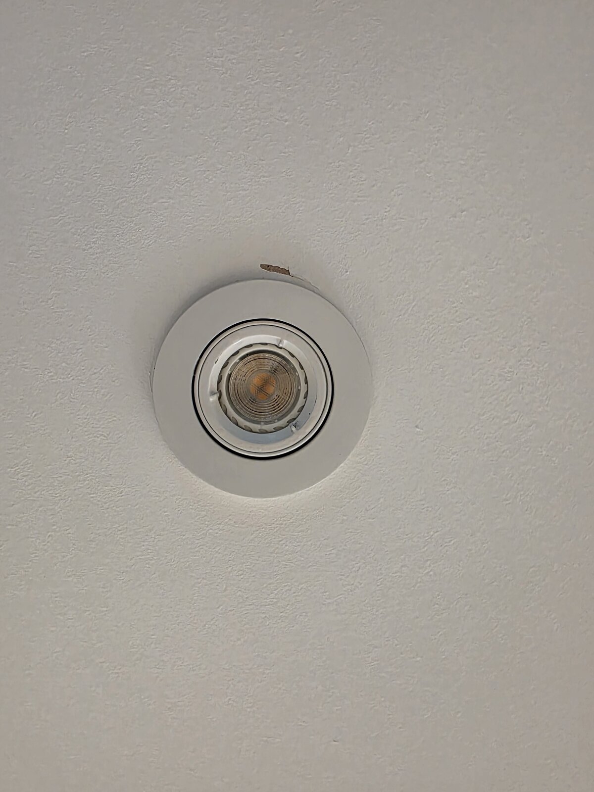

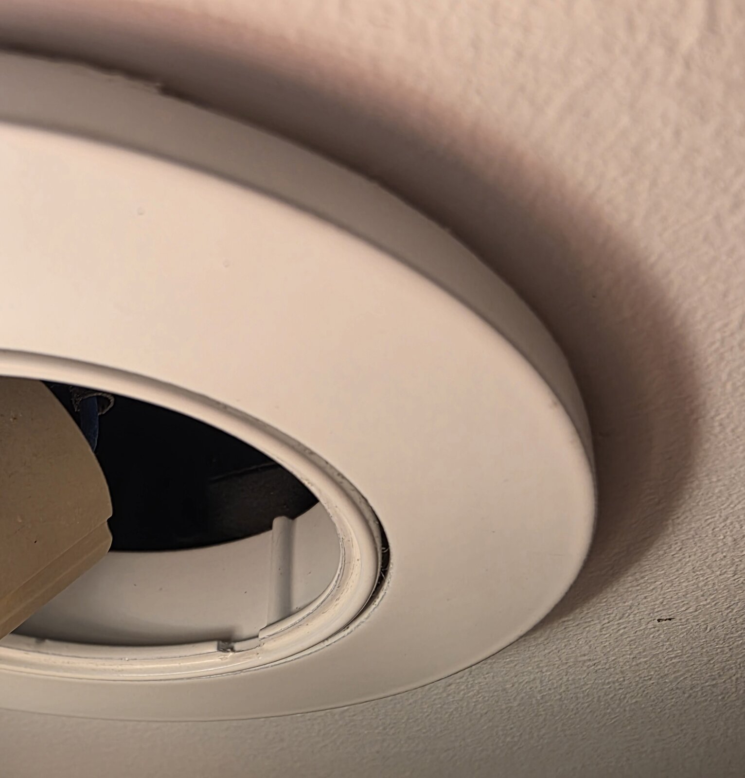

I've been replacing bulbs in my downlights and some of them are siezed closed, will not turn to pop out. I had good luck with a squirt of wd40 in the gap for some of them but the last two are being stubborn bar stewards. Any ideas on how to loosen them open?
Photo of one in case that helps. They have two lugs that twist into place
Many thanks!

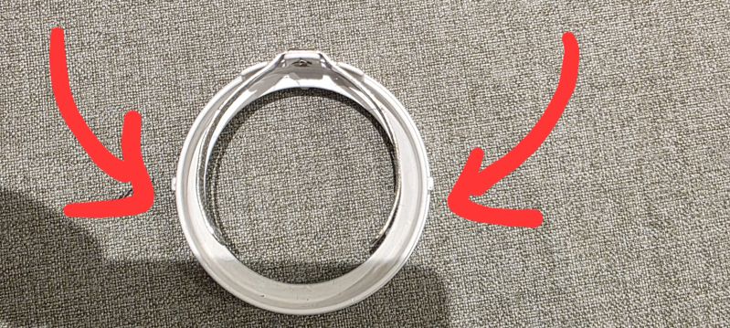

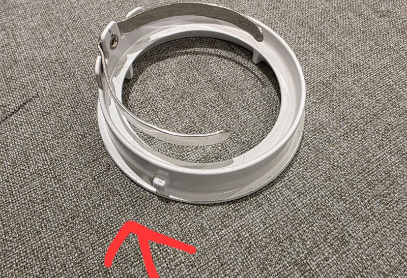

Sorry hopefully this is clearer - the two lugs slot through this gap and twist into place. Good idea about kitchen gloves.
Trying to attach photos of the actual lugs and tech issue with image size. Hopefully will follow shortly
Carefully use a screwdriver on one of the 3 ridges and tap it round to start it, the heat warps the metal and makes them bind in, sometimes best to remove the fitting from the ceiling to. do it
If you don't want to scratch it use a bit of wood rather than a screwdrive
You can also stick the fabric-type Elastoplast strapping to it, and hit that. Try wiggling it left and right to loosen.
Update - 50% sucess. Pushed the bulb in and generous amount of wd40 sprayed in the crevices from the bottom and from the inside where the bulb sits. This managed to work on one of the fittings with a good hammer on a screwdriver wrapped with tape after a few days. Previous attempt without pushing bulb in just spraying from the bottom did not work. Now hoping it works on the other one in a few days as well! Unfortuntely my attempts have definitely dinged the finish a bit.
