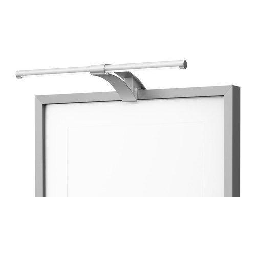

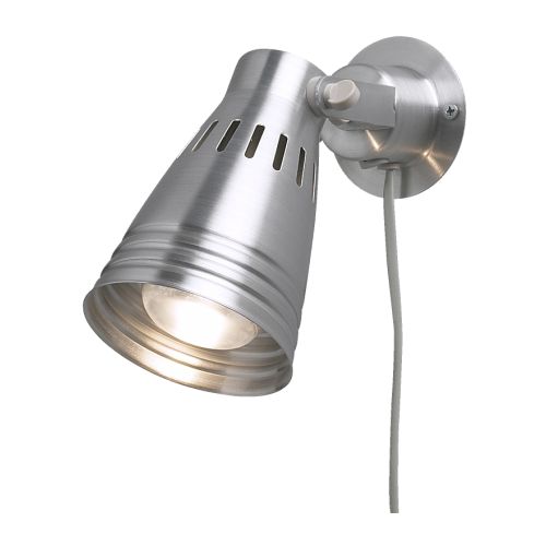

Lamps like these are cool so will not damage books and clip on but can't be dimmed. There are many more options like this and another all clamp on and all are cool so will not affect books. If you really want to dim lamps then likely they will be fixed as that way you can ensure they will not be too close to books something like this uses non quartz bulbs and therefore can be dimmed without a problem. [/url]
