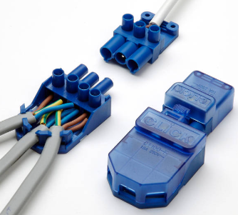

Personally, I have used this arrangement in the past:
Safe and easy to maintain.

Things are improving now boxes are supplied with some down lights
The quick connect (screw less connection) really suit lighting.

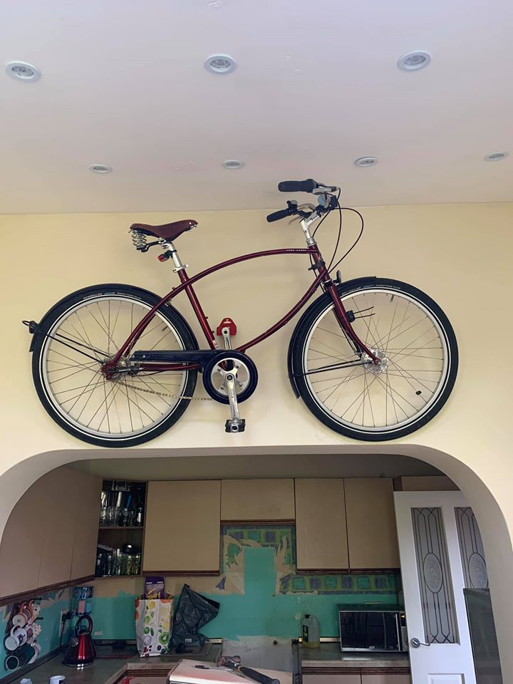

I look at down lights, 102 Kitchen Bike.jpg and undecided, here they replaced a fluorescent tube, started as 65 watt fat tube, when I could not get them went to 58 watt thin tube, and when the voltage reduced to 24 watt LED tube, and I look at the light from down lights, and it is no better, but with a high ceiling which this is, it does look a little better, so how much for the light and how much for decoration?
There is no assess from above, so no one is going to stick their hands under the floor boards, not a clue how my son has wired them, but even if a simple choc block, it is hardly going to present a danger, the junction box style like this
seems to be designed for converting from a ceiling rose to continental style lighting, but in that same room my father-in-law ran horizontal switch to switch, around 4 corners, and that did catch me out, I had not expected it to be wired like that, and hit wires with a hack saw blade. I had expected safe zones to have been used.
But the problem is, people buy the lights, and expect them to be fitted by magic, and don't buy the junction box, and someone is presented with the lights, and SWMBO think they can be put up like Christmas tree lights.
