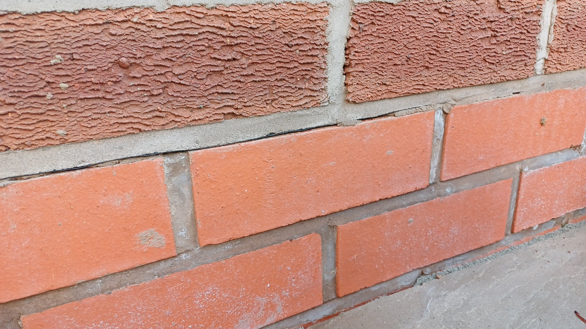

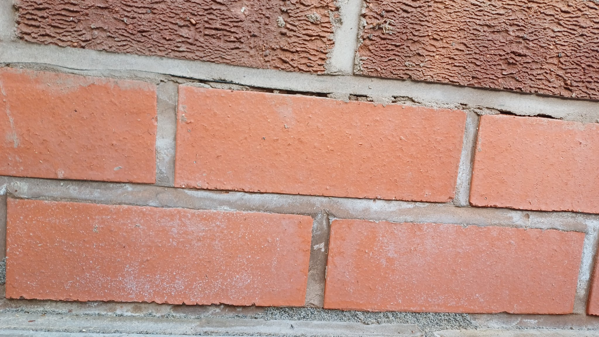

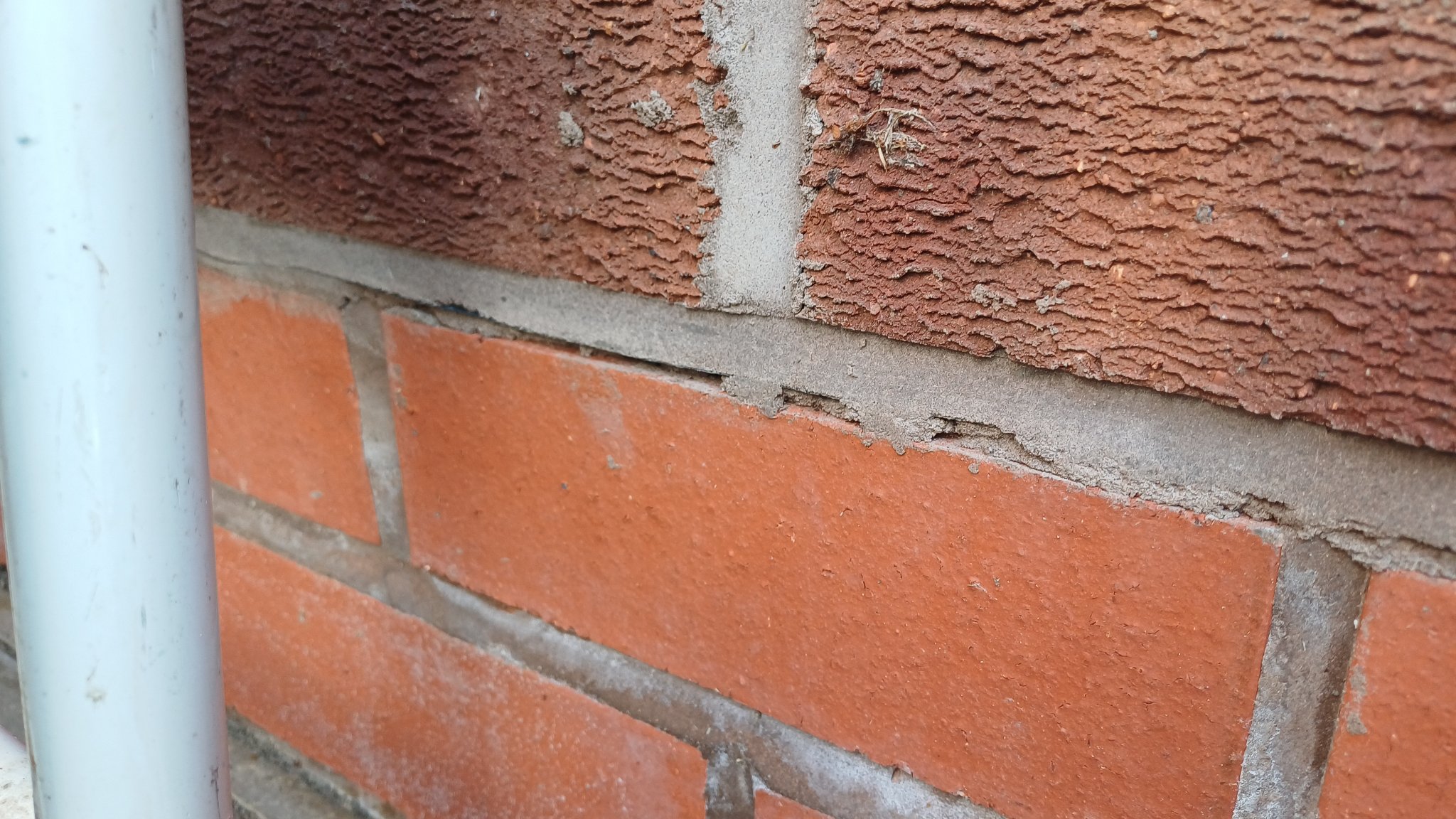

DPC Mortar - Look ok?
I thought it was there to catch the mortar droppings.
On an old 2” cav', with half inch of damp protrusions into the cavity from both sides and a tie wire helping catch the snots, a blocked cavity is a very real possibility.
When the cavity fill was 2 courses below damp and the inner skin was brick the cavity fill was often close to the DPC by the time the plate was going on and the snots off the ties had been knocked off.
They definitely built my old estate in the 1970s with "outie" DPCs, but my current house's 1990 extension has an invisible one.
I guess that at some point in the 1980s someone worked out that you could point over it without the world ending. Plus this way you don't get the crumbly bits above and below as shown in the photo in this thread.
