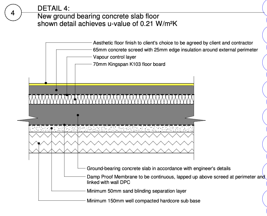

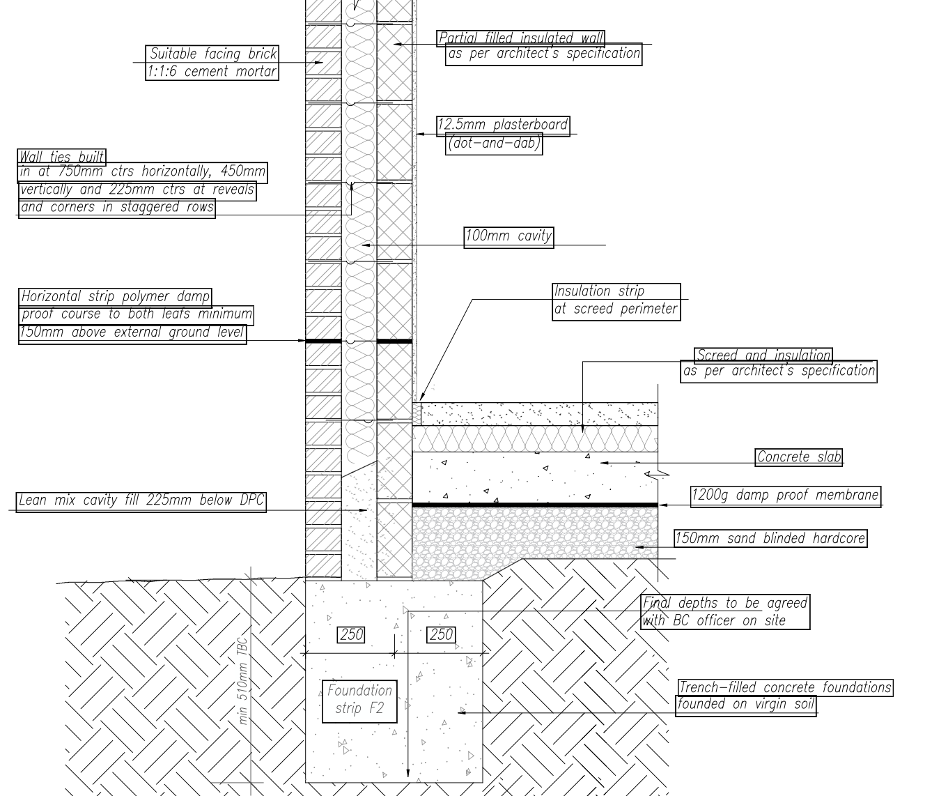

I've attached the floor details from BR and SE drawing.

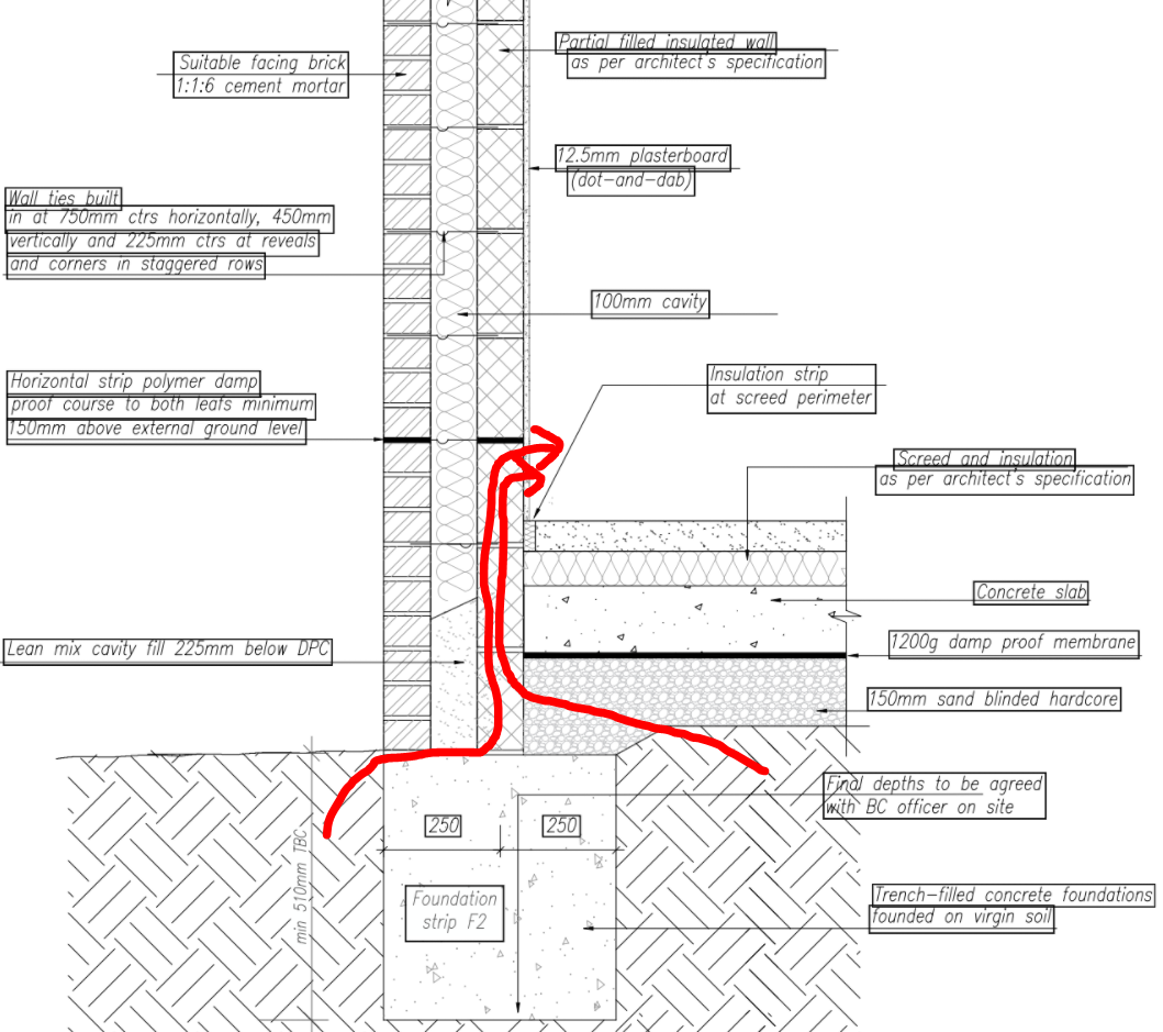

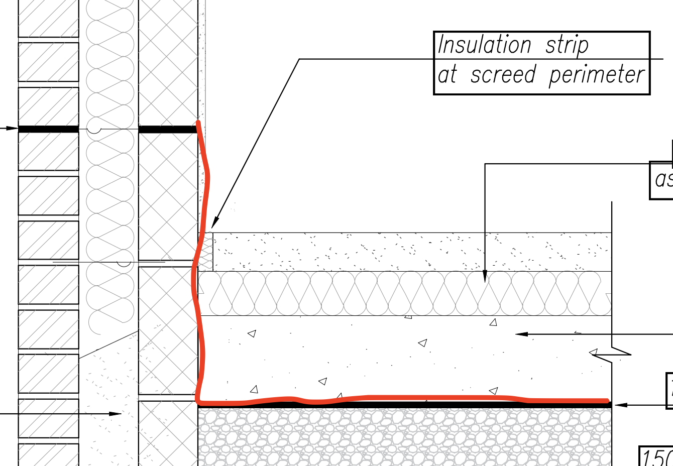

Thanks Woody, I believe the builder is gonna do like this, is this called apron DPM? would this suffice?
If the DPM laps the DPC in the wall, and if the builder is laying the floor afterwards, any DPM skirts hung out of the wall are lapped and taped to the DPM that goes under the slab, then yes it's OK.
But why is that DPC so high in the first place. That's nonsense
When you say "lap" do you mean just go over the DPC level, not "inserted" to the wall right? As my wall is already built with the DPC strip in...
This is the party wall section from structural engineering drawing so it might just be demonstrating, not as per dimension etc.
The DPM should lap the DPC by being in the wall and the wall above laid over both DPC and DPM.

That detail is still crap whether its a party wall or not. Drawings are not for demonstrating, but for building from without guessing what the designer actually meant. It's a mad world when the builder says, "I built what the drawing said" and the plan drawer says "Well it was just for demonstrating, not to be built like that"
Make sure they specify what insulation strip at the screed perimeter should be used. Also ideally insulation in the cavity will be carried down at least 150mm from the top of the floor insulation.
Why aren't your drawings detailed enough to build from? They should not be guesswork.
