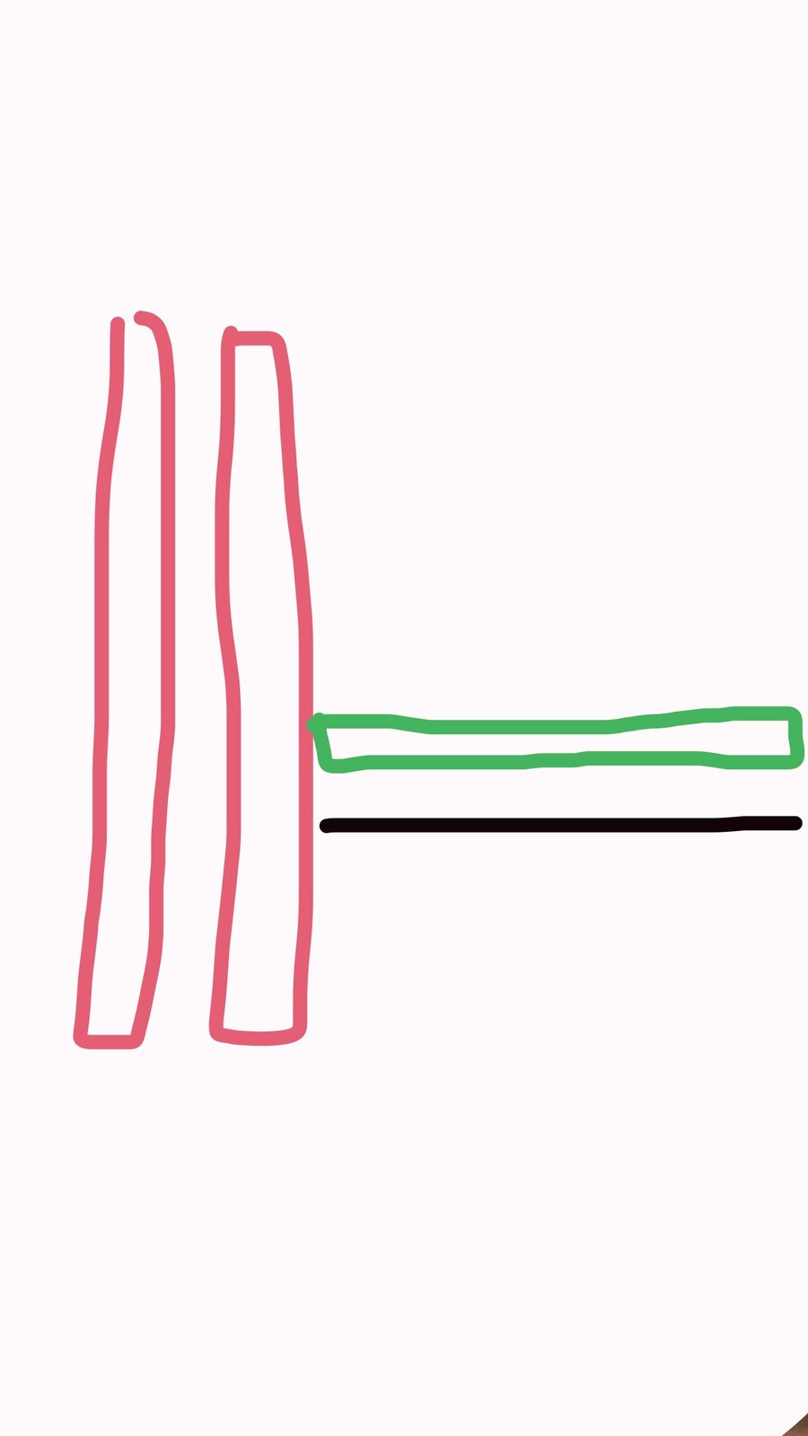

ah i see i see. isn’t polyethylene a dpm material though, so i still need to lay this, and i’m guessing i can butt it up to the brickwork as i don’t need to join it to the dpc.
also see diagram below: if i didn’t lay this membrane which is the same material as a dpm, could damp come up from below the black onto my green beam?

SUSPENDED TIMBER GROUND
FLOORS (MOISTURE FROM
THE GROUND)
4.13 Any suspended timber floor next to the ground will meet the requirement if:
a. the ground is covered so as to resist moisture and prevent plant growth; and
b. there is a ventilated air space between the ground covering and the timber; and
c. there are damp-proof courses between the timber and any material which can carry moisture from the ground.
Approved Document C, Building Regulations
So can you just respond with YES if this is right:
sand blinding, dpm to resist “moisture and plant growth” ( this will be butted up against the blockwork not connected to the dpc), then 50mm of concrete goes on top of this dpm, which then i will leave a 150mm gap so i can have a suspended timber floor.
:eek: could you at least tell me why i have done wrong. @^woody^ is telling me to put a membrane down which “stops weeds” but it is the same material as dpm. but then i’m told i don’t need a dpm as it is a timber raised floor. just tell me what i need to put down instead of the reg lingo please(y) many thanks
If you had read to the bottom of NHBC 5.2.10 you would have seen that 150mm is a minimum dependent upon the subsoil, so just to say needs 150mm is incorrect, and the “ regs lingo” is for fact checking and reference
There is no problem with damp under a suspended timber floor as the ventilation deals with that. You do not need a DPM
There is a potential problem with vegetation growing in the ground though
So, you either lay a concrete oversite which stops anything growing though, or you lay gravel and beneath that you put down something that stops anything growing though. That something can be made from polythene, polyethylene, whatever you if you like, as long as it forms a barrier and wont rot away.
It is not a DPM, and does not need to be installed like a DPM, even if its made of the same stuff a DPM might be made from.
