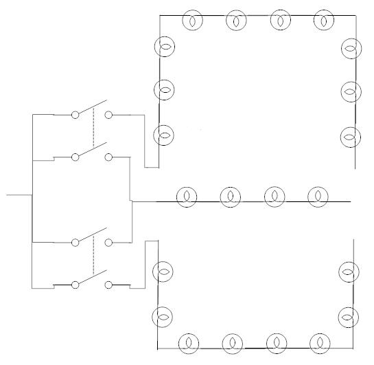

Is this the right/best way?! Simplified diagram:
Problem: Two light switches will operate three light circuits - the middle one to come on with either switch.
Context: Living / dining area with downlights in a boxy "8" shape - ie. all around the outside of the ceiling, and then a joining row in the centre. Want either side of (and including) middle row to be able to be lit independently. Middle row must be lit with either and/or both switches.
Questions:
1. Do DPST domestic light switches exist?
2. What are the wiring / load / etc implications of none / one / both switches being on?
3. Any obvious alternatives? (other than not doing it!)
4. Is there such a thing as a "one-way valve" so the middle row can be wired in to two SPST switches (without also lighting the other circuit too)?
Many thanks!
DP switches certainly exist but usually in 20A versions - whether that will be a close enough cosmetic match to a 6A lightswitch is up to you. Or check gridswitch ranges.
The total load must be within the capacity of the switch and circuit.
3 separate switches
relays
programmed light controls such as X10, crestron, etc[/b]
Thanks Owain.
Had considered the 3-switch option, but just wondered if there was a neater solution.
Happy to go down the Crabtree / MK / Varilight grid route to incorporate other light switches too - just can't find a DPST version though...
What do you mean by the 20A version? Do they look much different? Do you have a link?
Many thanks again!
Potentially 1 Kw of lights on at the same time - :evil: toastie...... :evil:
Best option as suggested is a three gang switch with each 'circuit' wired to one of the gangs.
Perfect - thanks... Thought those double-pole 1-way switches were usually for isolating the live and neutral, but like your approach. Are there any issues with both of the switched lives of the middle row being connected?
Point noted about the load. Had planned to use LED lamps, although realistically until they improve / come down in price, think they'll be CFL GU10s. Still up around 242W though (22 x 11W) all on...
So otherwise, all okay? Would rather be set right now than sizzle the house!
I count 22 lights.
Surely unless you've done something barking mad, like choosing lights that are useless, that must be your entire house.
Why on earth do you want your entire house lighting on just two switches - won't that be remarkably inconvenient?

No, not in series - more a lack of my artistic ability with SmartDraw to show the junction boxes, neutral and CPC too... The diagram only shows live / switched live for clarity, but I appreciate your comment - the way I've used the icons does make it look like series, but that wasn't my intention...
No, not in series - more a lack of my artistic ability with SmartDraw to show the junction boxes, neutral and CPC too... The diagram only shows live / switched live for clarity, but I appreciate your comment!
Just remember though that should you go down the road of LED's as you suggested then they sometimes come with constant current drivers and then you will have to wire them in series.
