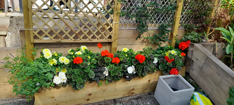

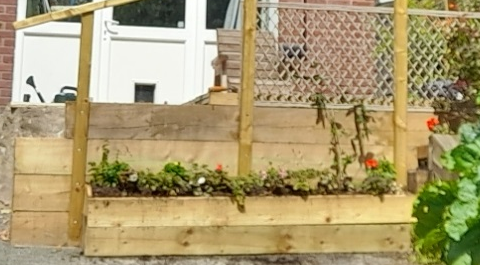

This year, I decided to make some steps, from the drive to new patio, and I used 4 sleepers to build the wall. Well it did not look good, so SHMBO said needs a planter, and plants to hide the wood wall, but I have never really played with plant, well CAT type plant yes, but not the stuff which grows.
So I built the planter, 1789228277442.png (08-07-26)just before the drought started, so it was a watering can every day, 1789228409471.png (22-08-26) they did survive, but I wish my wife has not spent so much on plants, but as to how much water will be needed in the future?
