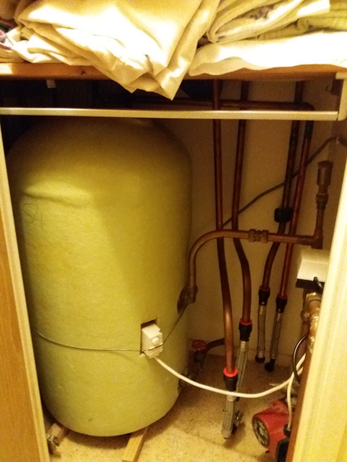

Here is a photo of the cylinder. It is the red gate valve in the bottom right corner that I have turned off. It was fairly tight and I had to hold the red wheel lightly with some pliers to turn it. It turned 4 full rotations.
The cylinder only had a little hot water in it as the bath had been used earlier in the day. The water hasn't been heated since. When I opened the hot bath tap while trying to isolate the hot water, there was some warm water to start with then it quickly became cold.

Think you have closed the wrong gate valve. Those two pipes look to be from the boiler to the coil .have a closer look around the cylinder ,other side or at the back for another pipe low down. When you close the cold feed to the cylinder ,and turn on hot taps to drain out ,you don't actually empty the cylinder .only what's in the distribution pipework ,which is minimal ,maybe a litre or so.and use a downstairs hot tap ,as well as the bathroom hot to empty out the pipework. And yes you can use a bung if you are confident with that method.
Are you positive that gate valve is on the cold water inlet to the cylinder and not the cold end of the coil?

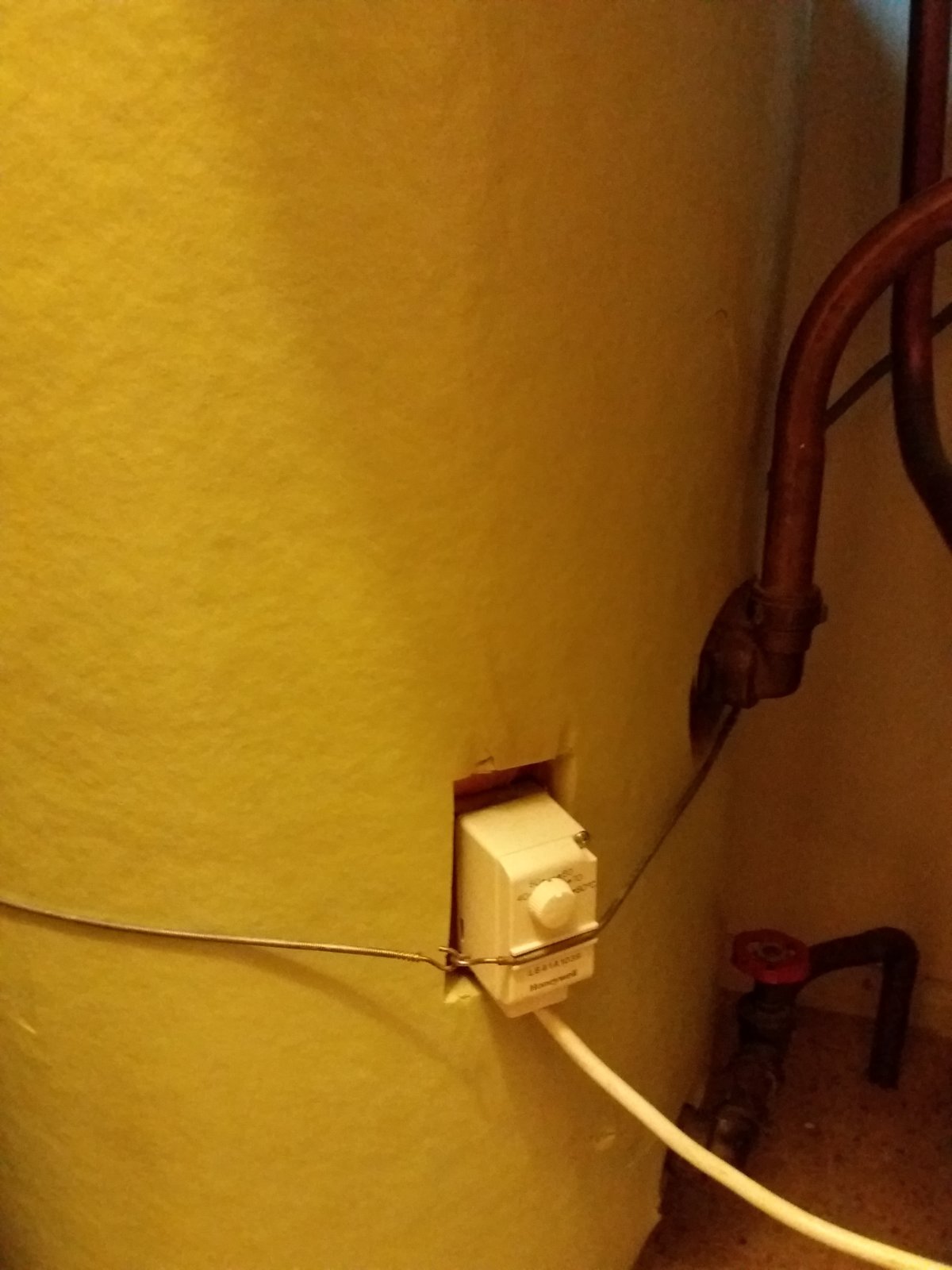

Attached is a better picture.
I can see a drain cock which comes round the back and is to the far left in the picture at floor level, but I don't think I want to drain the whole cylinder do I?
Sorry for so many questions....from your replies above, I thought there would only be one feed to the coil in the cylinder, from the motorised valve pipe.
Why is there a cold feed to the coil too and where does it come from?

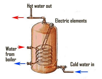

The coil has 2 ends, otherwise no water would be able to flow through it.
The cold inlet is probably on the opposite side of the cylinder to those we can see in the photo. I.e right where it can't be seen. Follow the pipe back from the drain cock and you'll find it!
Inside your cylinder is a copper coil and the two pipes are attatched to it.hot water comes from the boiler thru one of those pipes ,runs thru the coil , and comes out the other pipe and goes back to the boiler for re heating. So its like a coiled immersion heater ,if you like. The hot water running thru the coil heats up the cold water surrounding it in the cylinder ,and hey presto you have domestic hot water. You need to look more carefully to find the cold feed from the loft tank to the cylinder ,it must be toward the rear.
