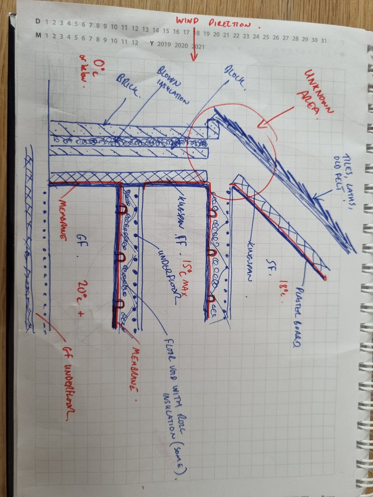

We have a similar issue to the original post.
Brick built barn converted about 5 years ago, heated by ashp and underfloor upstairs and downstairs.
The brick barn has a cavity, which was left empty when converting as the walls were all studded out and insulated with kingspan, approx 200-300mm air gap was left between the dry lining and the inner block wall.
We pulled our builder up on draughts as it was being built, he begrudgingly fitted a membrane after our complaints ut this was done over the top of the kingspan before being boarded out and plastered. They also membraned across the ceilings and taped all joints.
Once complete the draughts were still terrible, through sockets, downlighters and anywhere where there were gaps.
I spent months caulking, taping back boxes, down light holes, and foam filling anything else (such as where floorboards met the walls under the bath where on a windy day it would blow a candle out).
On a windy cold day in the wrong direction then 3 rooms won't go above 15 degrees with heating flat out, so had to resort to electric radiators in our baby's room when it's very cold!
We found that not running the upstairs underfloor heating was more efficient, as the draughts were carrying the heat out of the void and outside, rather than through the floorboards.
As its air source heat pump we have limited capacity on thermal input so these losses mean £1000+ per month heating bills in the cold months
We had the outer wall cavity filled with insulation to see if this helped, it made a slight improvement but still not great
Today I put a smoke bomb above the ceiling in one of the worst rooms, taped all holes to see where it escaped on a still day. From outside the house smoke rose through the roof tiles and around the velux windows, mvhr vents and this spread over a large area above the room.
Should we now have the roof off and re felt with modern membrane and seal to the top of the wall plate and across to the dry lined cavity? The roof was not replaced during the build as was only around 25 years old, but had old non breathable felt so we knew it would need doing one day.
Any advice please, dos or don't? I was going to speak to a local trusted roofing contractor for their opinions
Rob

Regards the smoke test, are you saying you e.g removed a down lighter and put the smoker into the ceiling void above the room, and were later able to see the smoke filtering through the roof tiles? Describe the insulation that exists between the ceiling plasterboard of the room, and the surface of the tiles, because you seem to be implying you don't have any?!

I think your question on the space between the ceiling void and the tiles is the unknown i also have. Without pulling ceilings down or removing the roof its a bit unclear, but there appears to be a path that this smoke and the draughts can pass through from what should be the warm suspended underfloor heating pipes and trays, to the outside world
I suppose my question is should we have the whole roof off and re felt with breathable but current spec membrane, or do you think removing part of the roof where it meets the walls and packing with more insulation in the intersection area alone would suffice?
Maybe some additional membrane to be applied to these regions also?
Are there any issues we can cause here by sealing up too much? We have the mvhr units which should help internally but dont want to cause any damp in other parts of the structure!
Ive done a rough sketch to what i think we have based on memory, checks and photos during the build. From this the solution appears easy, but practically this is going to be expensive and time consuming so wanted to see if people thought this would solve the issue and be worthwhile!

Where you are right now, I'd fill that cavity; it's clear it's circulating air and the cavity fill you've already had done is nigh on ineffective as a result. At the top of the walls inside the circle of unknown area is a problem that needs resolving (filling up with an insulation that inhibits air movement)
The easiest access to it might be by stripping the lower roof :/
A better wall buildup would have been: World, origonal, 50mm cavity, breather membrane, OSB, Studs with interstitial kingspan, kingspan over, VCL, batten/service voice, plasterboard. The sockets would then not have punctured the VCL, and the place would effecively be a timber frame made of sealed, draghtfree panels, stood up and joined together. The roof insulation would have joined up with the wall panels
Still, a good compromise is achievable; seal up the exterior against draughts as best you can too, repair pointing, fill obvious holes with expanding foam etc
