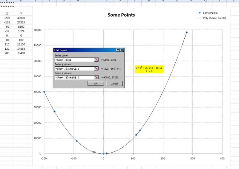

Right click the graph, choose Source Data, then go to the series tab.
Highlight the Temperature Series from the list to the left, the click remove. Now go to the Category (X) Axis Labels box at the bottom, and click the icon to the right of the text box. Select the temperature data and close the range window that has opened. If you now accept this your graph should have one data range plotted, using the temperature data as the x axis.
Yep, sorry thought everyone did that way - selecting data...
Adjusted start / end values, crossing points for both axes.
Used scatter points - no line - fitted trendline - normally look for value of R to be nearest to val of 1... In this case poly' order 2....
