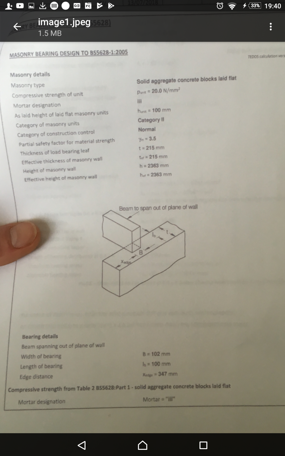

Drawing again, different one.
16 Oct 2009
79
Yorkshire
Hi.
The following plan states that I need to build a pier from 4inch solid concrete block to sit, my steel on surley it is sufficient to knock a pocket out of the solid wall(which is a party wall) and place a passion and sit the steel on that.
Or am I reading the info wrong.
Thanks for helping.

It doesnt say that, it just is a calculation about a beam resting on a wall. Does that wall description match what the party wall is made of? You need to clarify with the se what they intended.
