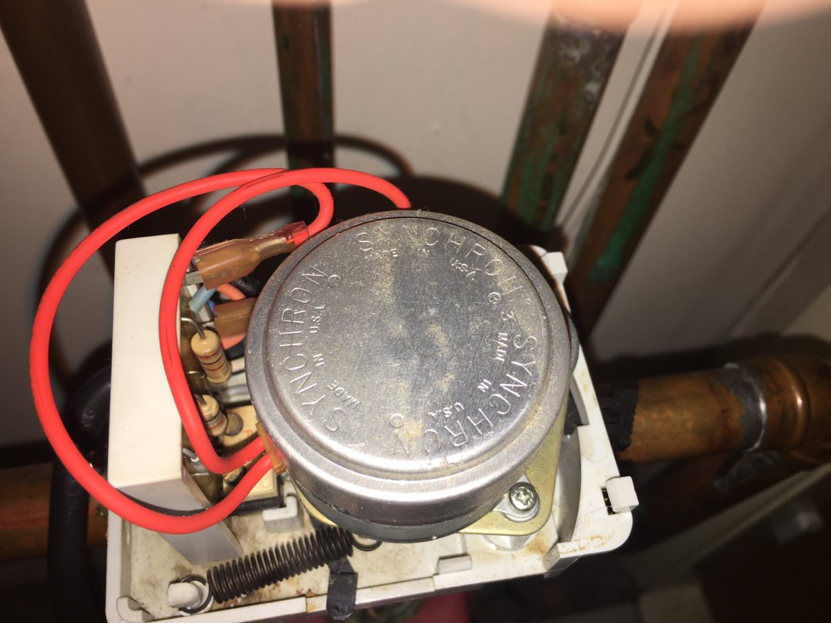

Radiators have begun to heat up for no apparent reason. only way to stop them was to turn off the power to the boiler. Have since discovered that the Drayton acl Lifestyle Mid-Position valve 679H340-30LO in the airing cupboard isn't working as it should. The most obvious thing wrong is the smell. Either the motor or the small board with resistor and micro switch are completely burnt out. Not really keen on draining the system, so would like to just change the actuator and leave valve in situ. As this unit is quite old (fitted 1995) I'm struggling to find a direct replacement, the new ones seem to "clip" on rather than be screwed on as this one appears to be (not taken it off yet - so I don't know).
Can any one advise a good replacement

You could try changing the syncron motor but best bet is to change the whole valve.
Hi DP
Thanks for the quick response - never drained the system before but theres always a first time
Have a search on here. There was a thread on how to swap the new style actuator onto old style body but it's a bit of muck about to do it and I have never been arsed to do so. Some of the parts of each type are also directly interchangeable but I can't remember if the board is or not which is most likely at fault if it's not the motor. Motor is a two minute change.
God if I only had a danfos I might be tempted to spend half a day modifying the original valve to take the new actuator.
Thanks all for your help
In the end I bought the direct replacement for the old Drayton (actuator and valve). Took about 10 mins to partially drain system and about the same time to install the valve and wire up actuator. Took about an hour to bleed the system and eventually get all back up and running. Should be a bit easier to replace the next time and a bit cheaper. Total cost was 79 pounds, which for a burn't out micro switch is a bit steep
Anyway, I'm also a bit wiser.
Thanks again
It may have been just the Synchron motor, as someone else advised you. They're easy enough to change.
