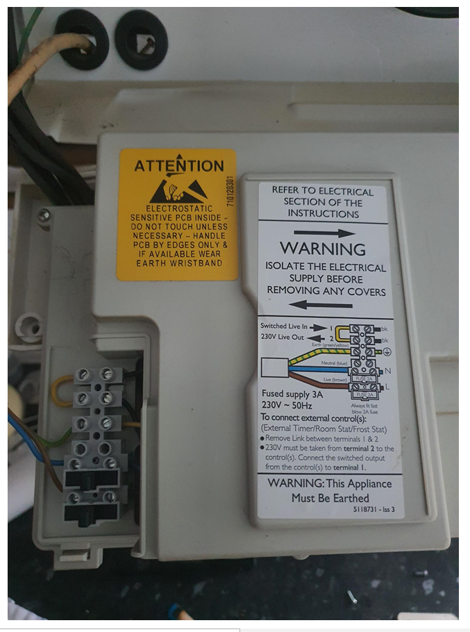

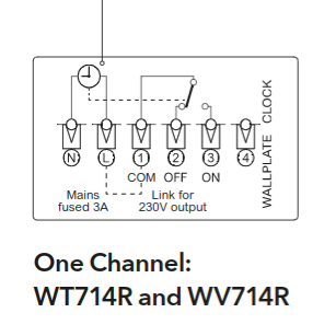

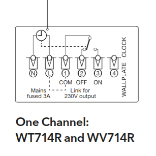

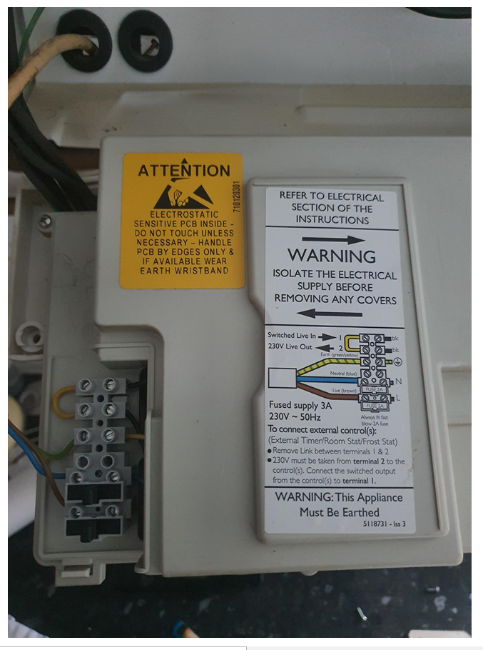

Hi All

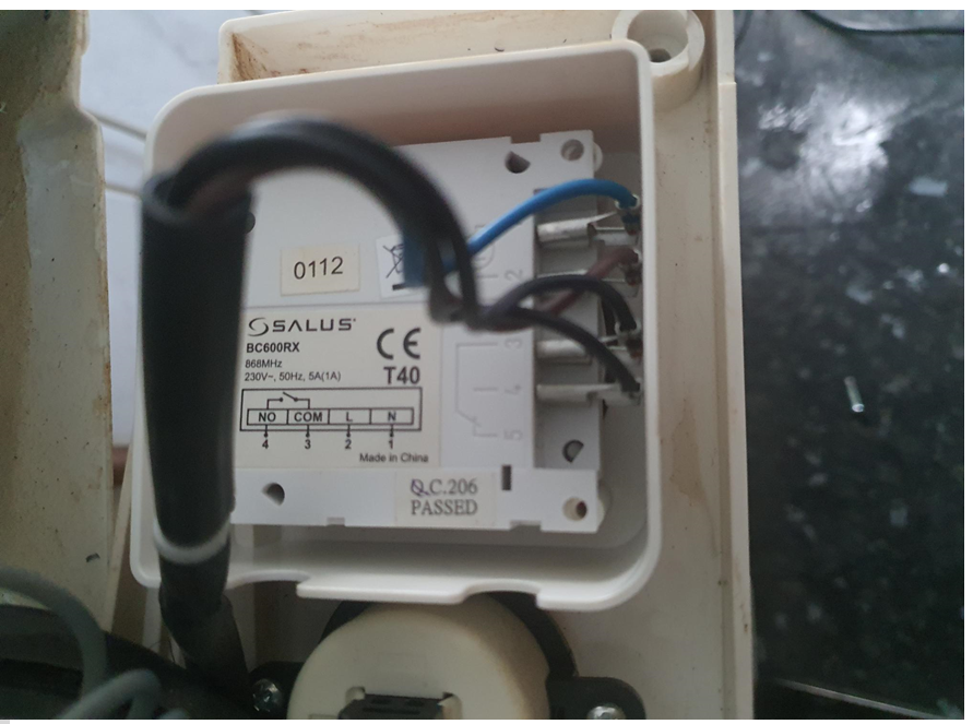

iv got a drayton wiser stat which I am going to connect to my main eco elite combi boiler over the coming weekend. i think i know how this is connected but want some advice.
am I correct in saying the below is what I will need to do
use a piece of 5 core cable
N from boiler to N on wall plate
2 (230v Live out) from boiler to COM on wall plate
Loop in COM & L on the wall plate
Switch Live in from boiler to 3 on wall plate.

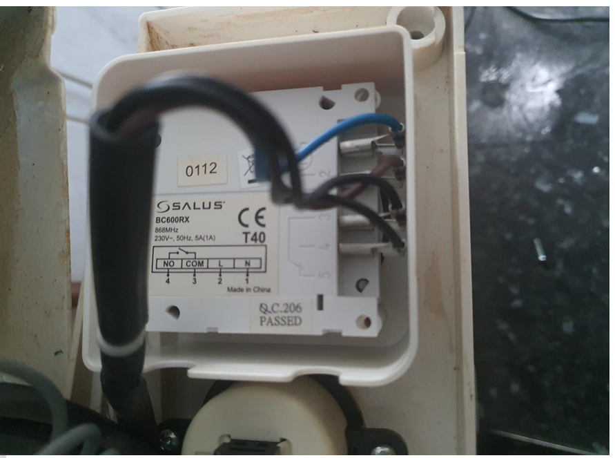

i also have a salus receiver RT500in place where the mechanical clock usually is, can i leave that as it is?
Thank you
Wiser diagram
Boiler
salus reciever
I would do the following (using your 5 core):
L from boiler to L on Wiser
N from boiler to N on Wiser
2 230v out to Com
No need to link L to Com
Disconnect Salus at both ends or link the switching wires together
