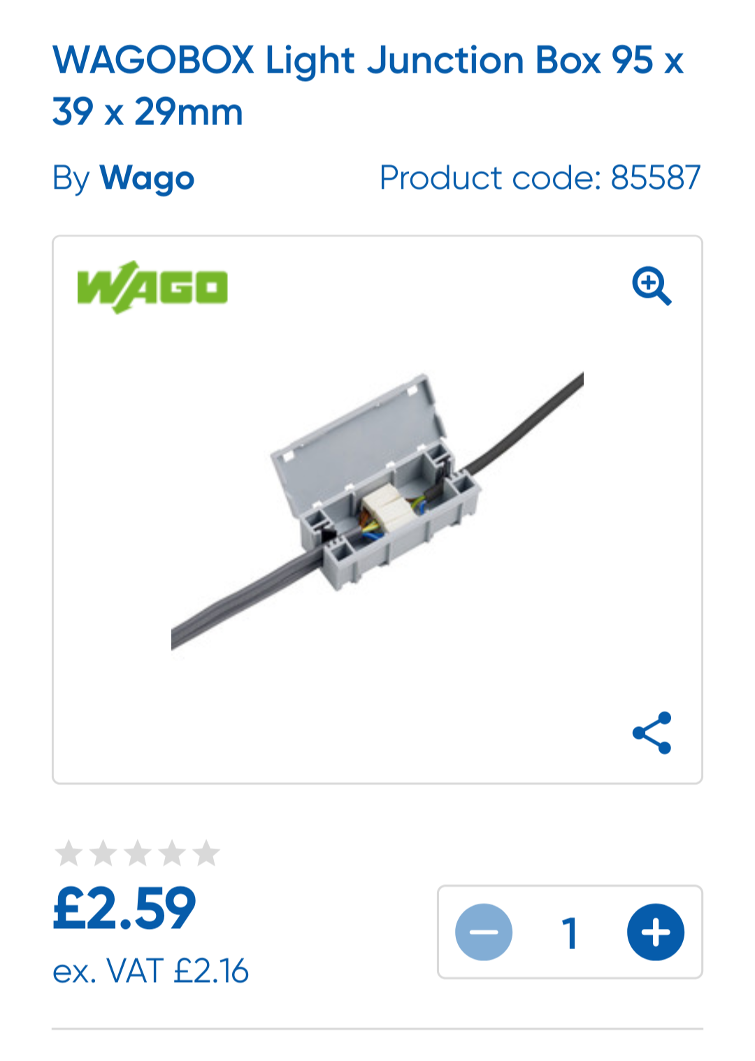

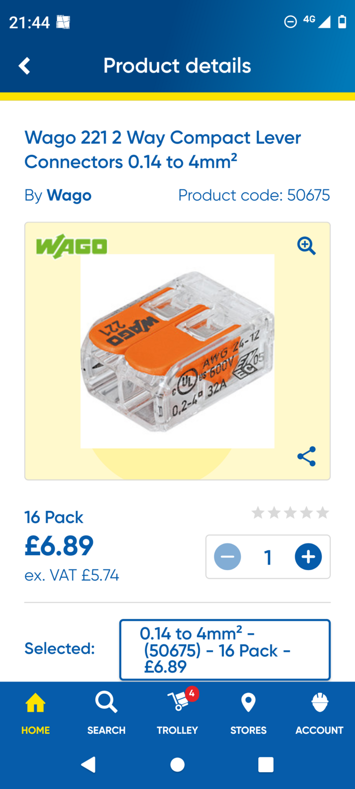

Hi, ok, got these wagos and box lined up to collect tomorrow en route. All ok?
NO.....for one that is a wago light box and is not maintenance free and two wago boxes cannot be buried in a wall
